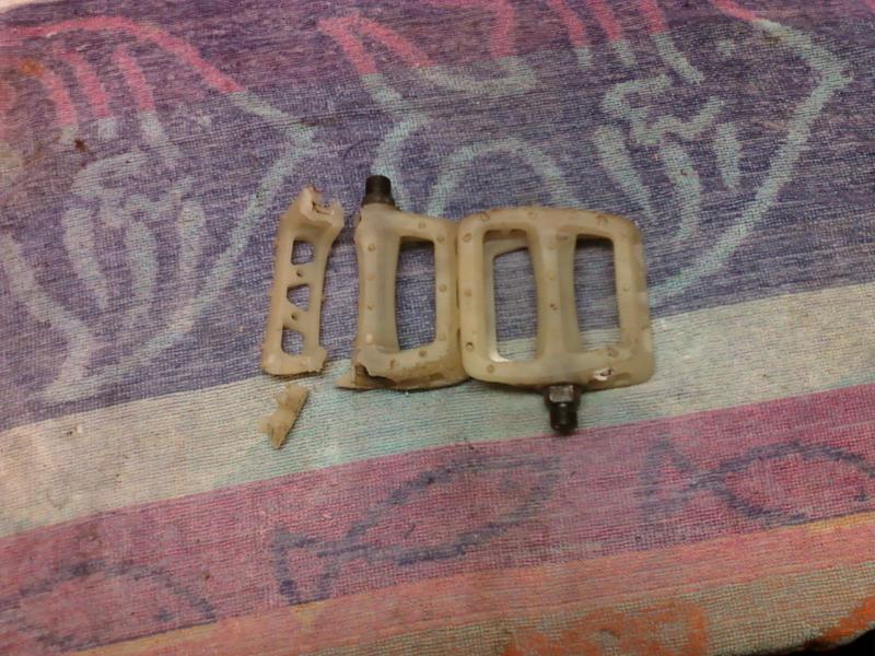

Broken twisted PCs a little over a year of use
