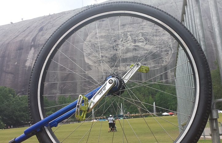

I visited Atlanta after the NAUCC 2013. Stone Mountain was a great place in the city for unicycling.

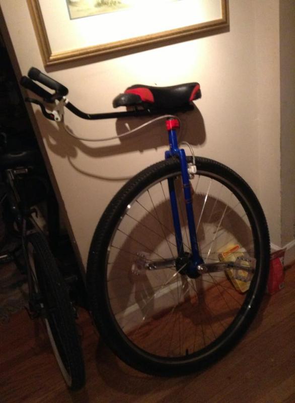

Hereâs mineâŚ

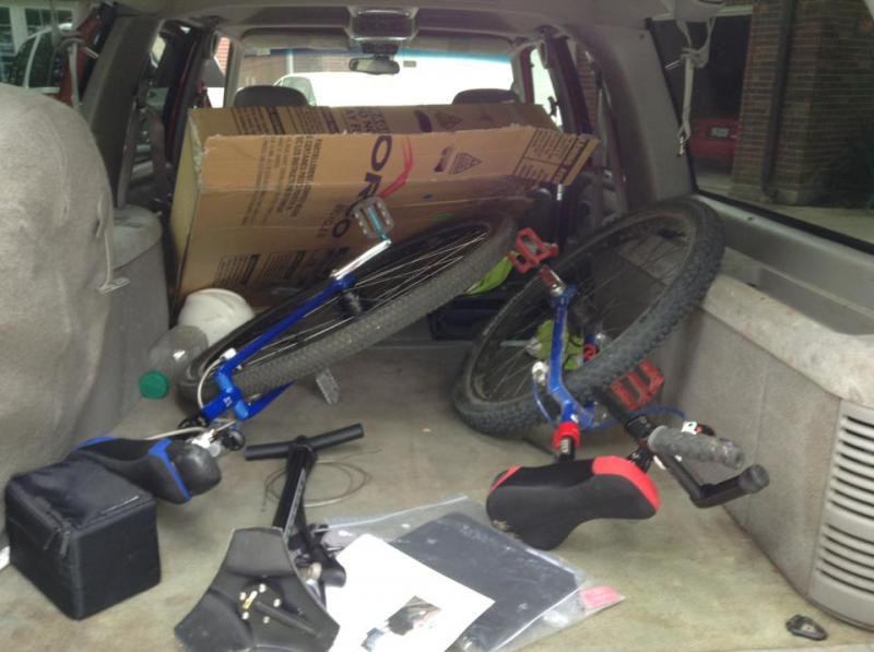

New Toy! Very challenging in high gear. First two are from out of the box then after a few modifications and one with its little brother.

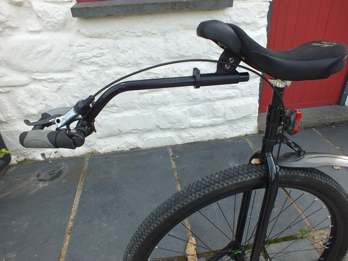

The coolest brake-hose run ever?

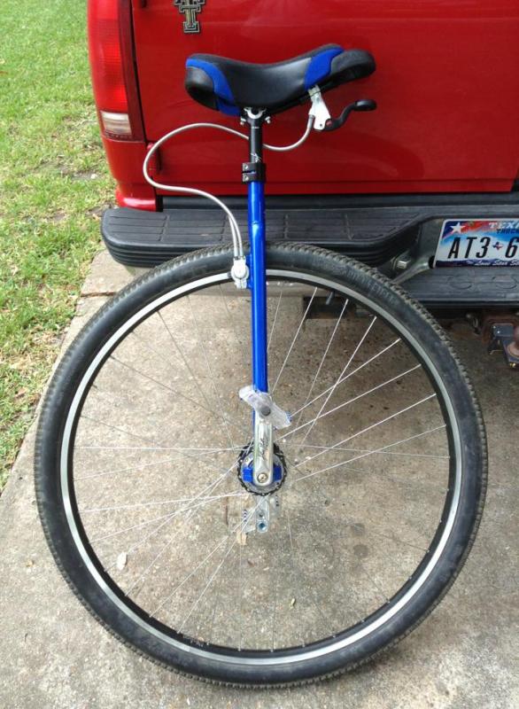

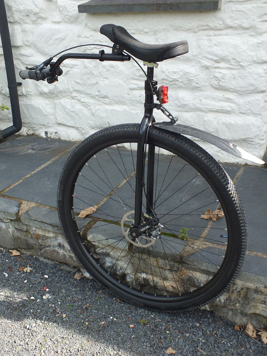

In the interests of information exchange, here is the latest incarnation of my road-going 36. Subtle adjustments with stock equipment - plus creative thinking - has the brake mounted âupside-downâ on the bars. I think this gives a really nice clean line to the run of the cable with a flowing curve from the lever to the caliper. Mind youâŚI canât operate the brake without a UPD
PS I know there arenât any pedals fitted

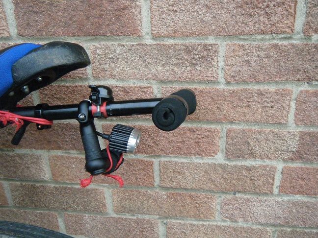

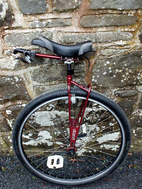

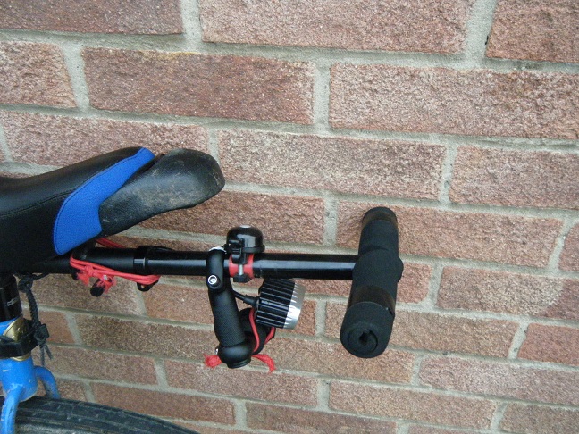

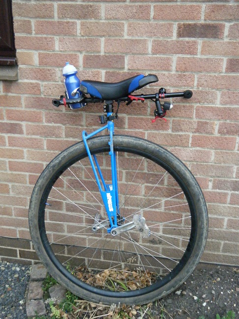

Here it is, rather modified since I last posted. Itâs a Nimbus 36 with a FOS tube and Kris Holm pedals. 150mm cranks. Nimbus Shadow handle set, heavily modified.
After much experimentation, I decided to go without the bar ends and use only the T handle.
The foam covering is designed for bicycle handlebars. I cut it about an inch (25mm) too long and stuffed the ends with tightly rolled offcuts of foam. This makes the handles long enough to use as straight bars (like âriding on the topsâ on drop handlebars) and the padding stops those nasty bruises to the thigh that a T handle can cause in a UPD.
With this handle configuration, there are several hand positions available depending on whether Iâm cruising, hurrying, or negotiating tricky stuff.

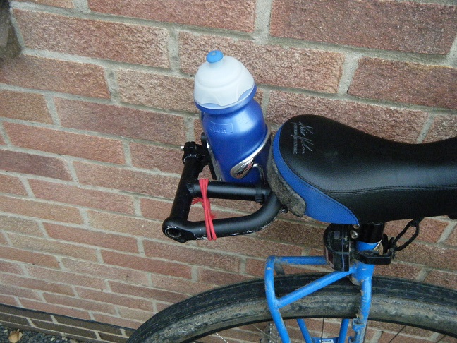

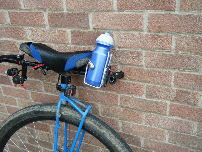

The bottle cage boss was ÂŁ2.99 (a negligible amount) and holds the bottle where I can reach it whilst riding.
The other half of the rear T handle is a makeshift rack made by adding a curved bar end. This is big enough for a waterproof, a light top, or to hold the battery pack for the headlight.

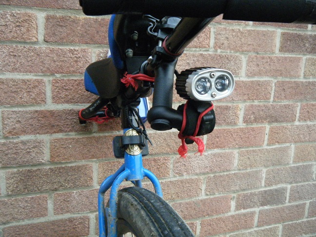

Best of all is the light bracket made of two short and cheap bar ends, one cut short. The light is protected in the event of a UPD and does not clutter the part of the bar that I need to hold onto.

Mike,
Does the water bottle get in the way when mounting? I usually ride with a camelback, but I would not mind loosing it and going to water bottles if they worked well.
Scott
No. I mount with my left foot on the bottom/back pedal and hop up with my right foot. This means that my left leg is already past the bottle before I make my move.
