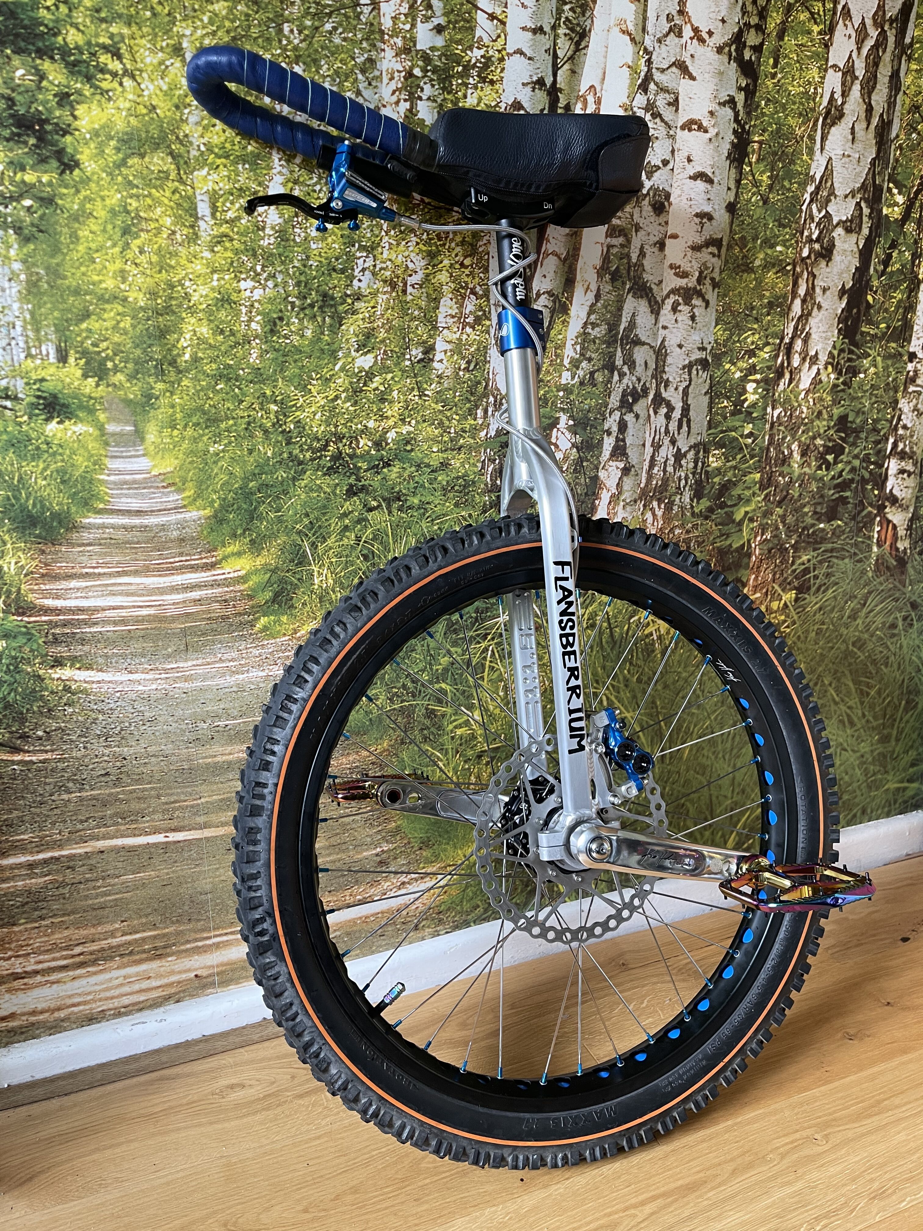

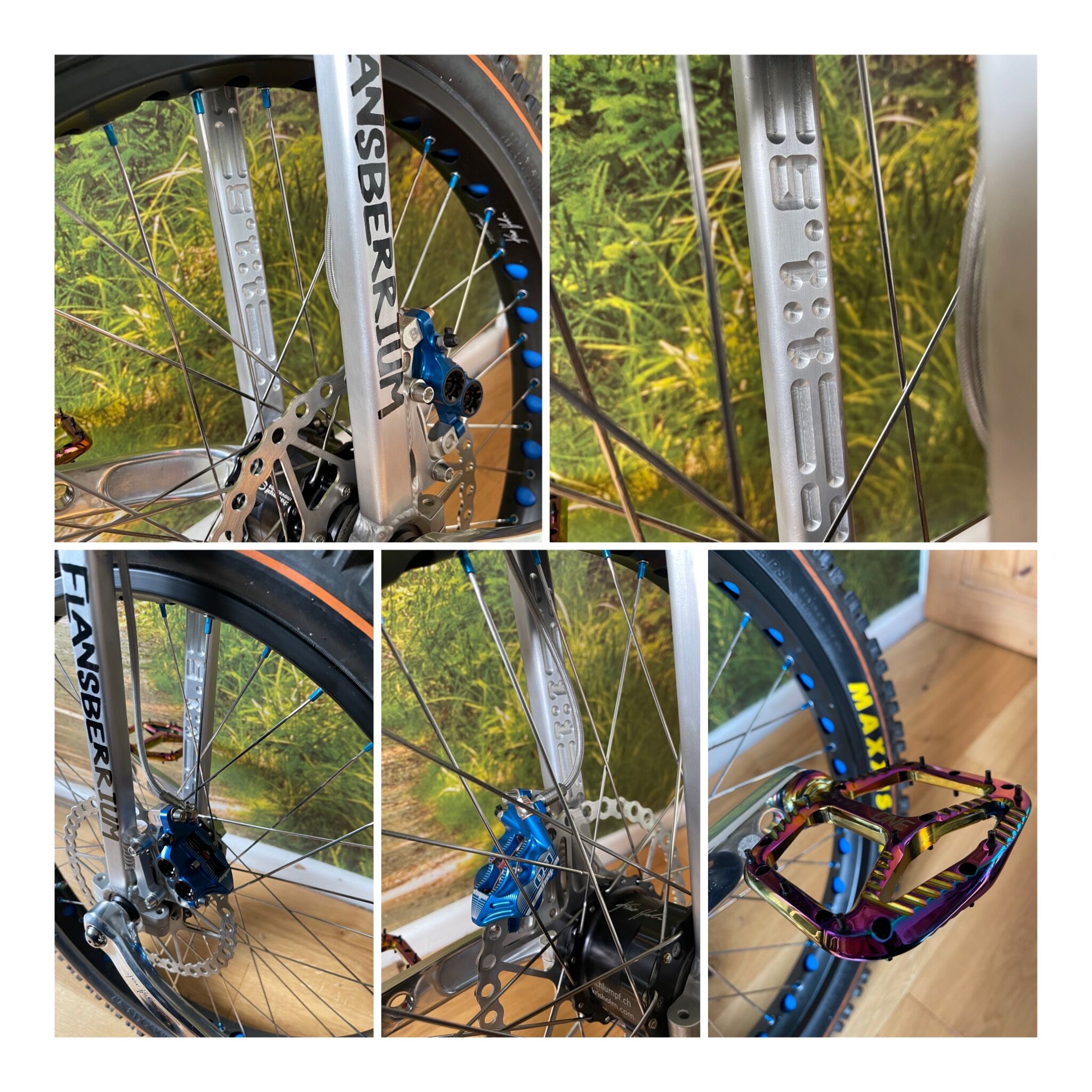

Flansberrium G24
  • Frame: Flansberrium 24” Aluminium - with custom “1:1” (L) and “1:1.5” (R) machine engravings on fork legs
  • Hub: Schlumpf 2022 Disc M1240 36h (Fixed Drive)
  • Rim: Kris Holm Freeride 47mm (oval cutouts) - Blue Strip
  • Spokes: Sapim CX Rays (Sliver)
  • Nipples: Sapim Alu (Blue)
  • Brake: Hope Tech3 E4 (Blue)
  • Brake Mount: Hope Silver B
  • Rotor: 203
  • Tyre: Maxxis High Roller 24x2.7”
  • Inner Tube: Standard 24x3”
  • Valve Cap: Oil-slick Hexagonal
  • Saddle: Mad4One HandleSaddle - Medium (Blue/Dark Blue)
  • Seatpost: Mad4One 27.4 (Black)
  • Clamp: Mad4One 3-Bolt (Blue)
  • Cranks: Kris Holm Spirits 127/150
  • Pedals: One-Up Aluminium Flat Pedals (Oil-slick)
Don’t want to swamp this place with photos but there are more on instagram “mindbalance.cc” :heart::gear:
I’m so amazed this has all finally come together and made for a stunning little geared 24” wheel.
Thanks of course goes to Florian and @jaco_flans for the core hardware - but also to all those that helped me resolve puzzlements over the (many) posts I’ve shared this last year :folded_hands:

Wow they are both so beautiful! They need to just go on display in a case and never be ridden! :sweat_smile:
Thanks!… Yeah - thats the aim here (not) - but they do certainly make nice decorations round the house when not being ridden.
I’ve sometimes been asked when pushing a unicycle around: “Can you ride that?” - and if I’ve been in impish mood I’ve said: “Nah, I just like pushing them around :wink:
Nice builds!
In both build lists, you specified everything but the crank length :stuck_out_tongue:
Thanks!!
Don’t know how I forgot that item. Fixed (both are KH 127/150s) :folded_hands::grinning_face:
They both look amazing and you must be well pleased with them. Ive not really followed this thread as schlumpf is not a target for me, Im guessing the build of these has taken a while?
Thanks so much. I’m still pinching myself that they’re actually here and in-spite of some issues getting them set up I am very pleased how they turned out.
Started picturing these back in January 2022 when we learned that new hubs were coming. So yes they’ve been a long time in the grand scheme of things. I’ve never planned a unicycle build or project that took 1+ year and this is my first time going full custom with frame and wheel builds and all the other aspects.
But now the riding and using them starts and the serious challenges of riding high geared wheels shifts into a new space.
I want my skills at riding to always be greater than my skills at buying/assembling wheels. I confess to enjoying the latter but it (I feel) should always help develop the former - and one ideally doesn’t built unicycles just for their own sake.

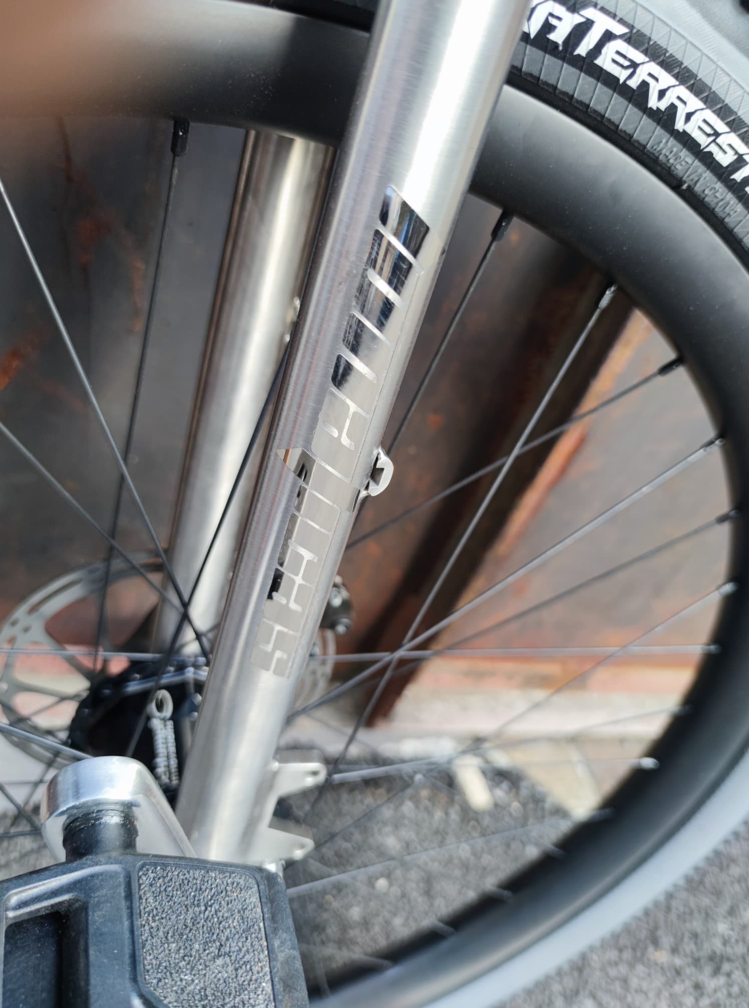

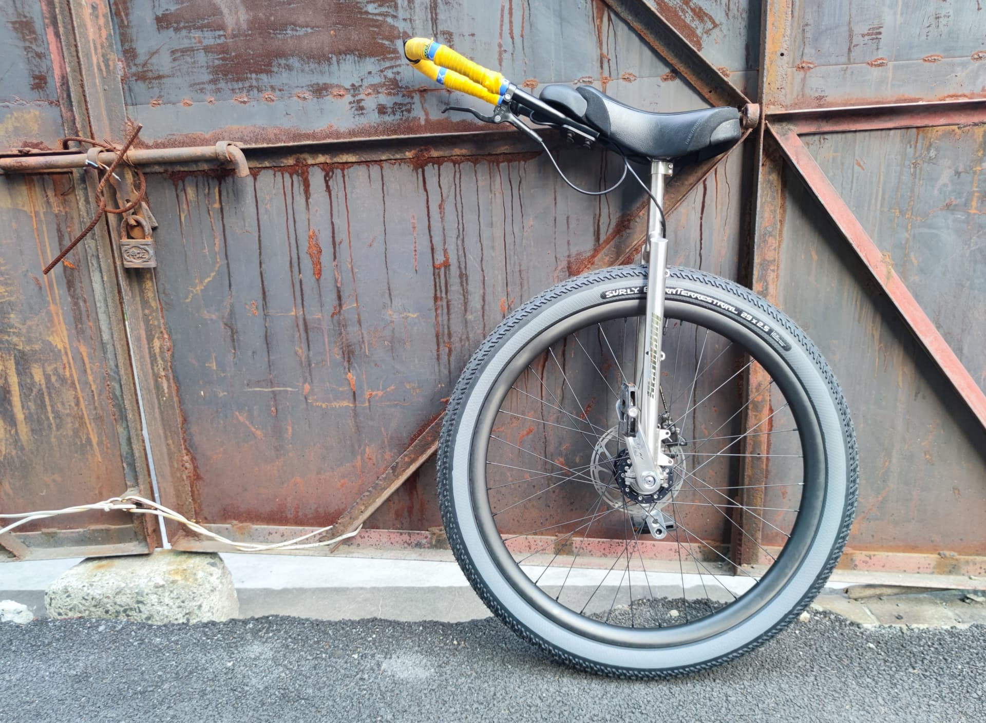

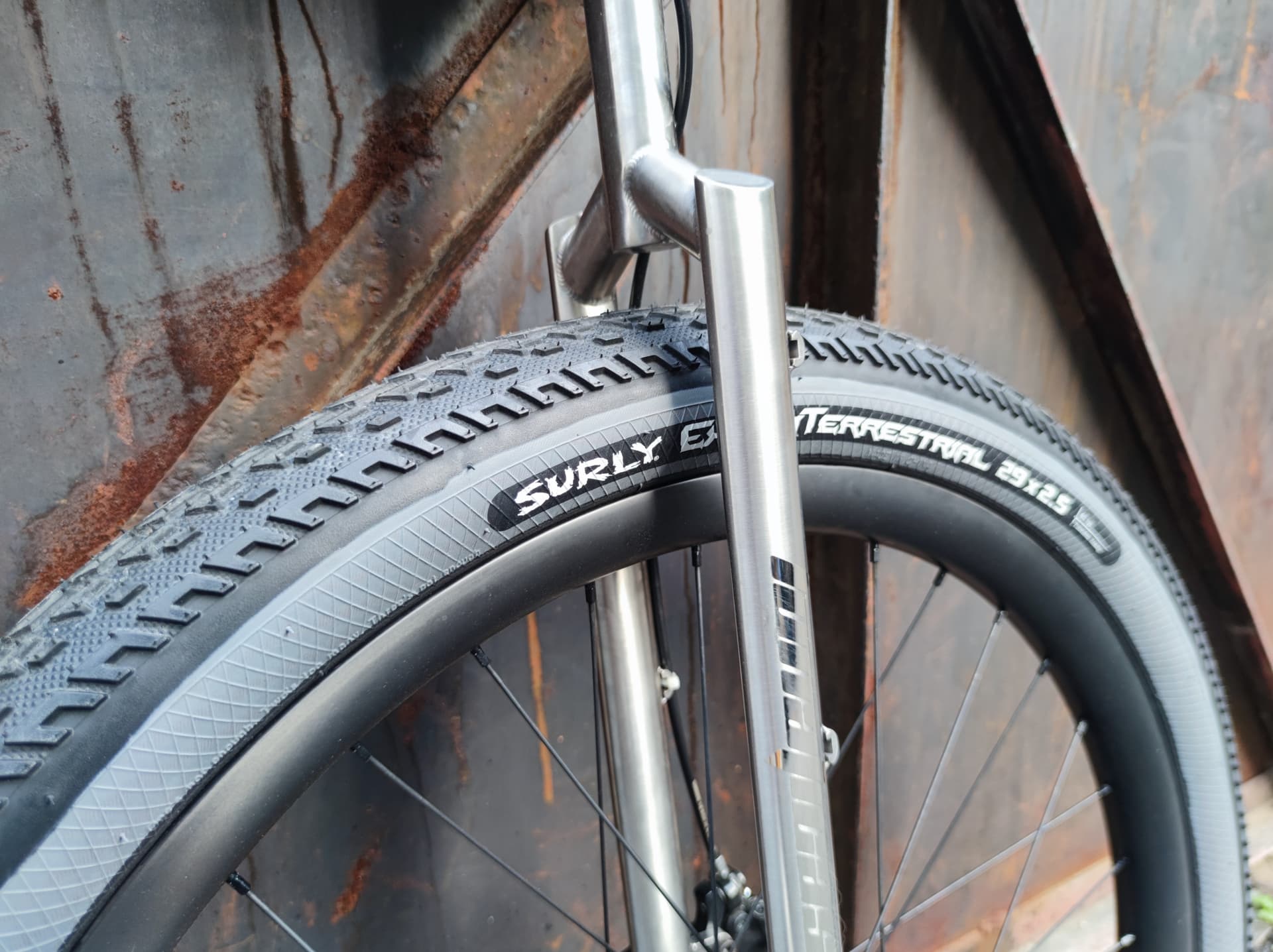

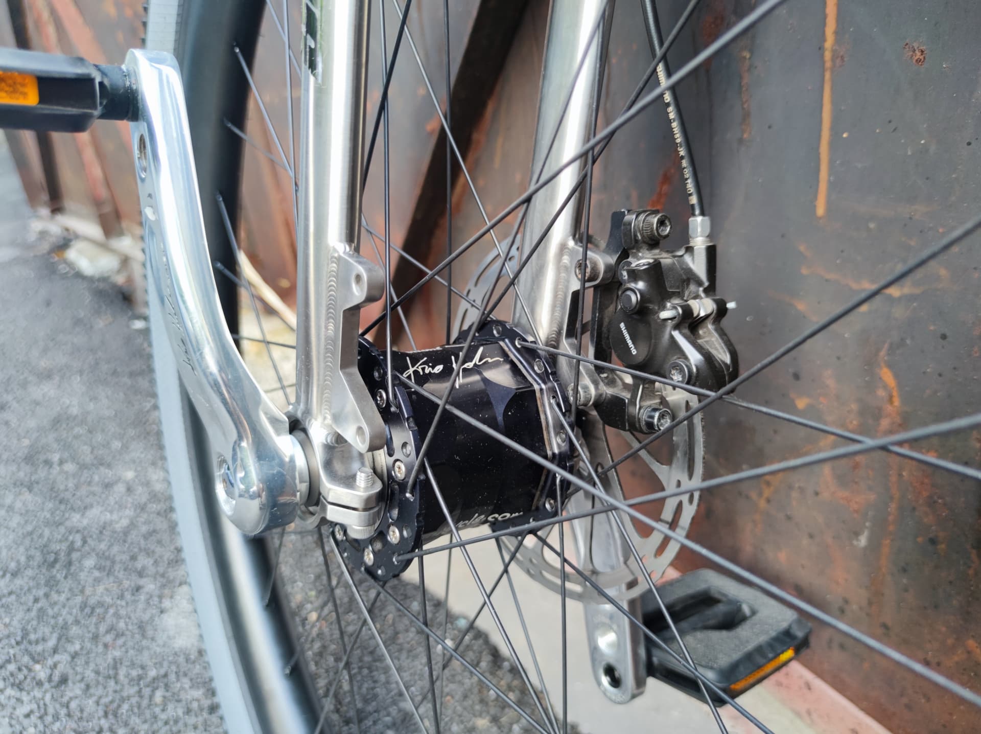

Here is my new take with the hub. Introducing lunaticas, a.k.a. the Ultimate Commuter, a custom built G29:
The frame says “lunaticas”, but I’m still experimenting with different designs and materials, so you may see it in different stickers.
  • Frame: Custom “Saturn” Titanium Frame, Seat Post and Clamp
  • Rim: Nextie NXT29XM41
  • Hub: KH Schlumpf Hub 2015
  • Tire: Surly ExtraTerrestrial 29 Slate-wall
  • Tube: RideNow 29’’ TPU
  • Spokes: Sapim Race, with Sapim aluminum self-locking nipples
  • Brake: Shimano BR-M446/447
  • Saddle: KH Fusion Freeride
  • Cranks: KH Spirit Double Hole 117/137mm
  • Pedals: Unbranded flat pedal
Great uni! But let me correct you on that point:
It isn’t the ultimate commuter as you have no inboard disc. You won’t be able to shift down while braking, which is a game changer for commuting IMHO.
One day it will. Ultimately.
That means I’ll have to learn downshifting first. Hmm.

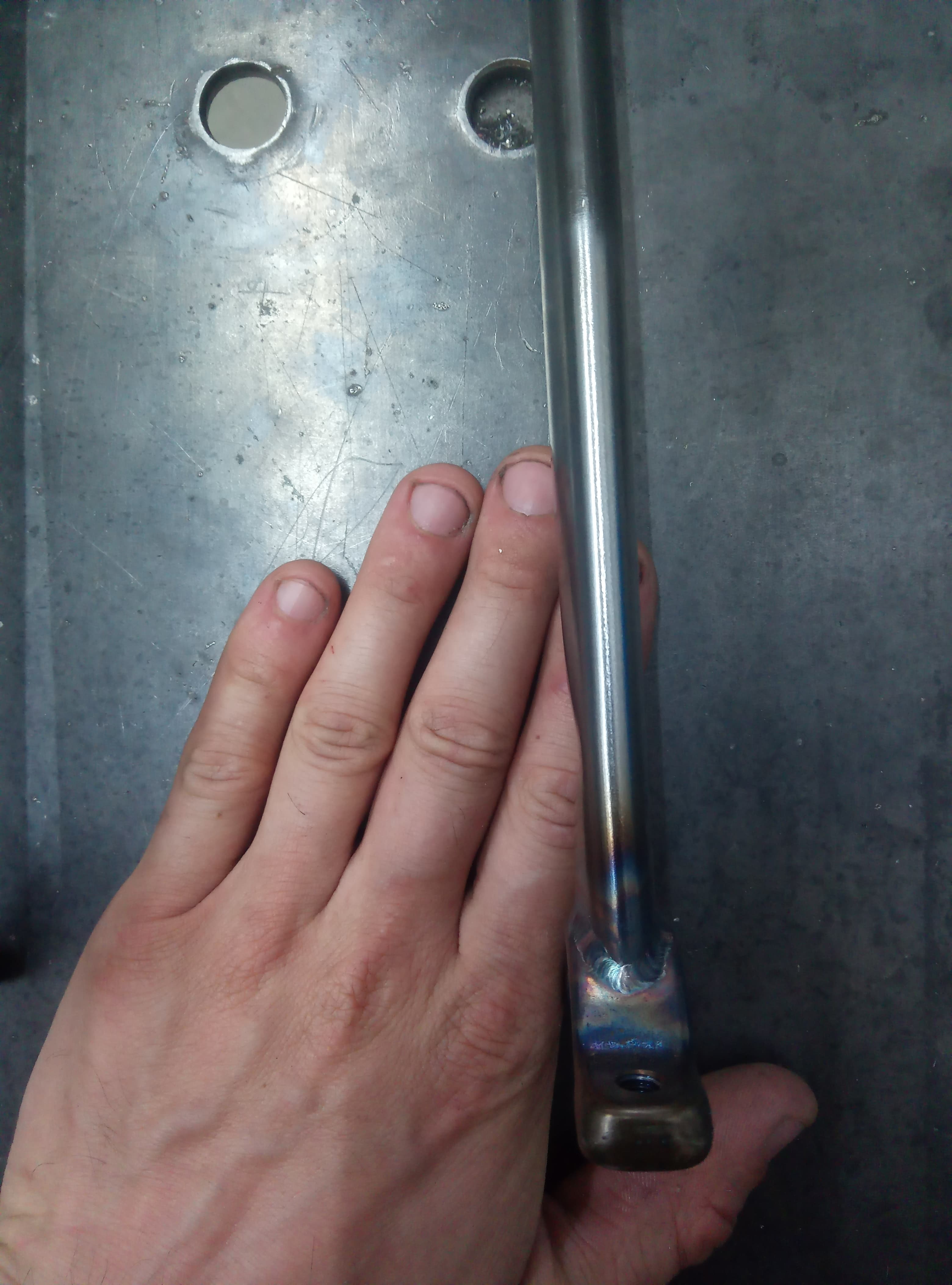

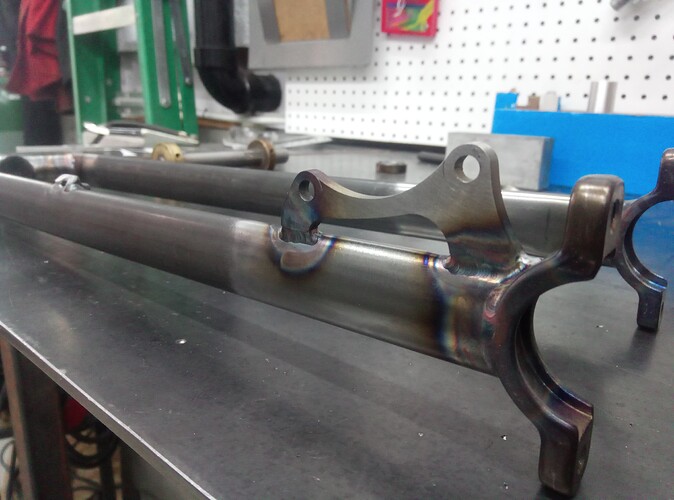

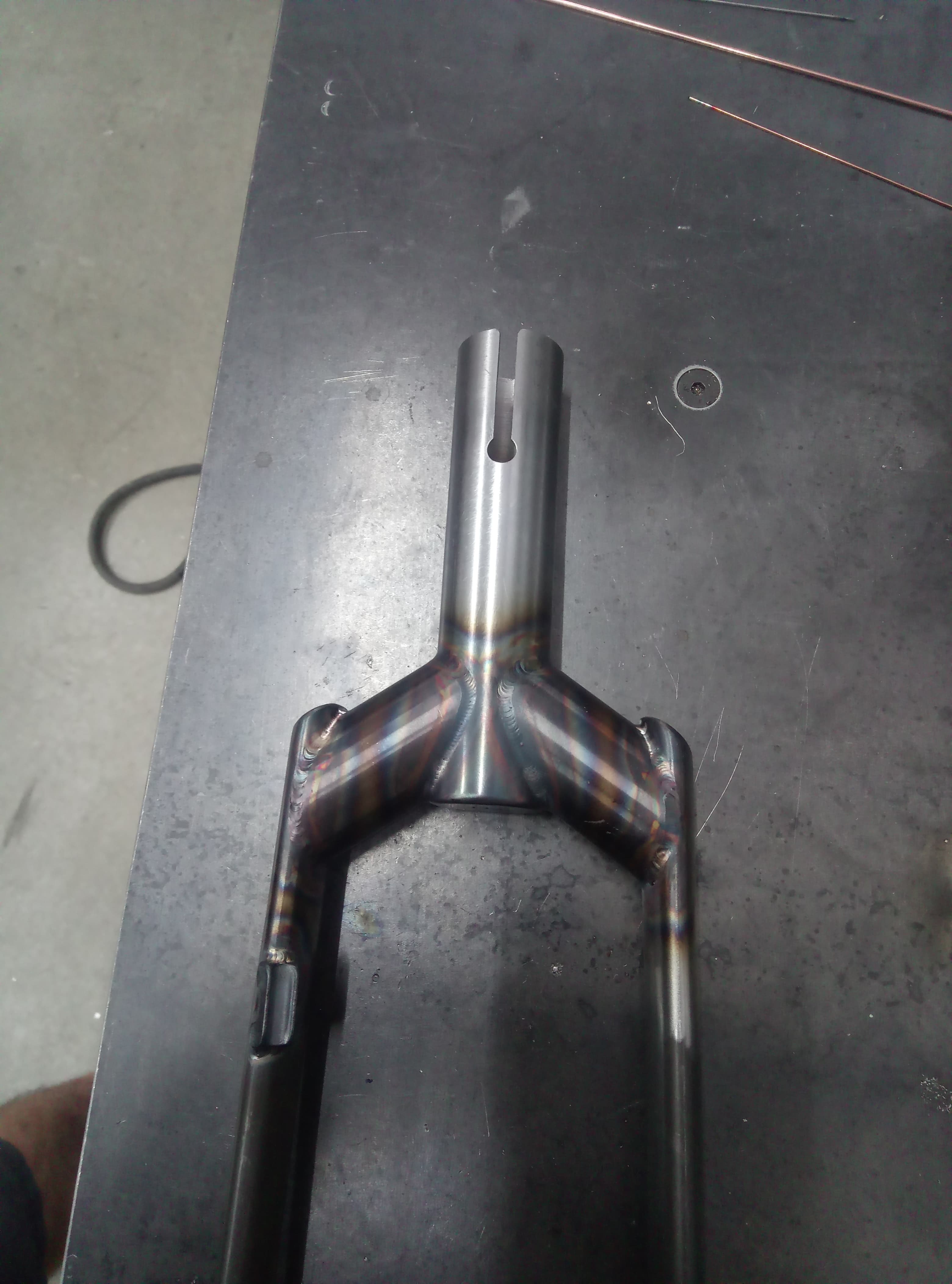

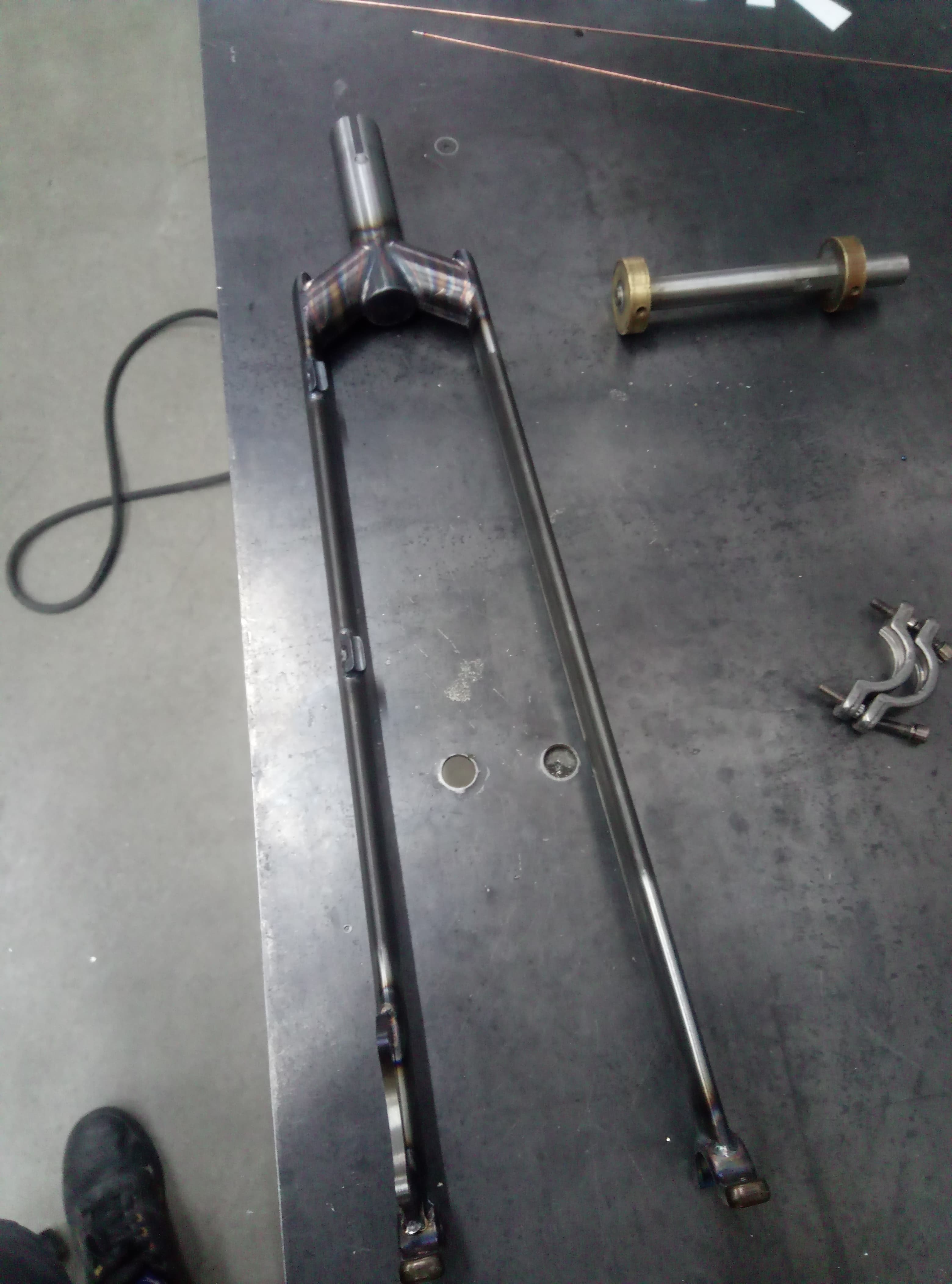

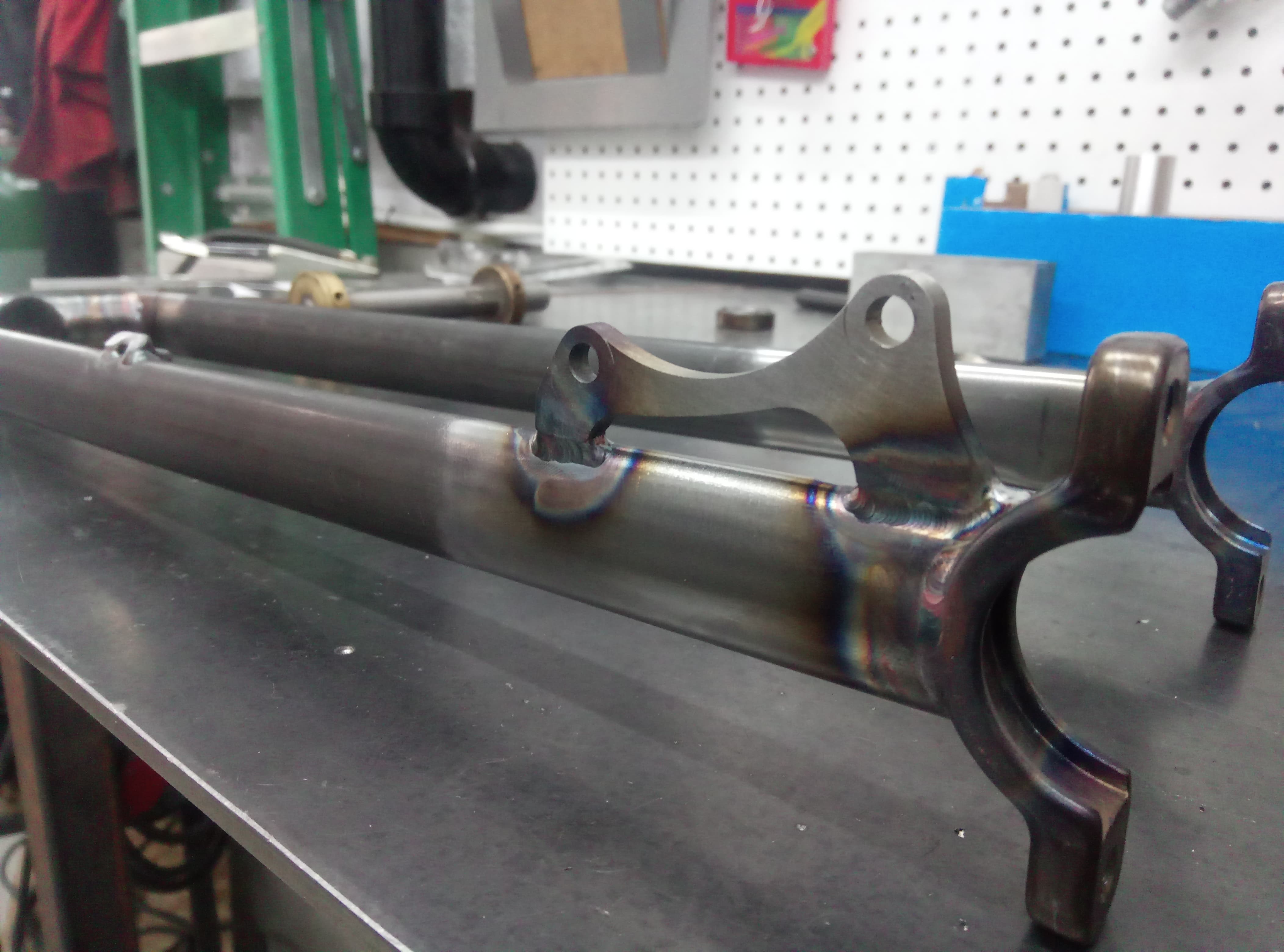

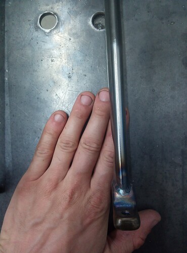

Progress on my G36 2022/23 Flansberrium-Schlumpf [125mm] unicycle.
Jakob has been amazing in communicating with me and custom building a Flansberrium frame for the 2022/23 Schlumpf 125mm hub.
Hoping to avoid any clash issues we waited for my Schlumpf to be delivered to verify dimensions before assembling/welding the frame.
“Since I didn’t want to have a huge crown, I used my dimple tool I use on bicycle chainstays to make the necessary clearance for the non-disk side.”
Cro-Moly Steel
