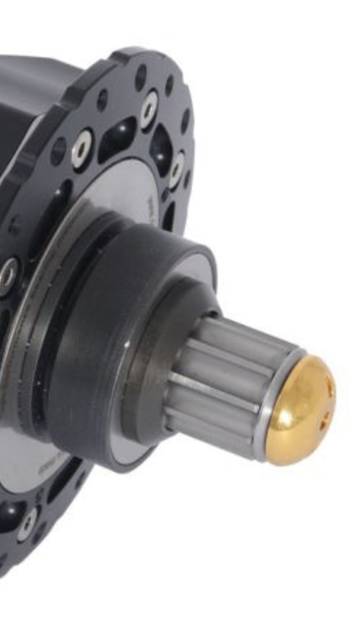

What generation is your hub? The crank-stop feature appeared on hub #800 and later.
Hope it helps. The stop looks like this - the little black spacer on the splined section:

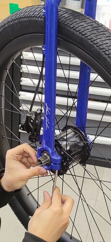

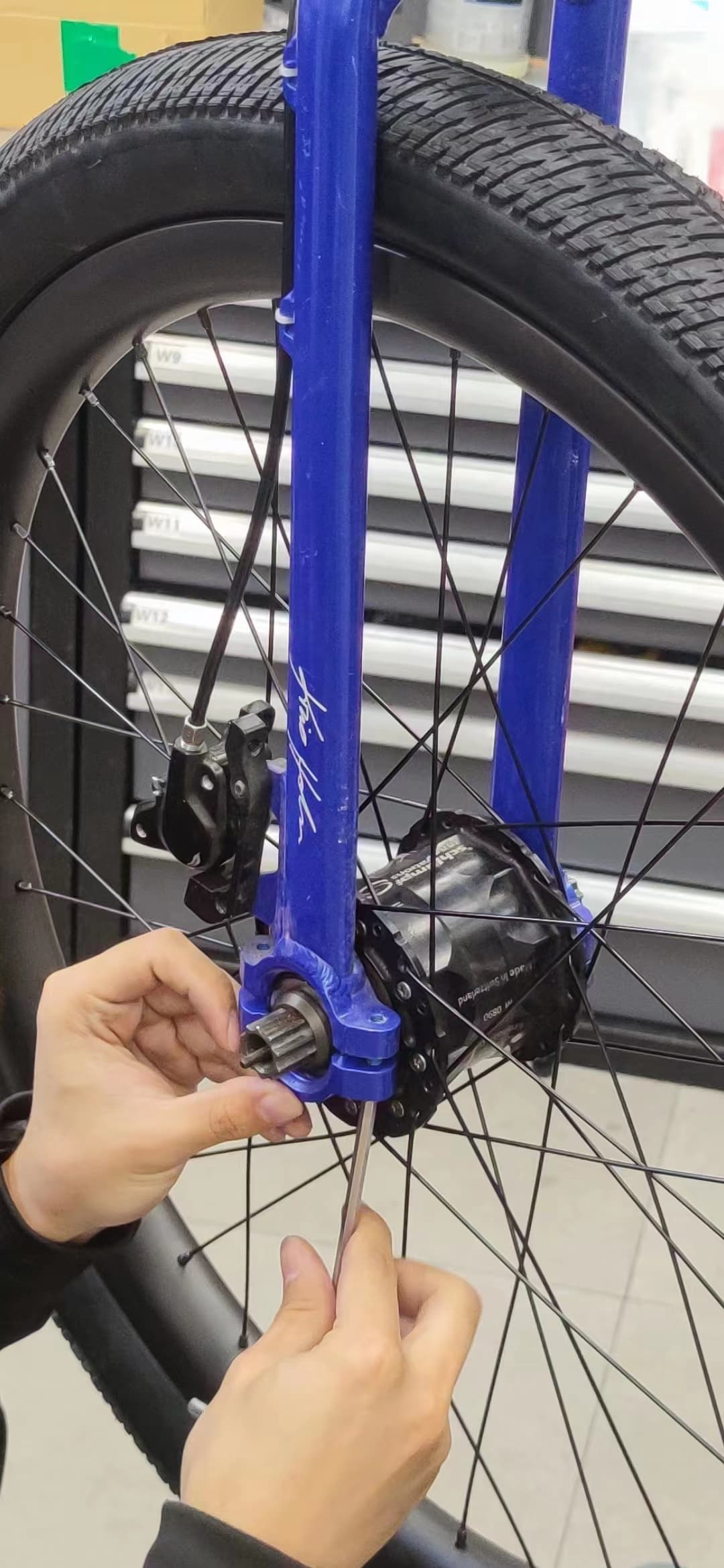

I found a photo, does this look like it has the crank stopper to you?
It does indeed look like it. Hooray :grinning_face_with_smiling_eyes:
Oh lucky me! :wink:
I second that. The crank stop is here!
