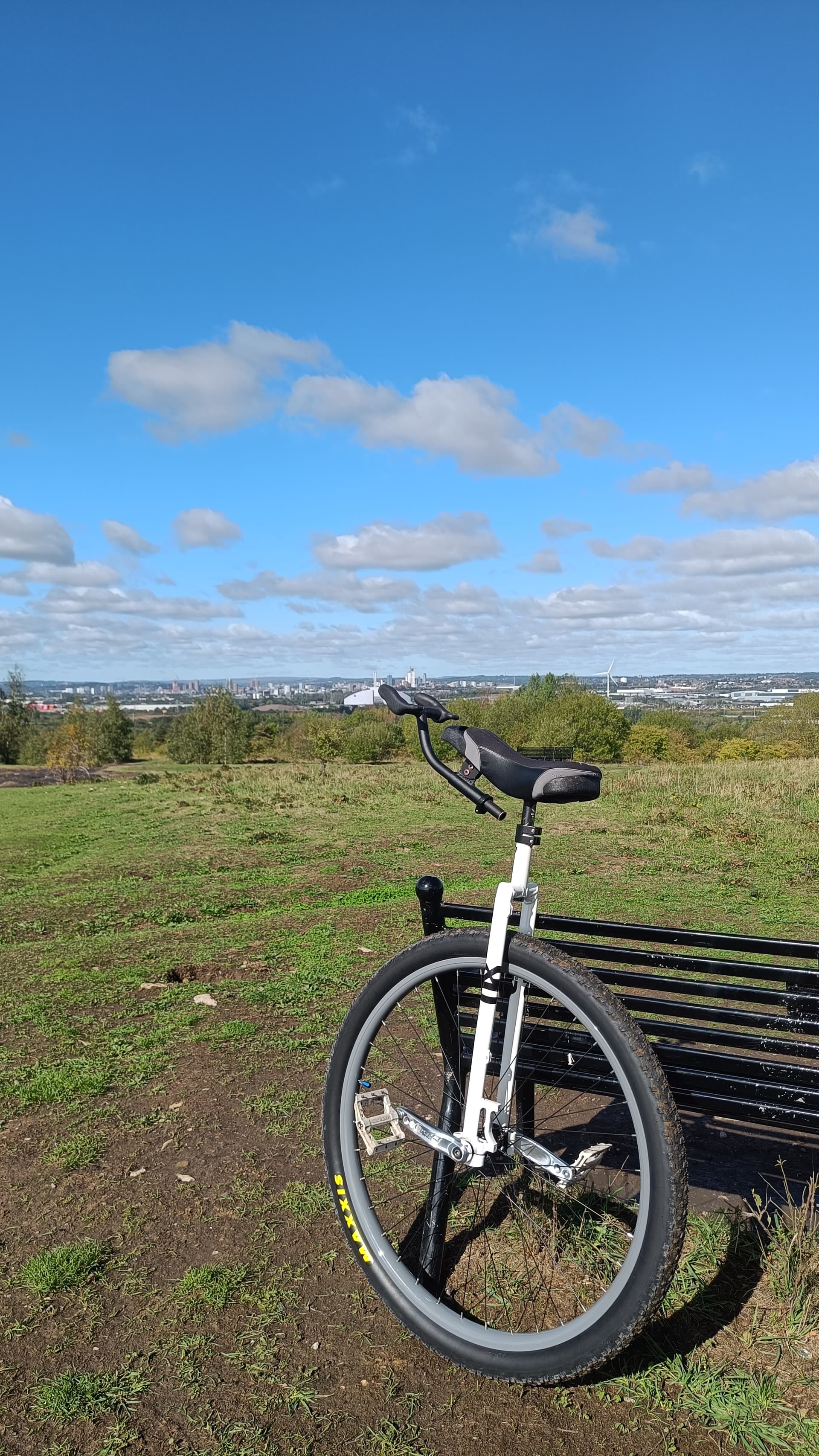

Today I slightly changed my setup on the 36er. Considering the last thread I started you might be able to guess the change. To test it thoroughly I added another hill to my regular ride. Luckily there’s water at the top. My knees might not appreciate the setup over time, though.
Out testing the new Maxxis Aspen 32x2.4 on a Frankenstein of parts.
Perfect conditions for it after heavy rain all of yesterday. It was just enough moisture to keep the loan grippy but not claggy.
It will be better this way.
looks like my setup with the KH seat and handle bars. though my 32” is a Nimbus and no doubt I ride with longer cranks. Nice tire.
I had a section where I could take a few offroad kilometres, but chickened out and took a longer route on asphalt instead.
137s on this which feels about right for not having a brake. They feel loooong on flat road, but pretty acceptable on everything else and it does climb well.
I don’t know what I’d call this. Only the frame is Qu-Ax and none of it came as a complete unicycle.
Frame - Qu-Ax alloy 36” (pre-RGB)
Seat post clamp, seat, bars, hub, cranks - KH
Seat post, rim - Nimbus
Then some Nukeproof Electron Evo pedals (not as good as the early Nukeproof Electrons), Foss 32” tube, and the Maxxis Aspen tyre.
I suspect with this tyre you might start choosing the off-road bits. It’s really nice! Although if you ride mostly on-road it’s relatively soft so I don’t know how long it’ll survive before it loses all of its centre tread.
