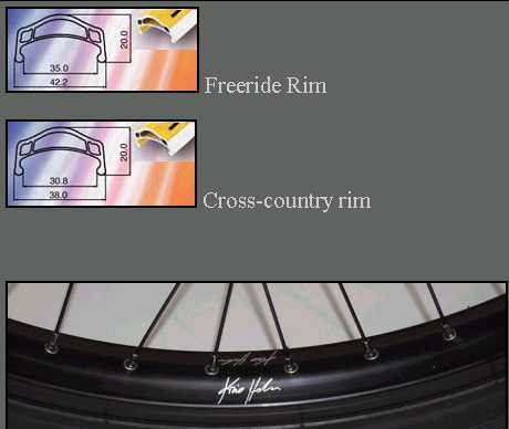

No need to complain- the inner width is shown in the inset picture- 35mm for the freeride rim and 30.8mm for the cross country rim.
Ah!, I completely missed that info on the web page. Either that, or I read it and promptly forgot.
That 700c rim is cool. I think it may be the widest 700c rim available.
I hope the rims will be available separately. I may be replacing the old Avro Zum rim on my KH Pro muni. It’s bent and warped enough that I can’t use a brake with it any more. I’d prefer to replace it with the new KH Freeride rim.

We’ll have to see how the rims do with a brake. Kris was using what I believe was this rim at the California Muni Weekend and I didn’t notice brake squeak.
wasnt wet there was it? :roll_eyes: still i’ll take a taiwan rim with machined walls over a taiwan rim without any day. plus those rims wont be for sale alone for a very long time anyway.
The rims are hard anodised not powder coated. They should not squeek with the right blocks on them, I think it is the black Magura blocks you need…
The rims are available for sale at Unicycle.com. We also have the Nimbus 29" rim which is I think actually wider (only slightly); but it is only single skin. Although if you look for them on the site, they are not there yet. We have not been able to get the up yet. Hope to have them there for the end of the week.
