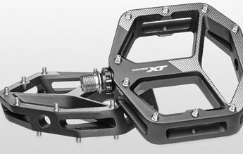

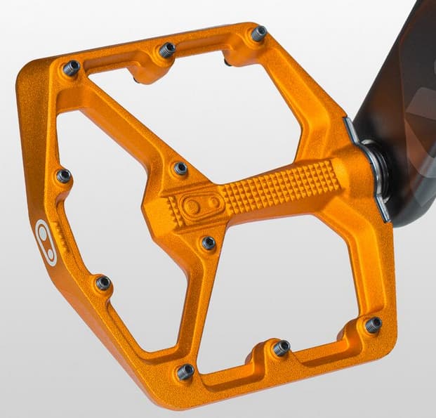

Most MTB pedals come with threaded pins, like Crankbros and Shimano (below).
I own similar pedals for MTB, but when I go muniing on these threaded ones, they chew up my 5.10’s quite quickly. I suspect it’s because I put a lot more sideways force when muniing compared to mtbiking, and the threads also catch on the shoe when I’m adjusting my foot position right after I mount.

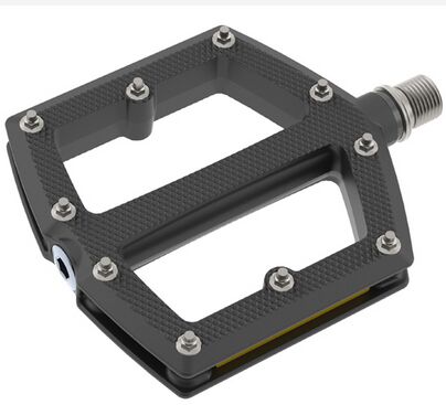

I wonder if threaded ones are better for the mtb market (for whatever reason…), and smooth pins are better for muni? There are plenty of pedals with smooth pins, but the majority aren’t big brands. For example, URC only stock pedals with smooth pins, like the “Pedals Push” (pictured), and I quite like the smooth pinned pedals that come with UDC unis.

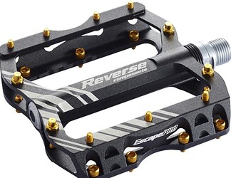

So far I’m quite happy with my Reverse (Components) Escape pedals wirh smooth pins.
I mostly use them for trial, but I would definitely use them for muni as well.
Using them every day still causes deep holes in my soles after only 2 months of use :frowning_face:

Smooth pins that screw up from underneath tend to be narrower (the smooth part has to fit through the threader part), but smooth pins that screw in from the top tend to be wider. My old Addict pedals that I use for muni had a mix of both types - I swapped out the narrow pins for wider set screws. The Reverse Escape pedals that @mark.vogels mentions are like that, too. I expect it’s the narrow from-the-bottom pins that are eating his shoes…

But seeing @mark.vogels’s reverse pedal makes me wonder why they’d use a mix of threaded and smooth pins? Especially if it’s true that the smoothness/thread makes little difference. Why not make them all threaded pins or all smooth pins?
Looks like it’s more a matter of how they are installed. The thread has no other function than to screw the pin in.

Maybe they’ve done an update, but mine are all smooth. And the 4 pins on rhe edges are still different (also in color). I actually took out the 6 normal pins on one side, but left the 4 outer pins to assist in pedal grabs.
