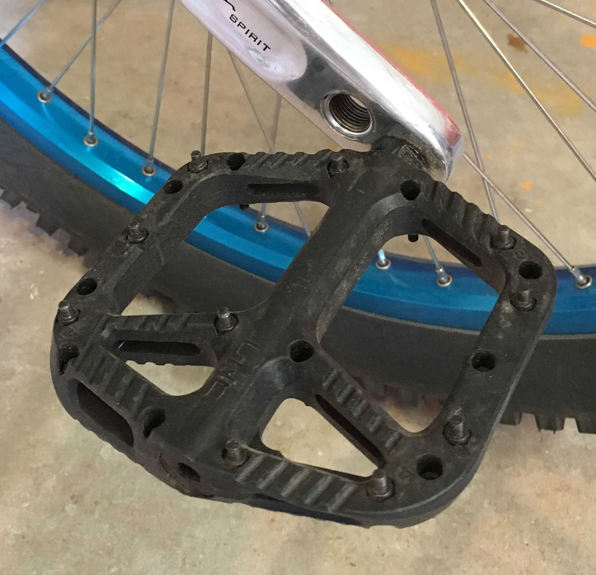

I’ve been experimenting with a couple of new pedals lately. I had some cheap pedals on my muni which had developed lots of play. They were completely unserviceable (bodies riveted onto the axles) so they needed replacing.
I picked up some OneUp Composite pedals to replace them.
Pros:
  • Easily serviceable.
  • Nice wide platform.
  • Plastic bodies mean they’re light and tough.
  • Grippy enough for muni and me.
  • They look good (ie subtle).
Cons:
  • Convex shape. I find this ok for muni but annoying in other situations (see below).
I tried the OneUp pedals on my 36er as well, expecting to like them enough to ditch the stock Nimbus (AKA Wellgo B108) which I’ve been running for the last couple of years. I don’t mind the Nimbus pedals, but I would find that my feet would slowly migrate around over the course of a multi-hour ride. Also, although they allow easy servicing by using loose ball bearing, they then shoot themselves in the foot by having a plastic dustcap which needs to be pried out with a knife to actually access said bearings. Finally, I wanted to see if a slightly wider platform would help with comfort over longer rides.
Anyway, the OneUp pedals were a no-go on my 36 due to the convex shape. I just wasn’t confident that my feet weren’t moving around without frequently looking down to check.

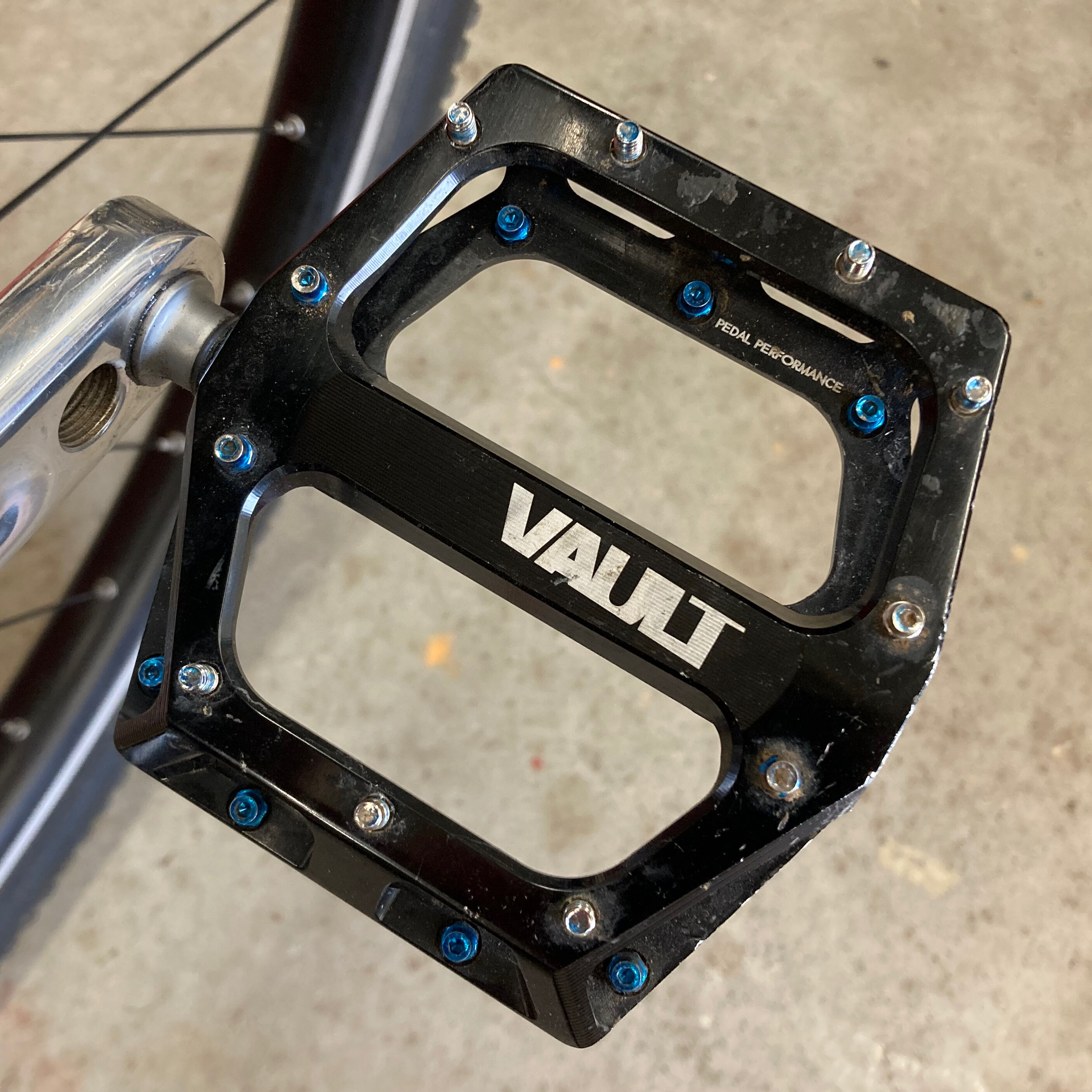

So I ponied up and picked up a pair of DMR Vaults for my 36er. They felt like a bit of an expensive gamble but it turns out they actually ride quite nicely.
Pros:
  • Very comfortable and grippy (concave shape).
  • Easily adjustable pins, although after experimenting I ended up just going with the stock setup anyway.
Cons:
  • Expensive.
  • Ugly and blingy. Great if you’re into that but it’s not really for me.
  • No wrench flats. This is really annoying because the only reason I can think they omitted them was for visual style. I much prefer using a pedal wrench to an allen key for attaching and removing pedals.
  • Metal bodies aren’t as tough as plastic. I rarely drop my 36er though so I’m not too worried.
  • Heavier than plastic if you care about such things, which I don’t.
Although I’m being quite harsh on the Vaults, they would be my pick if I had to chose one since they just ride so nicely. That said, I do wish there was a concave version of the OneUps available (or a version of the Vaults which was plastic, less blingy, cheaper and with wrench flats ;)).

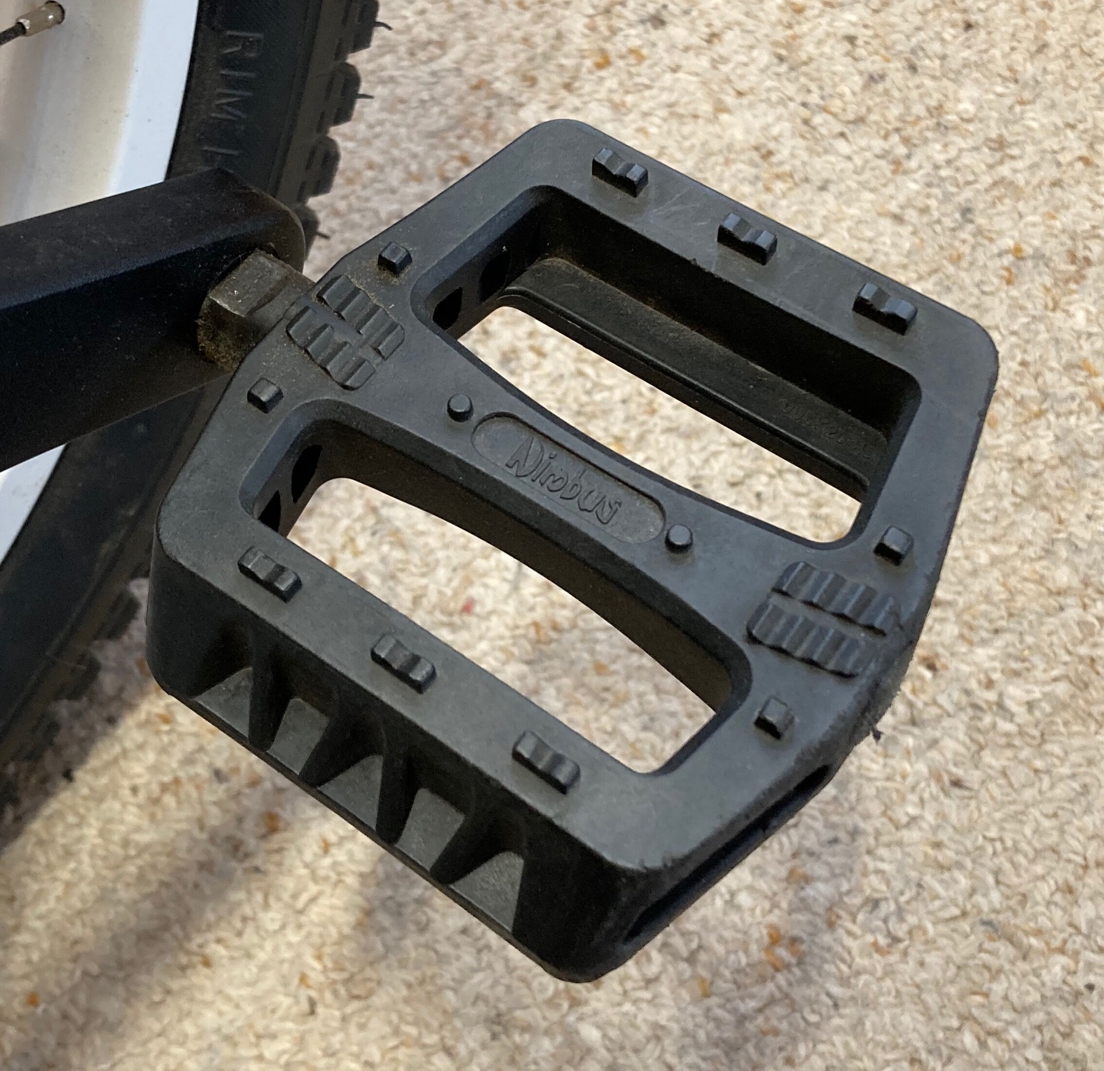

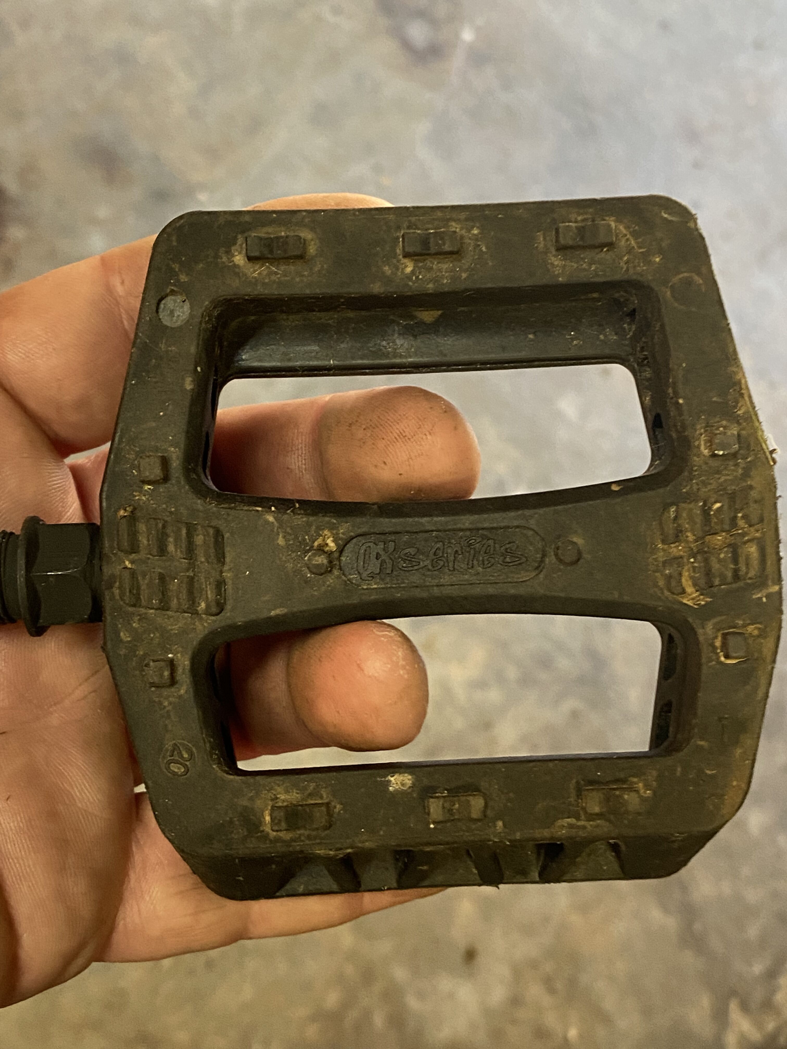

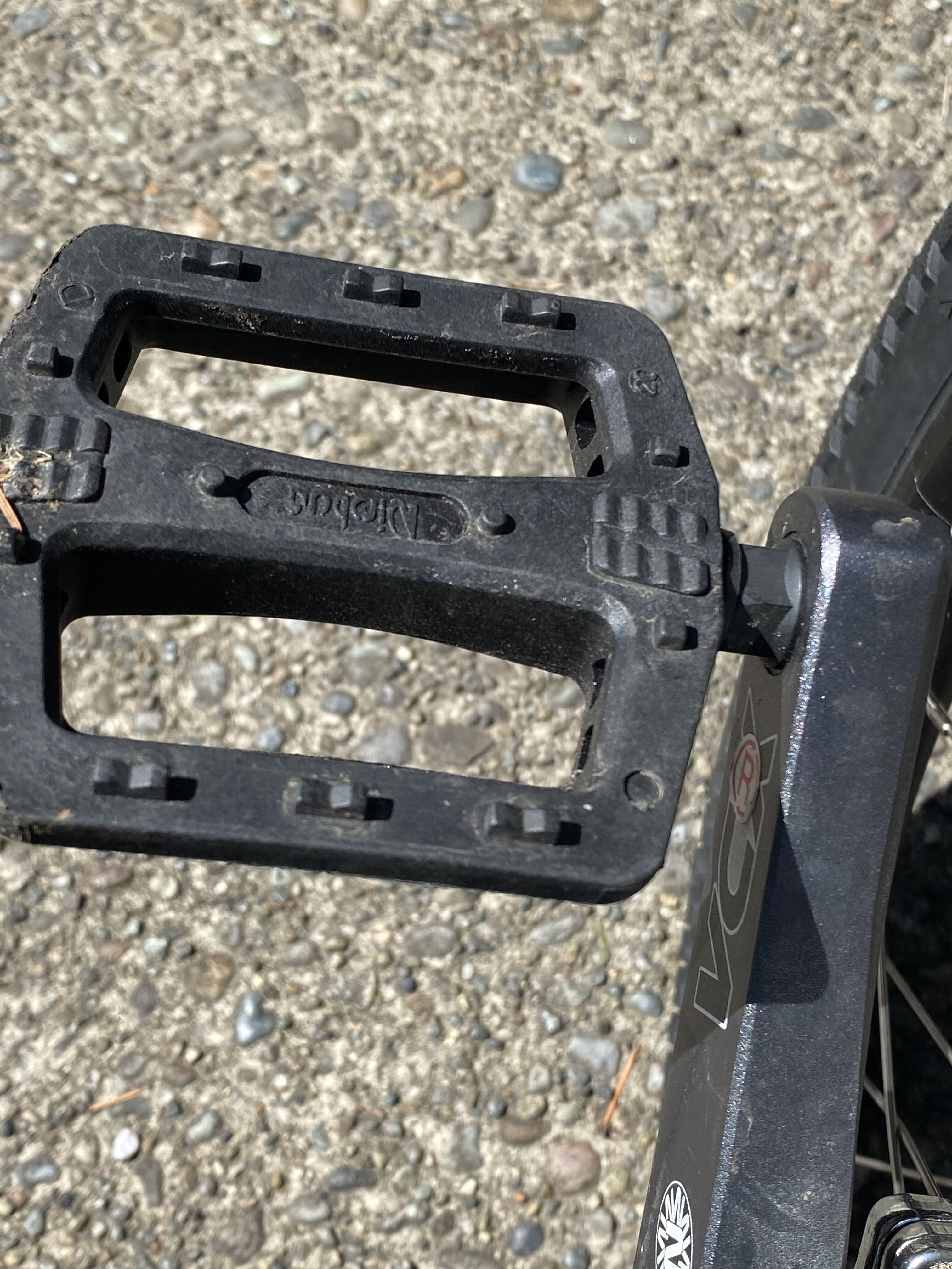

Standard Nimbus plastic pedals
Basic plastic pedals without pins. Made by Wellgo, also available from Qu-Ax and Impact.
Nothing fancy but I like them. I use these on my trials uni, which I use for learning new skills. I wouldn’t use them for riding any great distance.

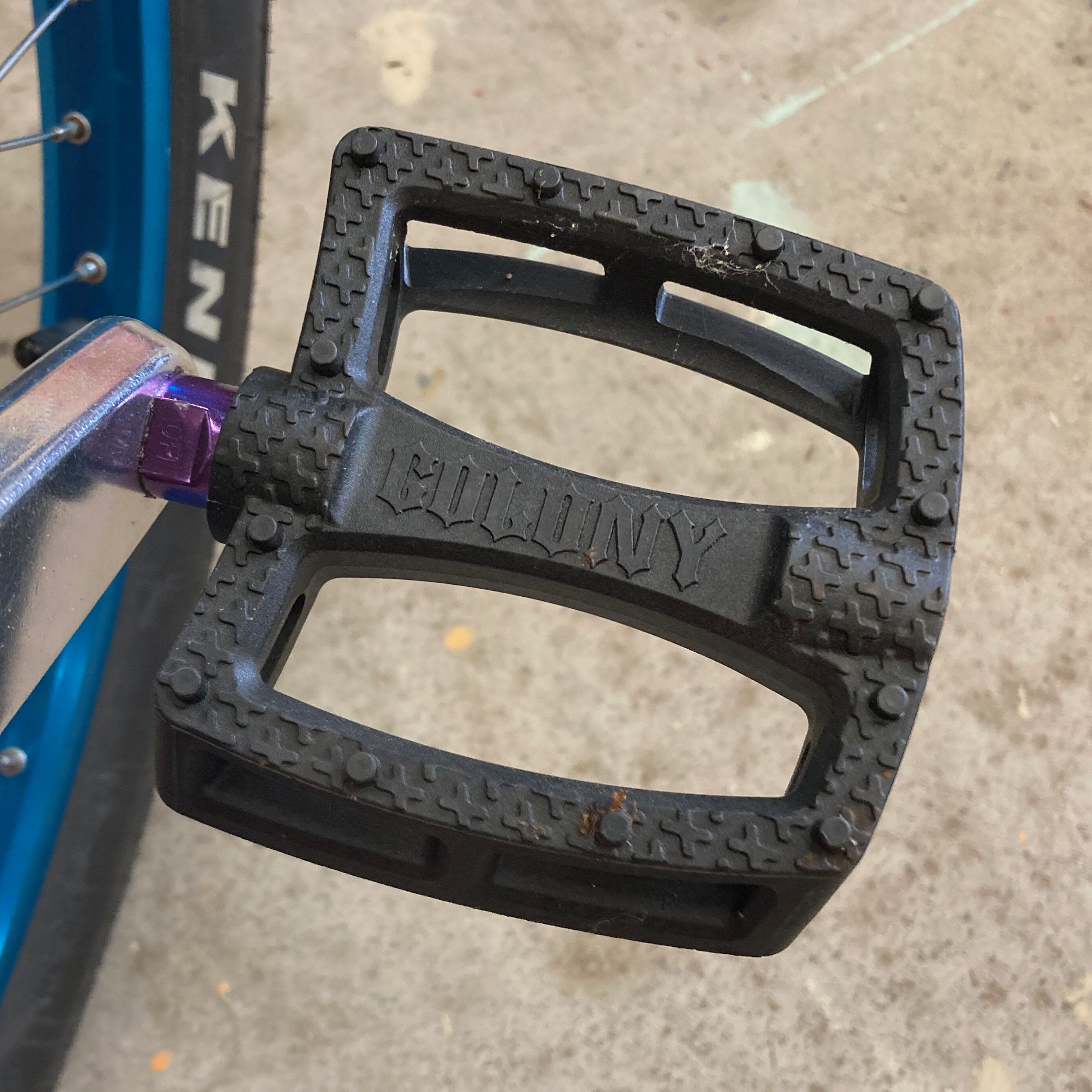

Colony BMX pedals
I bought to go on my 26" general purpose uni. I chose them because they were cheap and had purple axles. Turns out they’re terrible pedals.
They have plastic pins, but also a large axle bulge which means you can’t really engage with said pins. As a consequence they’re always slippery. Doubly so when wet.
As well as being slippery their small size and axle bulge also makes them uncomfortable. I retired them after a few rides.

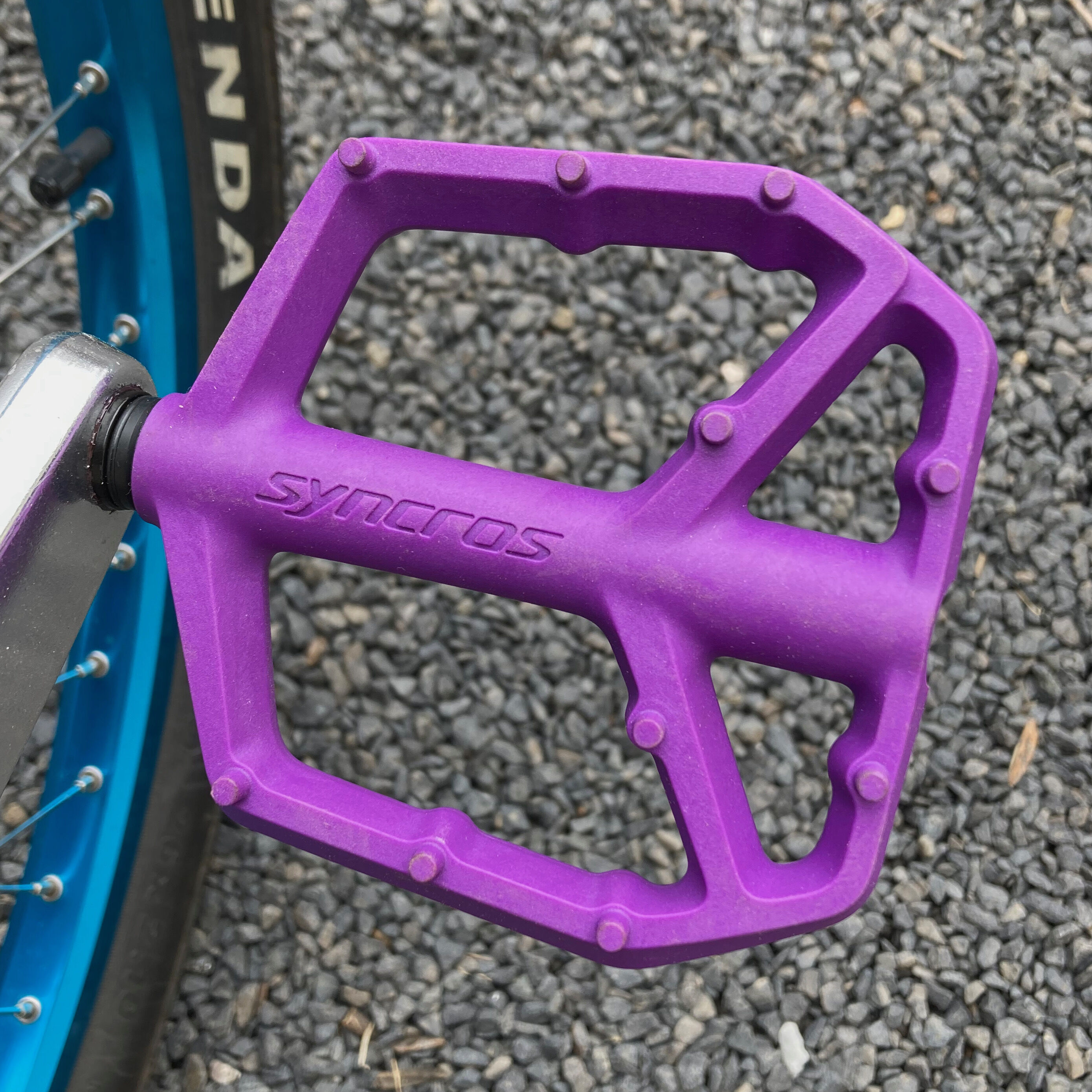

Syncros Squamish III
These are replacements for the Colony pedals on my 26er. Compared to the Colonies they’re larger, feel much tougher, have decent (plastic) pins, minimal axle bulge and are much more purple. Plastic pins, so still not super grippy in the wet, but I wanted “tame” pedals on this unicycle.
I haven’t used these long term, but so far these seem like a good option if you want a large, plastic, well made pedal but without metal pins.

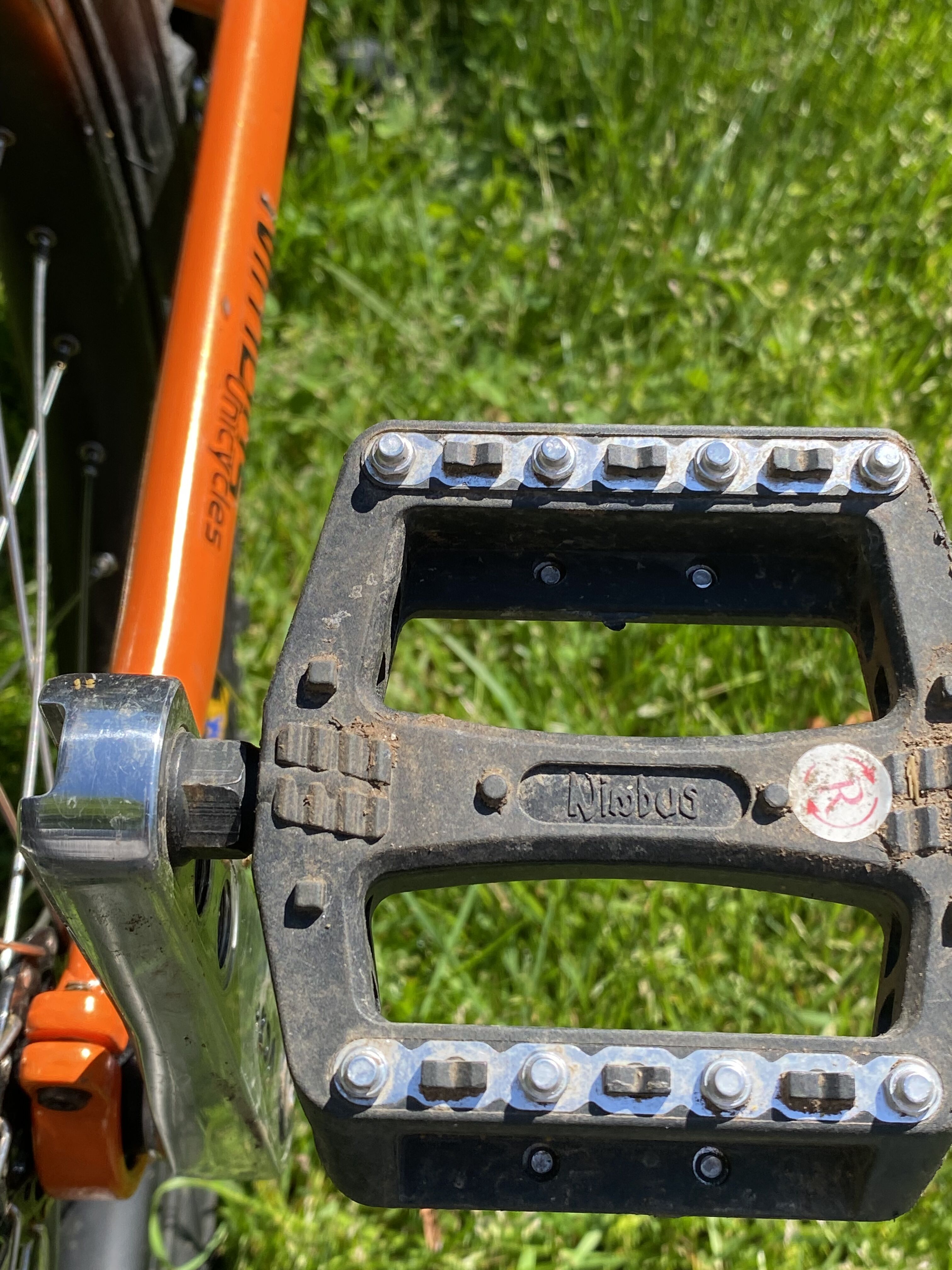

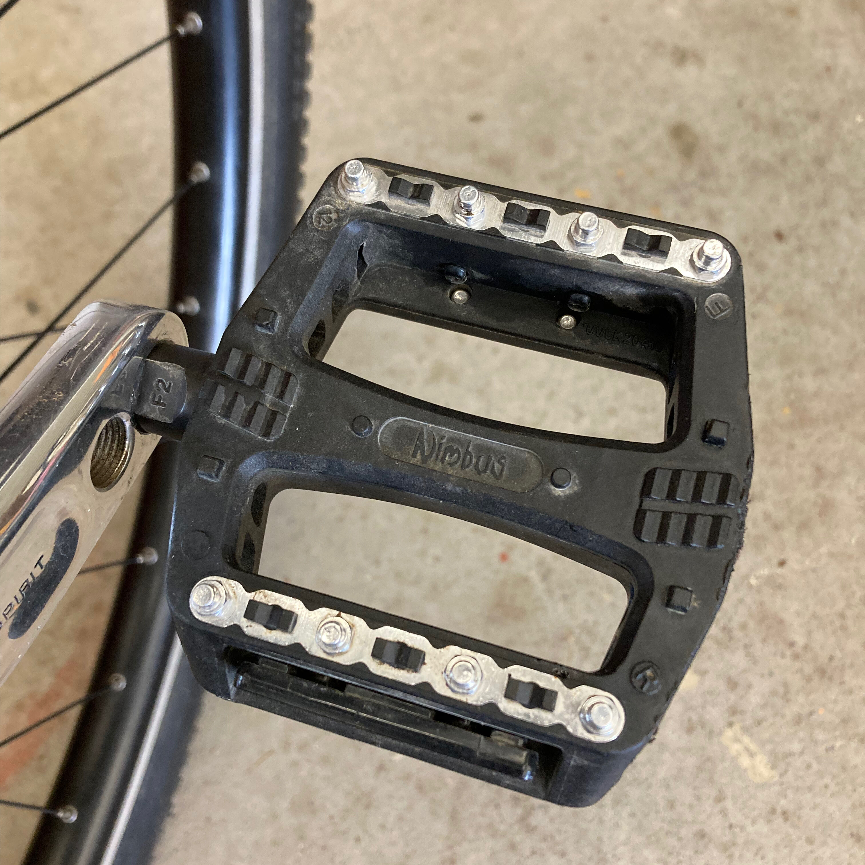

Nimbus studded pedals
Identical to the basic plastic version but with steel pins. Similar to versions by Qu-Ax and KH (the KH ones are polycarbonate rather than nylon).
I used these on my 36er for a few years and overall they’re decent pedals with a good amount of grip. I ended up retiring them because I found them annoying to maintain.
DMR Vault
My goto 36er pedals. Nice size. I find I have a really nice connected feeling with the unicycle.
Great grip with the right shoes, however the pins are quite fat so with the wrong shoes they can feel a bit squirmy. Also the seals on the axle always look like they’re falling out, but they haven’t given me any trouble.

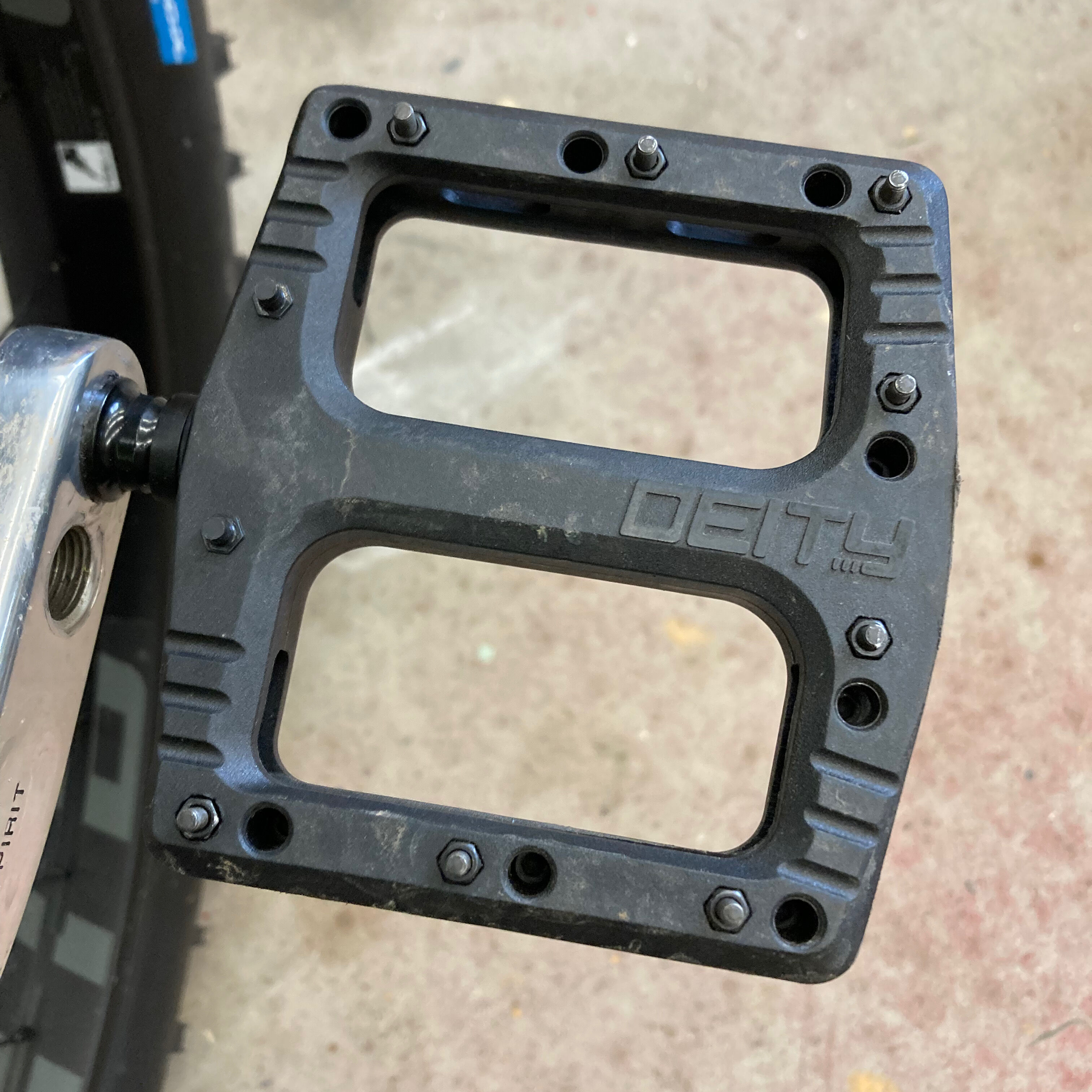

Deity Deftrap
Silly name, great pedals. These are my current muni pedals, replacing the OneUps.
I really like these. They are large, with just a little bit of concavity. They’re grippy and really really comfortable. These pedals, combined with a soft saddle and a 3" tyre make my muni feel like riding a cloud.
As well as running these on my muni I’m also trialing them on my 36er. Somehow they make the 36er feel lighter, although because there’s a lot of grip I do find I have to watch my foot position so that I don’t hurt my knees over longer distances. Still evaluating them on the big wheel but they may just manage to dethrone the Vaults.
There is a metal version, the TMac. I’m curious to try it, but it’s several times the price of the Deftrap so I’m not sure I ever will.

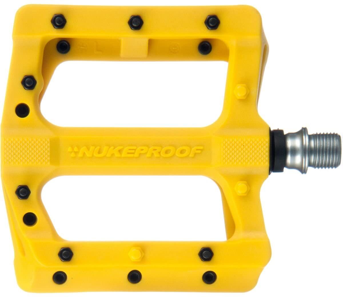

I still currently ride the Nukeproof Electrons (original) on my Muni, and plastic pinned pedals from almost identical moulds from other companies on my 36er (such as the Savage Components Slim Jims, but I bent the axles on a pair of these).

The Deftraps are nice because they have no bumps or anything. Just a slight bit of concavity and the pins.

I pulled my DMR Vaults off my 36er the other day (to try out the Deftraps) and noticed they’re feeling a bit crunchy. Opened them up and the grease around the inboard bushing is all black and gritty. I’m going to clean them up and get them going again, but that confirms my suspicious that the seals on the Vaults are pretty poor.

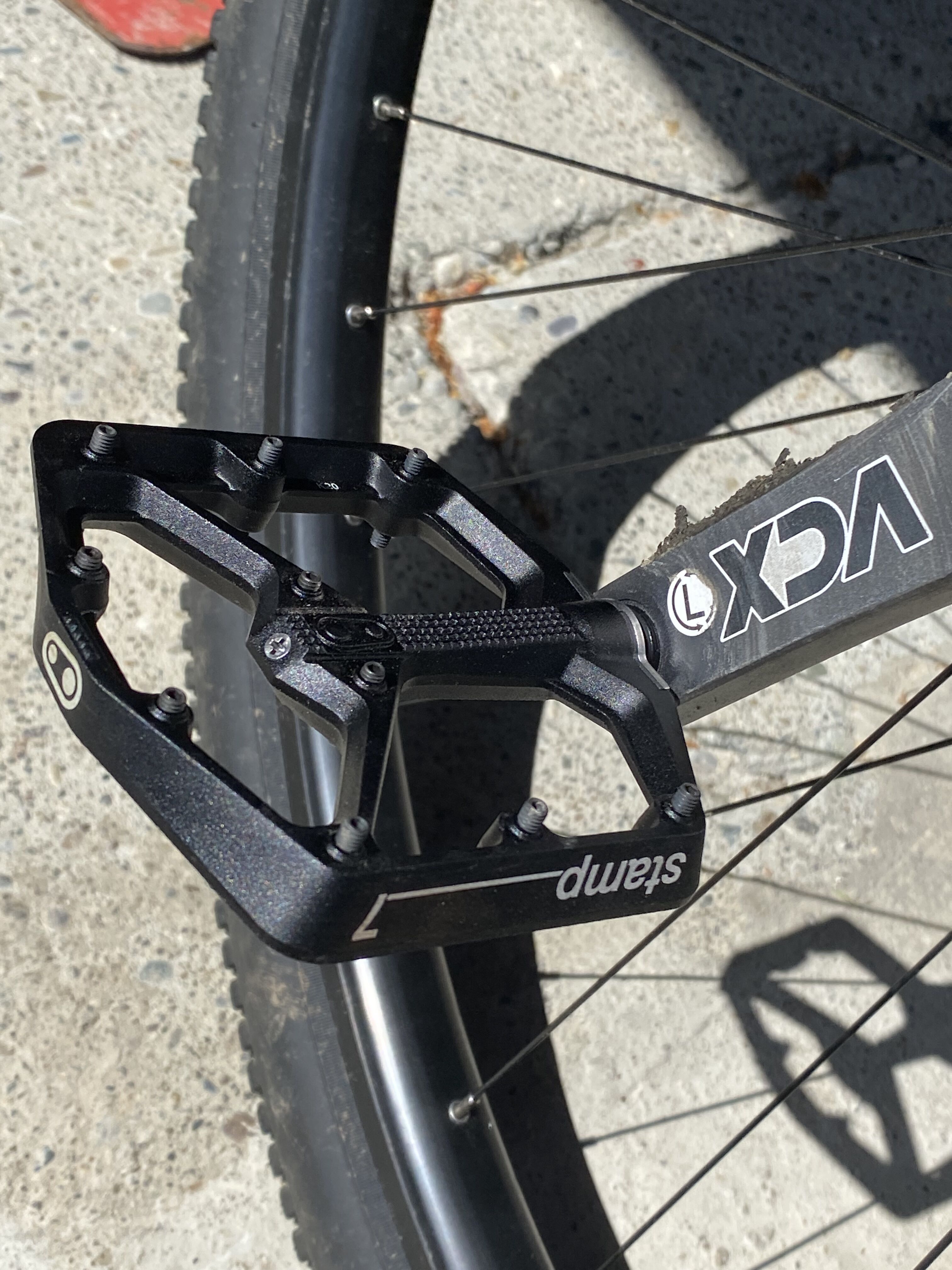

  1. Crank Brothers Stamp7 Large. I’ve got these on my Nightfox and they are great. They have a larger platform than most pedals and are lightweight and thin. They’re extremely grippy, so once you’ve got your foot where you want it they’re great. Trying to move your foot can be tricky however. They’re also a very expensive pedal.

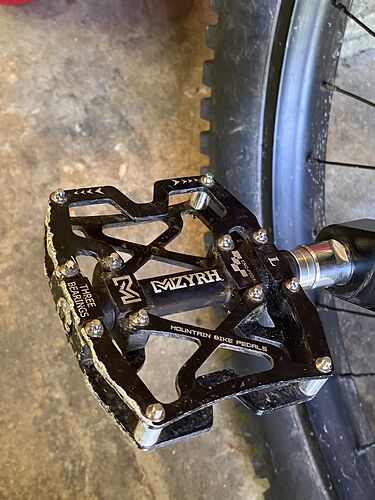

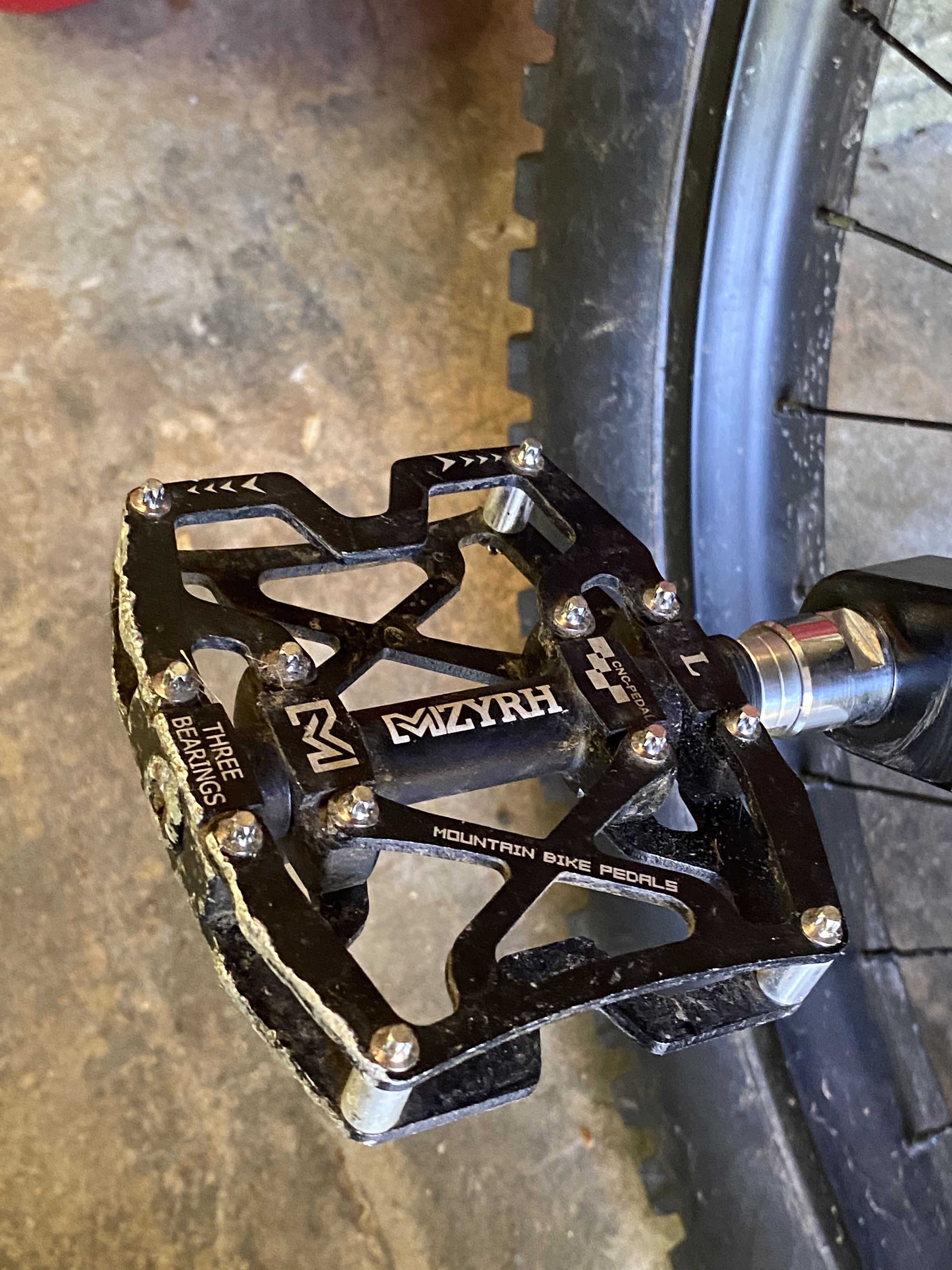

  2. Mzyrh with 18mm Ergotec extensions. These are a cheap off brand pedal that seem to be pretty decent. With pedal extensions on I like them. Without the extensions I find they position my feet too close to the zero q cranks on my quax. Unfortunately Ergotec extensions cost more than the pedals. My first set of cheap extensions broke after a month of use. These are reasonably grippy, but still pretty easy to shift your foot around on. I think this is due to the pins being located near the spindle rather than the edges of the pedal. These have taken a fair amount of abuse and have held up fine.

  1. Nimbus with steel pins. I don’t really care too much for these. Like the Mzyrh they’re a little too narrow for my wide paddle feet. They also have good grip, but I find it harder to shift my feet on them while not feeling as well supported and locked in as with the Stamp7’s. I find that when I try and move my foot backward with these that the pedal frequently flips over and I end up riding on tip toes.
  2. Nimbus with plastic studs. These are the same as #3 only minus the metal studs. Grip is poor, but shifting your foot around is much easier with them.
  3. Quax with plastic studs. Except for the logo, these are identical to the Nimbus pedals.
