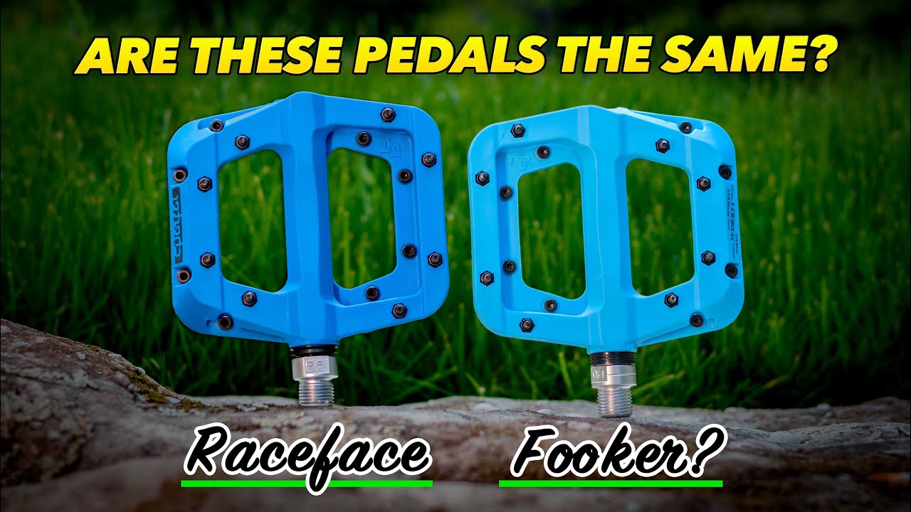

The race face Chester pedals are the standard for me (usually 50€, sometimes as low as 25€). Allow for amazing grip with five ten shoes and so far neither I or my friends have broken them (I’ve bent some similarly prized metal pedals).
