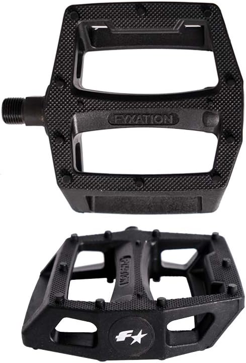

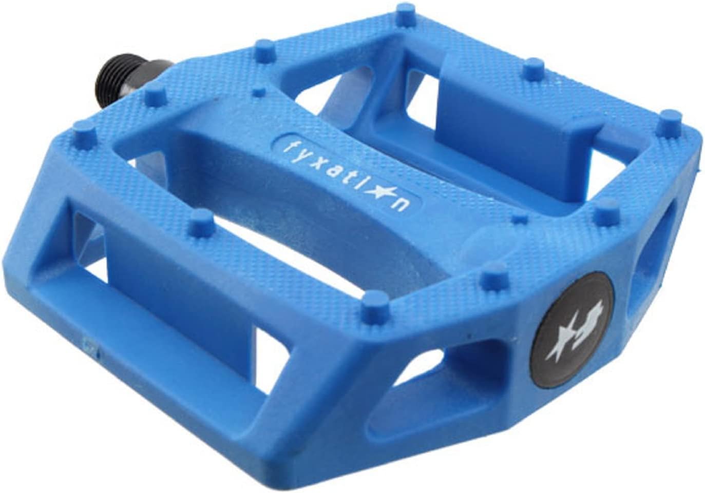

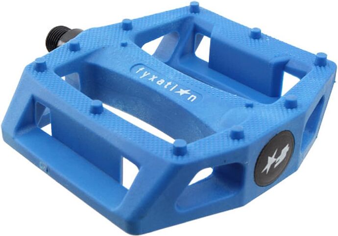

Like these?-
Presumably those pins are plastic? If so wouldn’t they have the potential to cause damage like metals ones, in falls where they’re dragged down the back of the legs?
They might still cause some damage, but the pins are wider than any metal ones I’ve seen, they are pretty short, and the top is flat rather than slightly tapered at the edges like metal ones usually are so they should be much more forgiving than metal. I haven’t had a bad fall on them yet, but I don’t think it would be nearly as bad as metal pins.

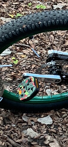

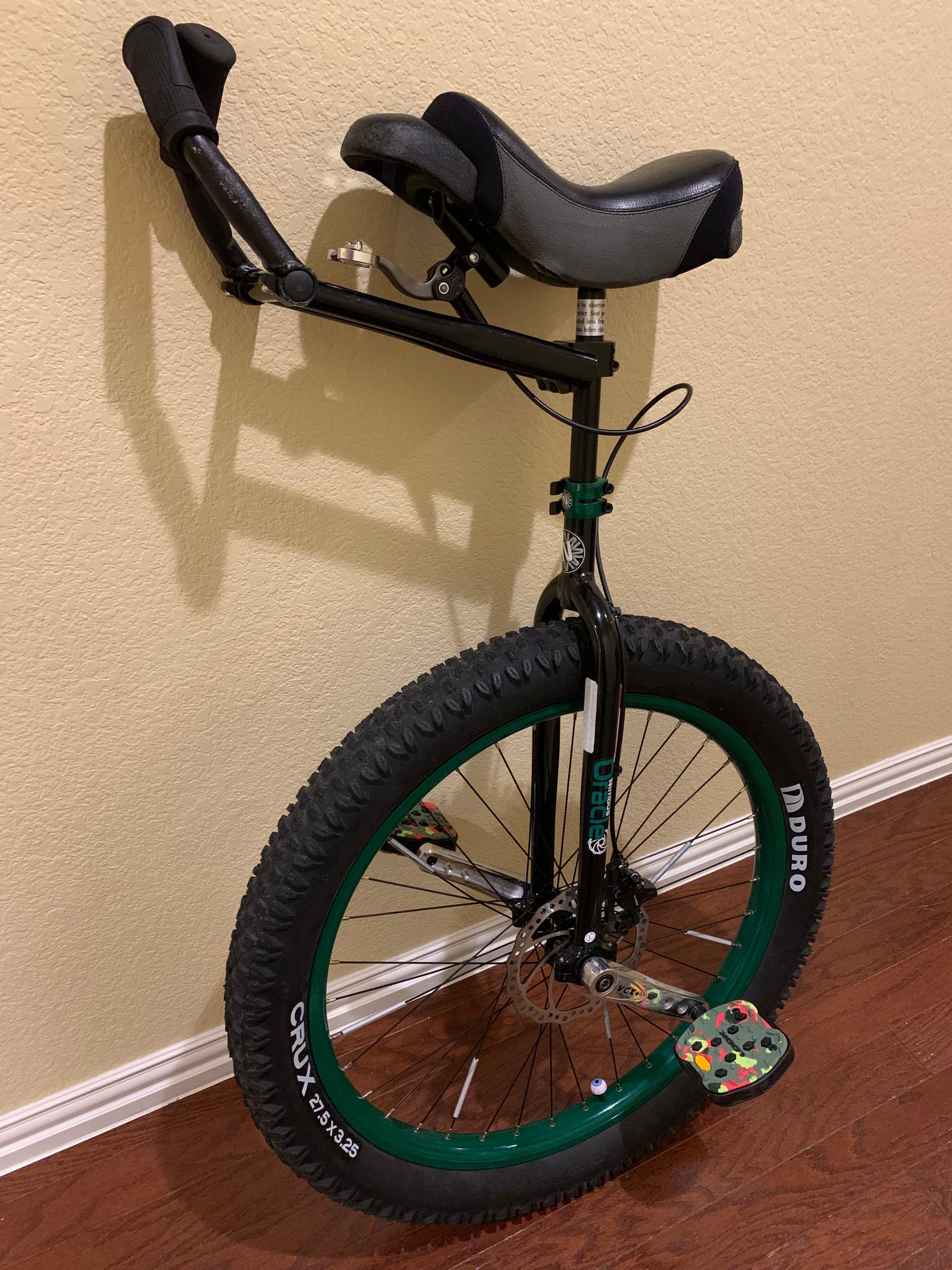

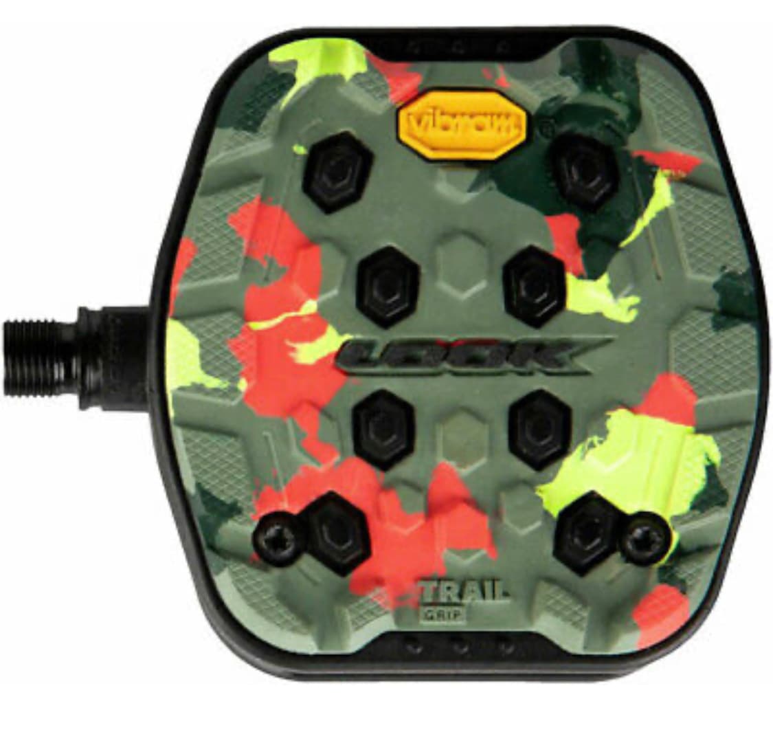

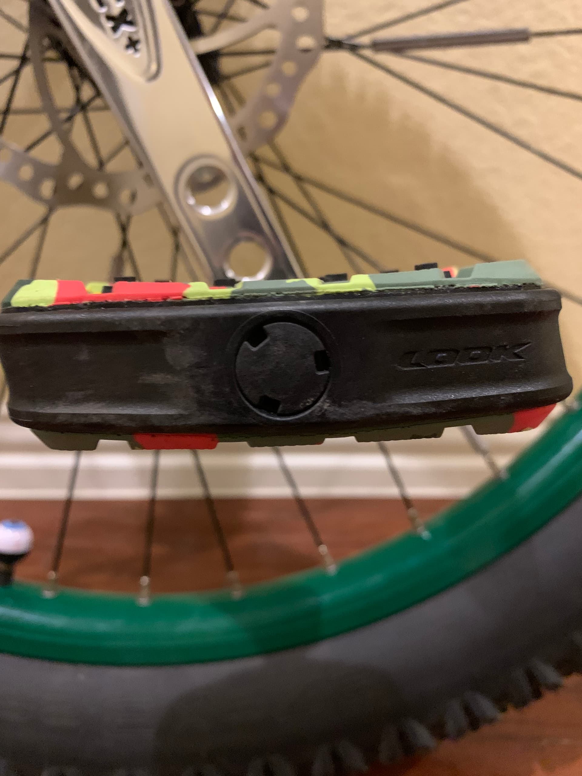

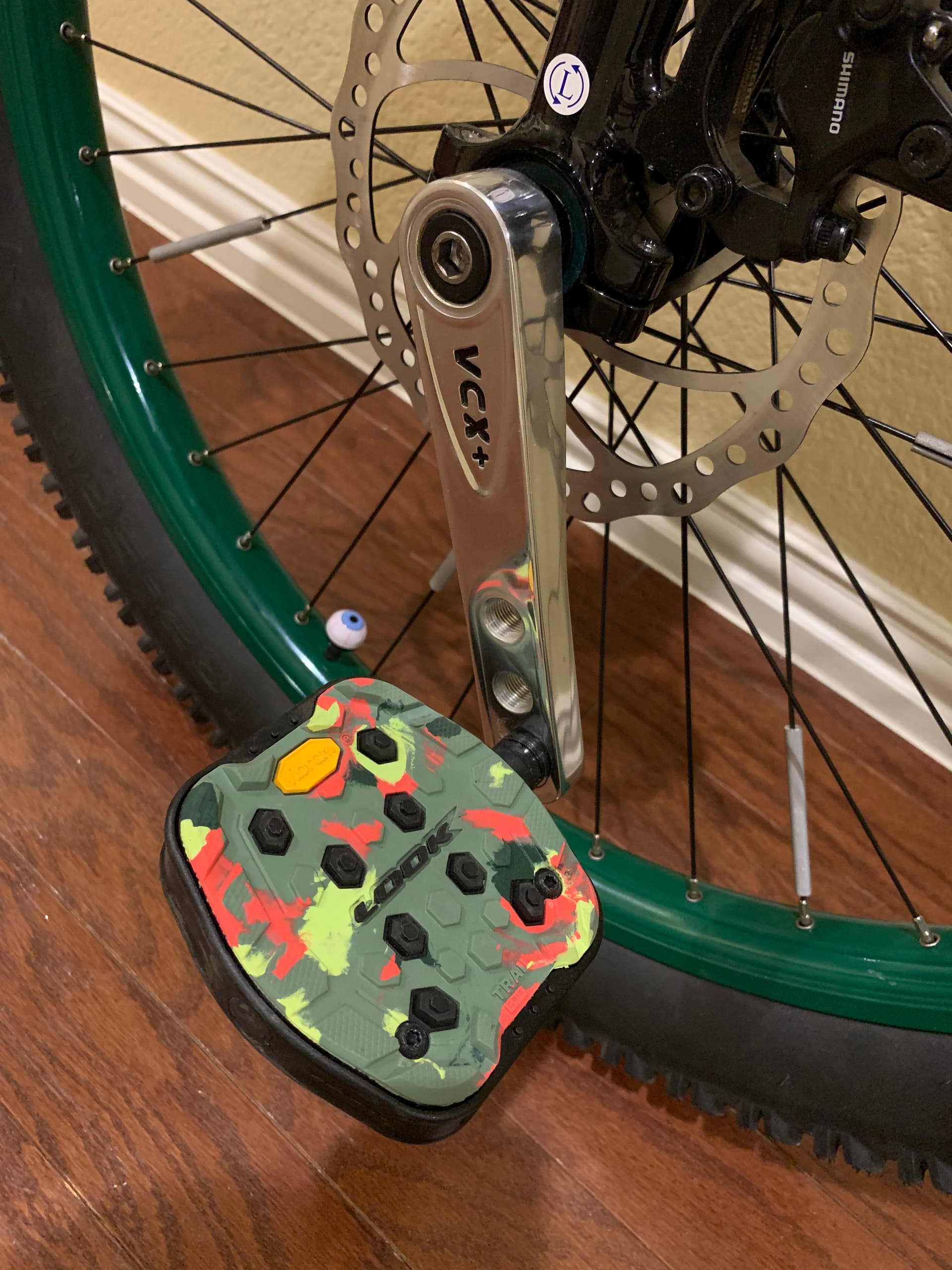

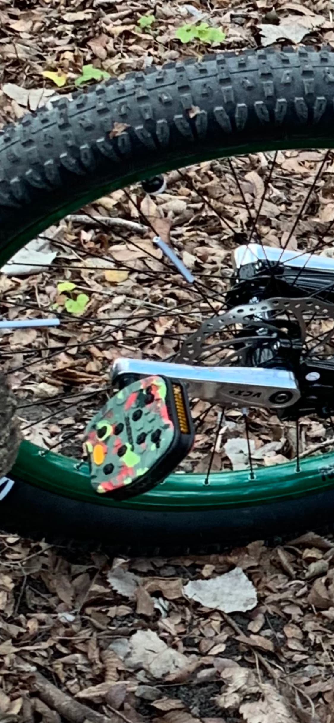

I bought a set of Look Geo Trail Grip pedals and love them on my Oracle 27.5.
They have pins, but there isn’t any way the pins on the Look pedals will damage your leg like your others did.
Look also makes a Geo City Grip pedal. No pins. The rubber platform is made by Vibram.

Interesting looking…I wouldn’t have thought they would be that grippy given the picture, but learning on my new Oracle 27.5, those big sharp looking pins on its pedals do make me nervous, especially trying to get freemounting the new bigger/taller wheel down, so was also looking for less dangerous options to put on it (at least for now). I was thinking maybe Fyxations, but your experience makes me wonder if these might be better.
I have a few updated photos. Obviously, I like them. But you will have to be the judge for your needs.
