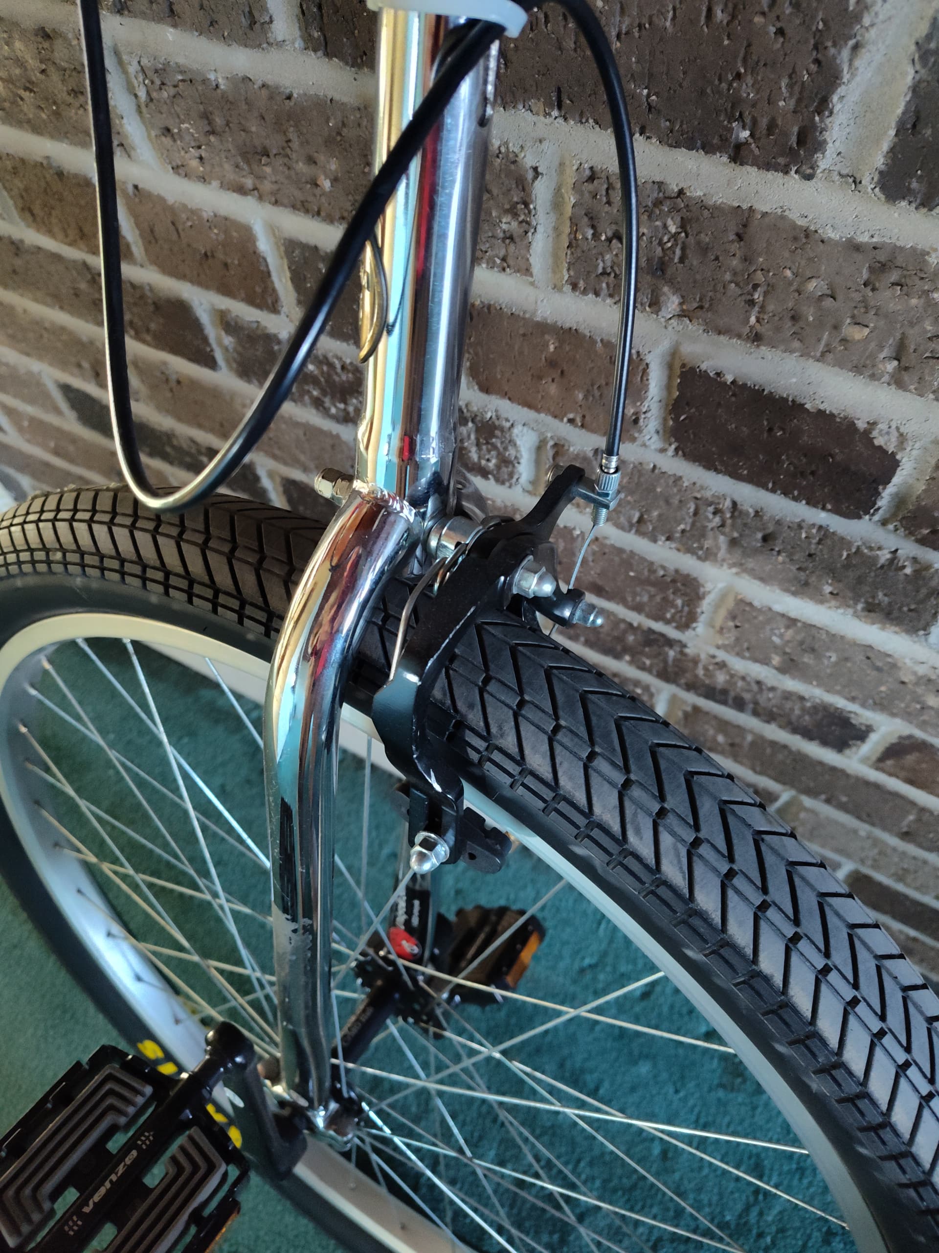

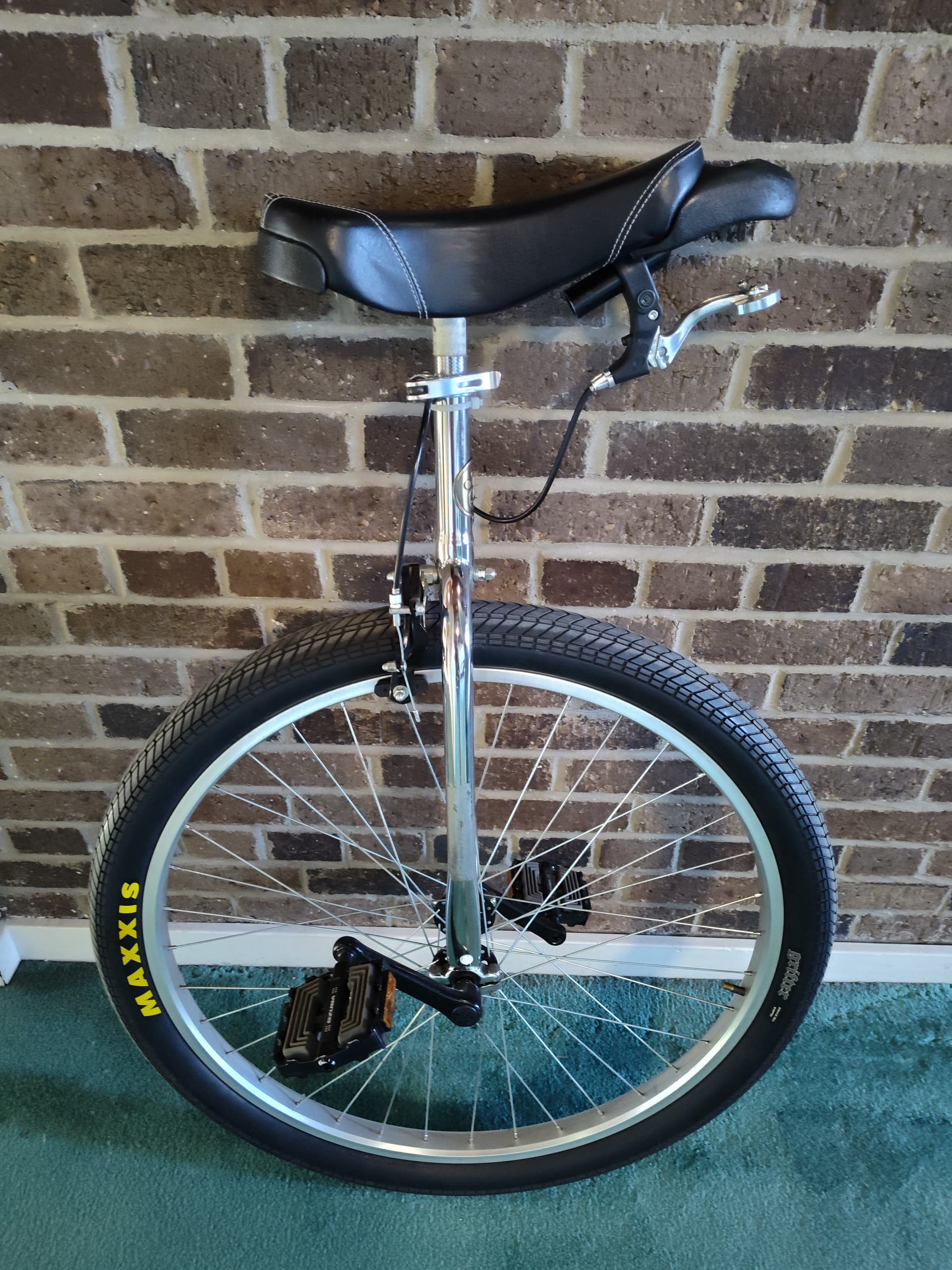

Drill a hole in your seat post tube above your fork and install a bmx side pull break. You will love it I have it on my udc 29 and 32. I like these brakes, I have them adjusted so they don’t grab, I can modulate my braking very smoothly. Old school brake for old school uni, easy DIY project and no welding.
Amazon has many to choose from like the one in the link below.
What tyre size do you have? I’m running a Schwalbe Crazy Bob currently (2.35"), but also have a Maxxis Hookworm (2.5") and a DMR Moto Digger (2.35" and more knobbly) that I would want to be able to use. I’m thinking calliper brakes like these won’t give enough width clearance and would also be reliant on the fork crown being the ideal distance from the rim position as the brake is positioned by the drilled hole location.

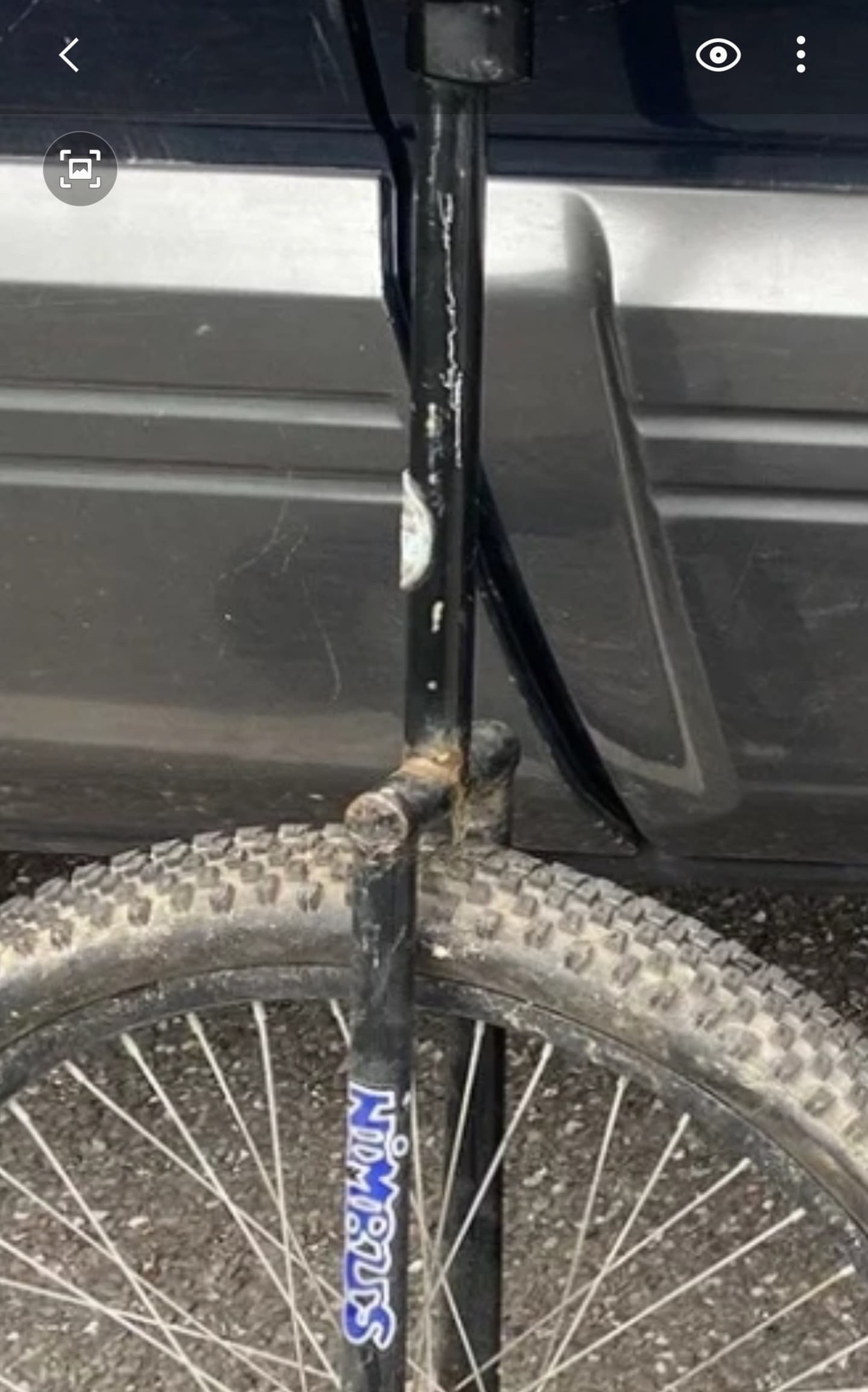

I’m riding a chrome Nimbus II 24" frame, but I’m thinking any mods for braking would happen as part of restoring a Nimbus X frame, which has an unusual fork crown.

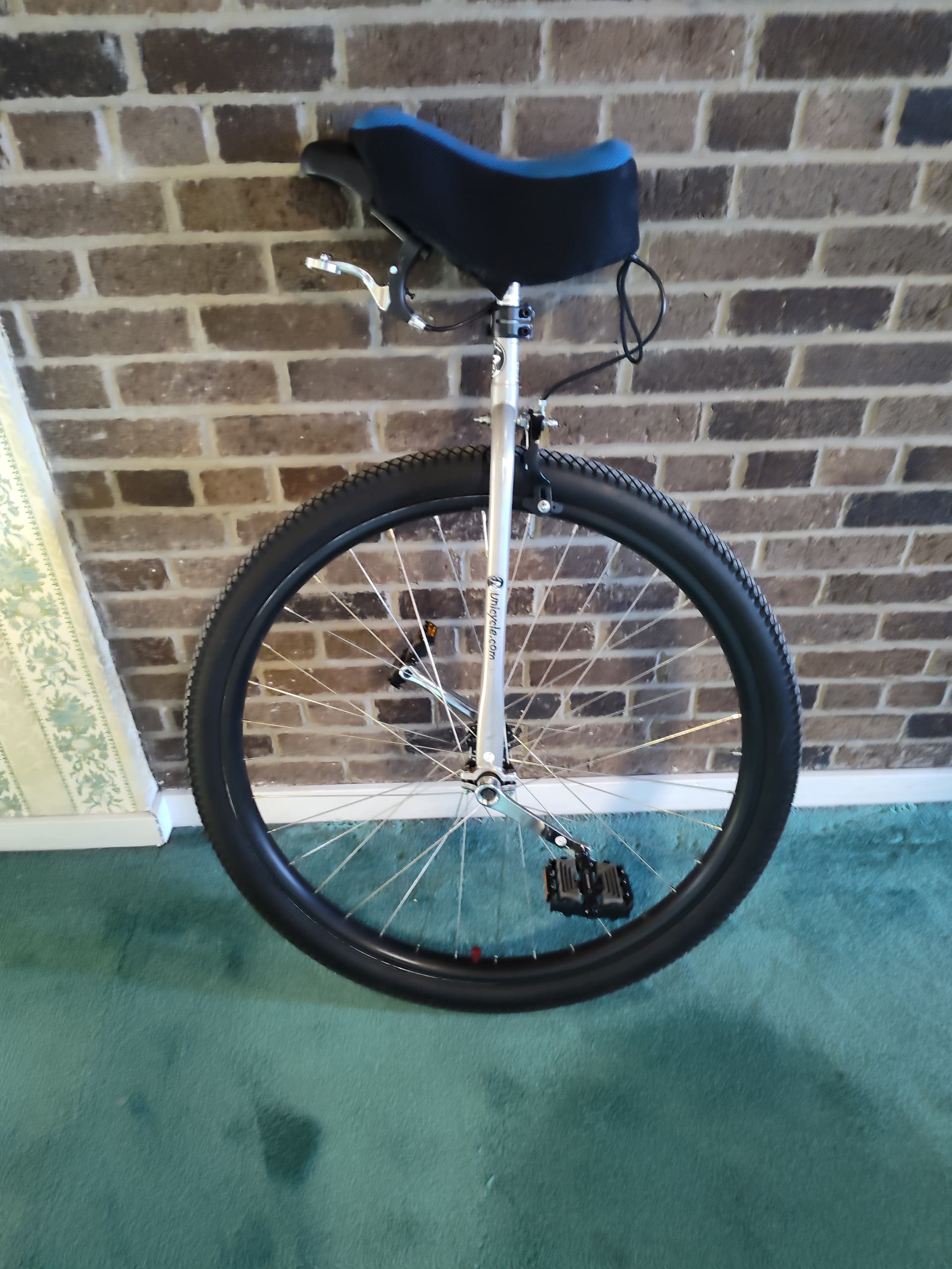

I have the nightrider 32x2.25 on the 32. I have a maxis tire on the 29 I will check it when I get into work this morning and report back. I will send a few pictures

Thanks, that’s really helpful to see. I’ll have to do some measurements and check the state of the fork crown for drilling. I can see those calliper arms clear your tyres OK, but I think one of mine (and possible future more aggressive tyres) would be less rounded.

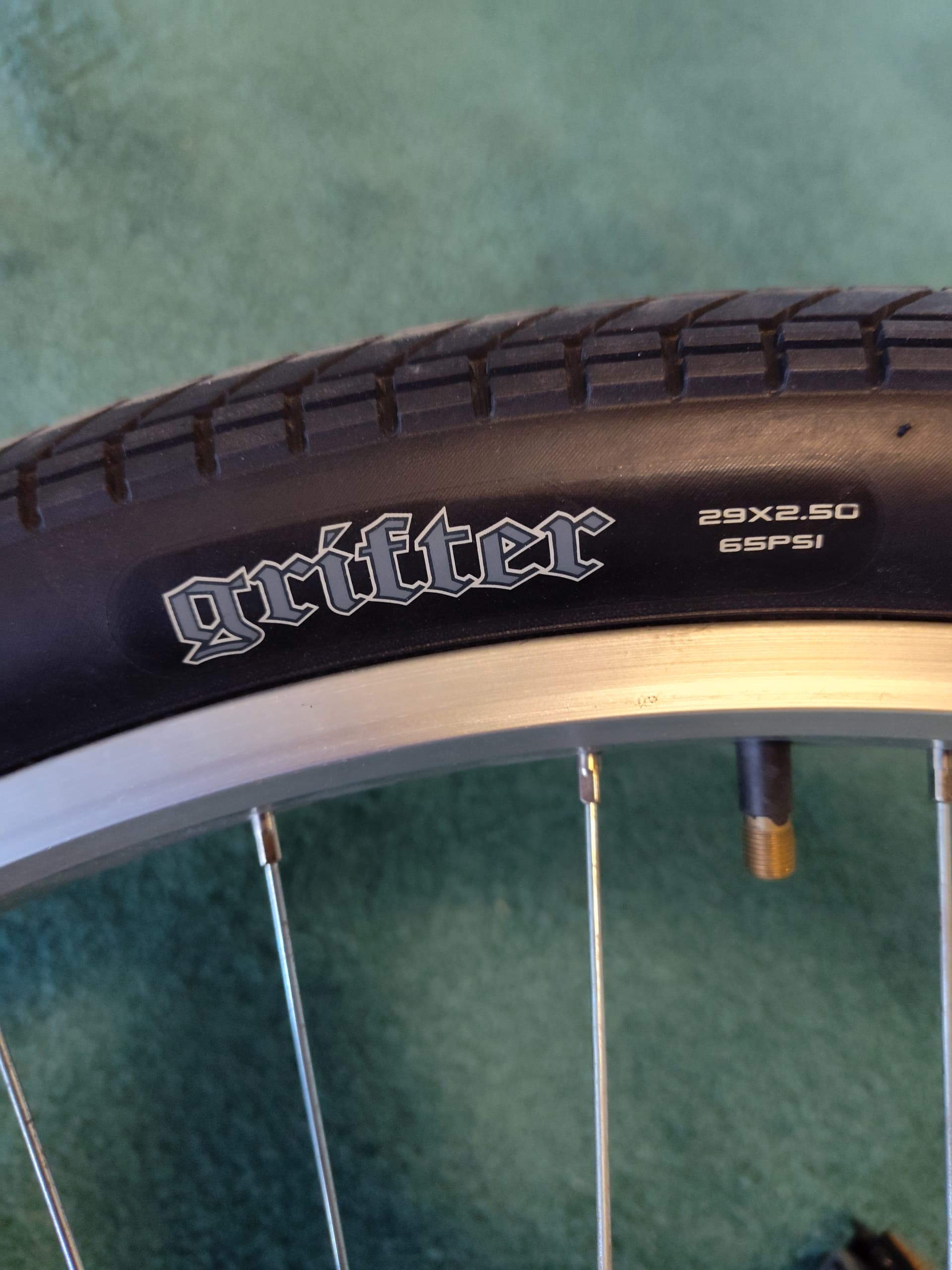

On the 29 ER that unicycle came originally with a 1.95 inch tire. I rode this with an inova 2 inch tire for many years. If you can see from the picture that tire is very tight in the fork. My nimbus 29 road has much more clearance between the tire and the fork with a 2.5 inch tire.
