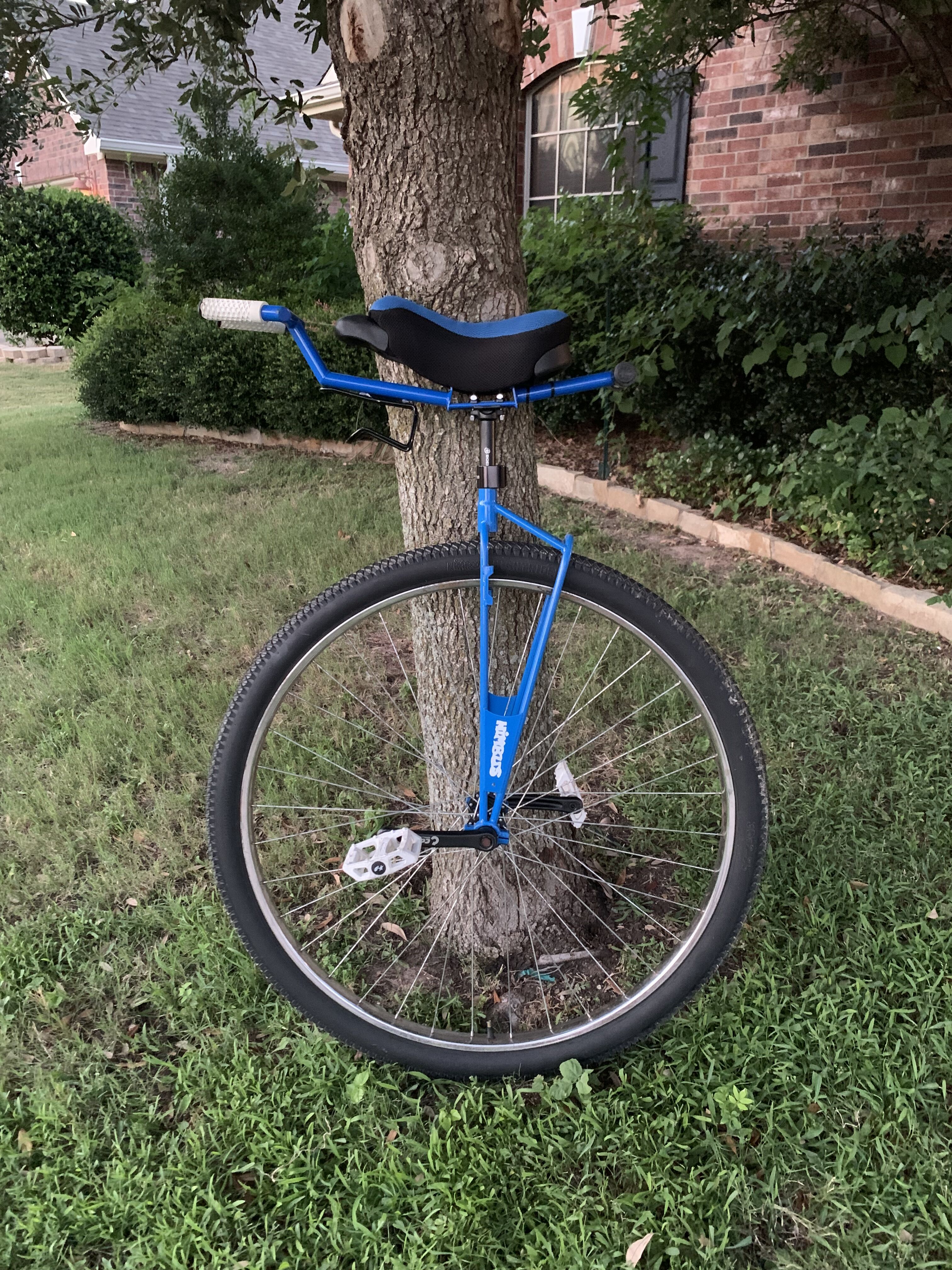

A but off topic, but nice uni @Uni2ONE2 ! What frame is that and is the handlebar homemade?
The frame is an older Nimbus frame, and the handlebar is a “Nimbus T7” handlebar from the same time period as the frame.
I bought the frame on eBay, and then @mindbalance reached out to me and said, “I have a handlebar that I think you might like.” He was correct, so the handlebar made its way from England to the USA.
Awesome, thanks for the info! That frame just looks so cool!
V-frames rule! (in terms of looks)

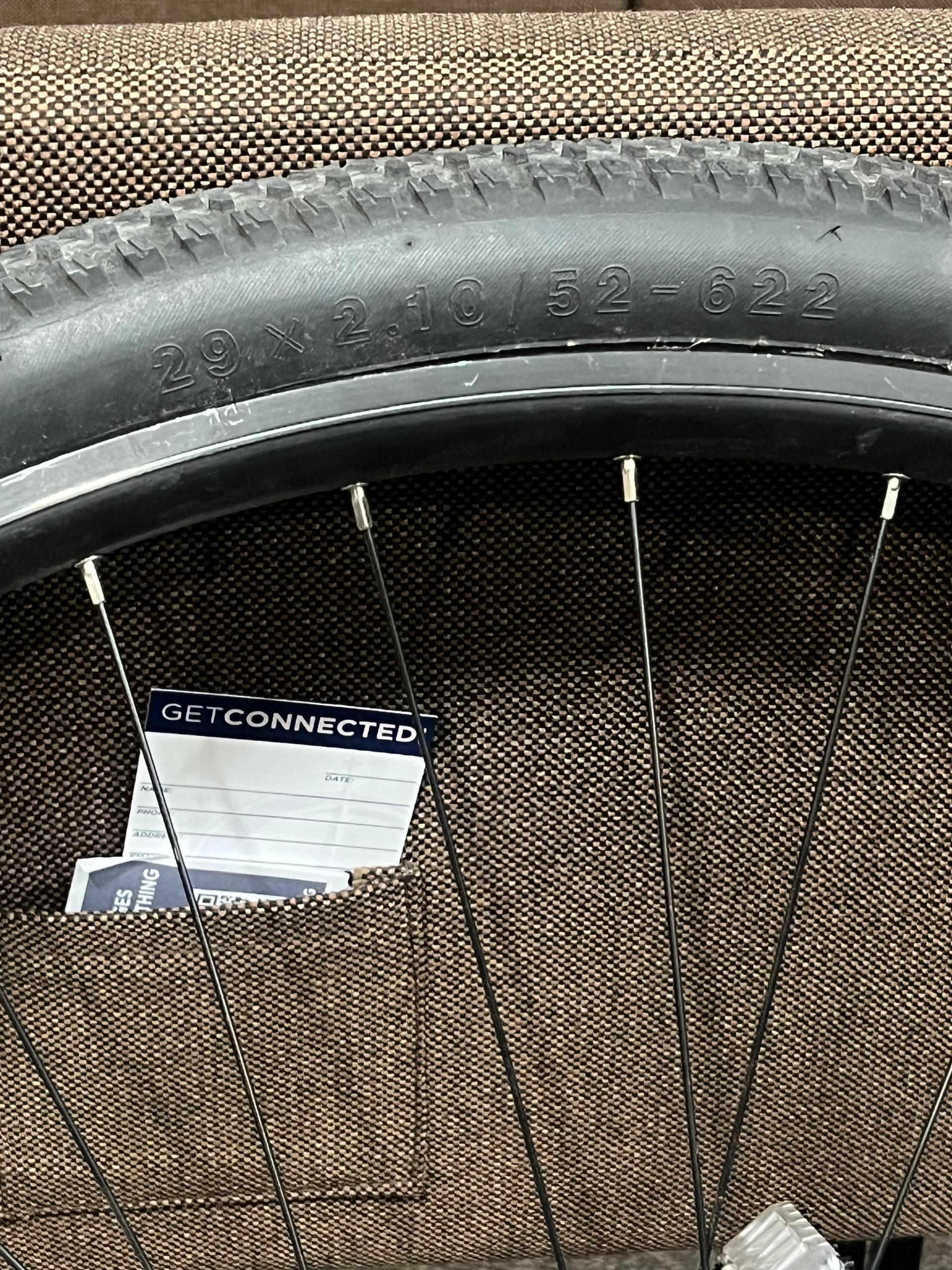

I can help you with the tire! I can make one or try to teach you.
Shown here is my frankentire
