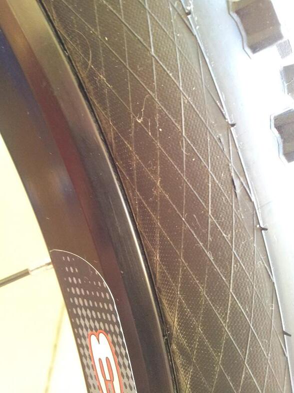

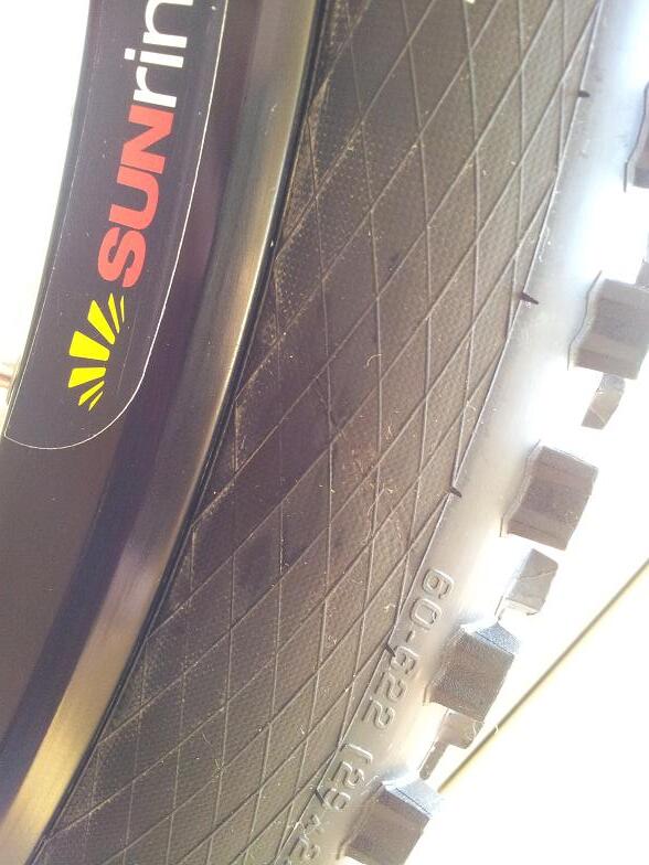

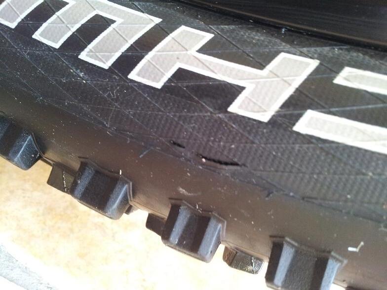

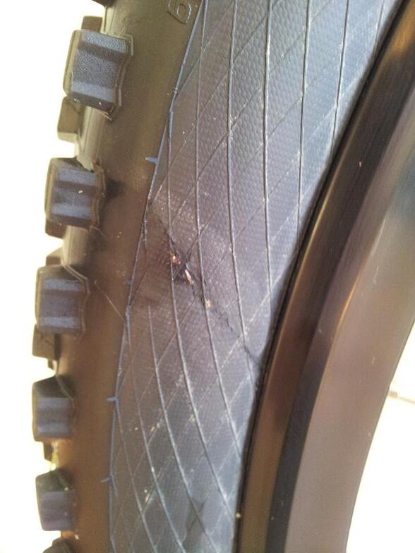

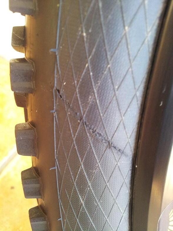

Well after a fair few months on Hans he is constantly amazing me at the level of grip and comfort at 18 psi and even good road manners.
What has really impressed mi the snake skin sidewalls, I raid in a coastal hill range that is all chalk and flint, part of the trials are just lots of loose flint that is all broken up with razor sharp edges and I have lost many a tyre over the years
Had a quick look at Hans and had it not been for the snake skin layer I would be down 5 tyres!

David, don’t be frightened off by Feisty’s pictures of the sidewall wear on his Hans Dampf, that is at the far extreme of tire abuse. Flint is very hard and sharp, think arrow heads and prehistoric cutting tools, so not what you will encounter anywhere around here. I have many hours on my Hans, low pressure and high pressure, and I have no noticeable wear on the sidewalls or knobbies.

Yeah I ride on nasty stuff and any tire will suffer that damage, those pictures show how good the Hans Dampf is for surviving the knife edge flint, I don’t think the Pacestar compound would fair any better.
I ride a thinner rim than most and even with 18 psi the tyre tracks straight and absorbs the rough stuff superbly.
