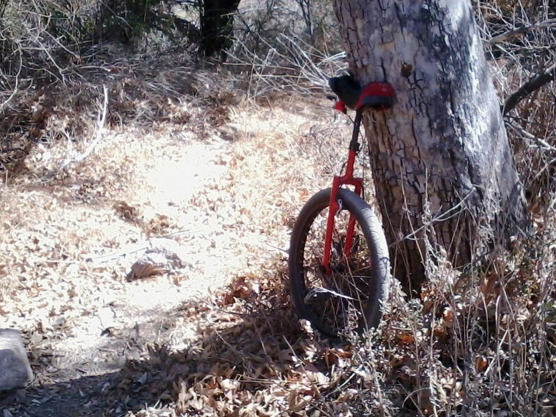

Schwalbe Rock Razor 29 Super Gravity TS
A quick review of the Schwalbe Rock Razor 29 tire ( Super Gravity - Trailstar) :
I just tried this tire out in my typical riding conditions here in the desert of southeastern Arizona and it did really well compared to my go-to 29er tire - the Super Gravity Hans Dampf.
The Short - for dry sandy, and loose-over-hard conditions in the desert this is a great XC / tour tire. Jenson USA has these on clearance right now (Dec 2016) for $20. Definitely worth getting one.
Trail Conditions - dry - Hardpack, loose (sandy) over hard, rocky, 1-2" deep sandy spots, some steep ups and downs, some road sections.
Setup - Nimbus Drak 29er with Coker handlebars, disc brake and a 50mm wide Surly Rabbit Hole rim.
This tire rolls slightly smoother and faster than the Dampf on rd, hardpack, and loose-over-hard. I also found its grip a little more consistent. It seemed to behave this way on flats, as well as steep climbs and descents, and off-camber slopes.
The tire did better than expected on sections with deeper sand (~2"). I didn’t notice any decrease in performance over the Hans Dampf. Its possible that going fast into sandy section this tire slowed a bit faster but its hard to say.
The light 50mm rim really gives this tire a stable feel, but it retains enough roundness in its profile to carve alright too. It took the uni off some 1 ft drops and it landed squarely (same as the SG Hans Dampf).
