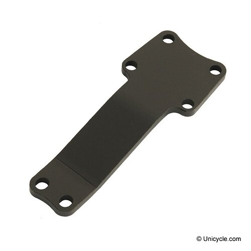

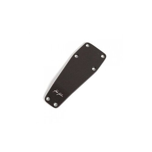

Wait… What is an Impact Saddle reinforcement plate? Is this the same plate that comes with the handle? I used the KH one on my Stadium saddle and it worked fine :thinking:
KH plate:
Impact / DD plate:
At least the shape is different. Can´t judge if there is a difference in the drilling pattern.
Weird. I’ve never seen that Impact one, it does look a little slimmer though!
I do remember having to sort of jiggle it around to make the screw holes line up when I fitted mine, but it did go in and I didn’t break anything.
