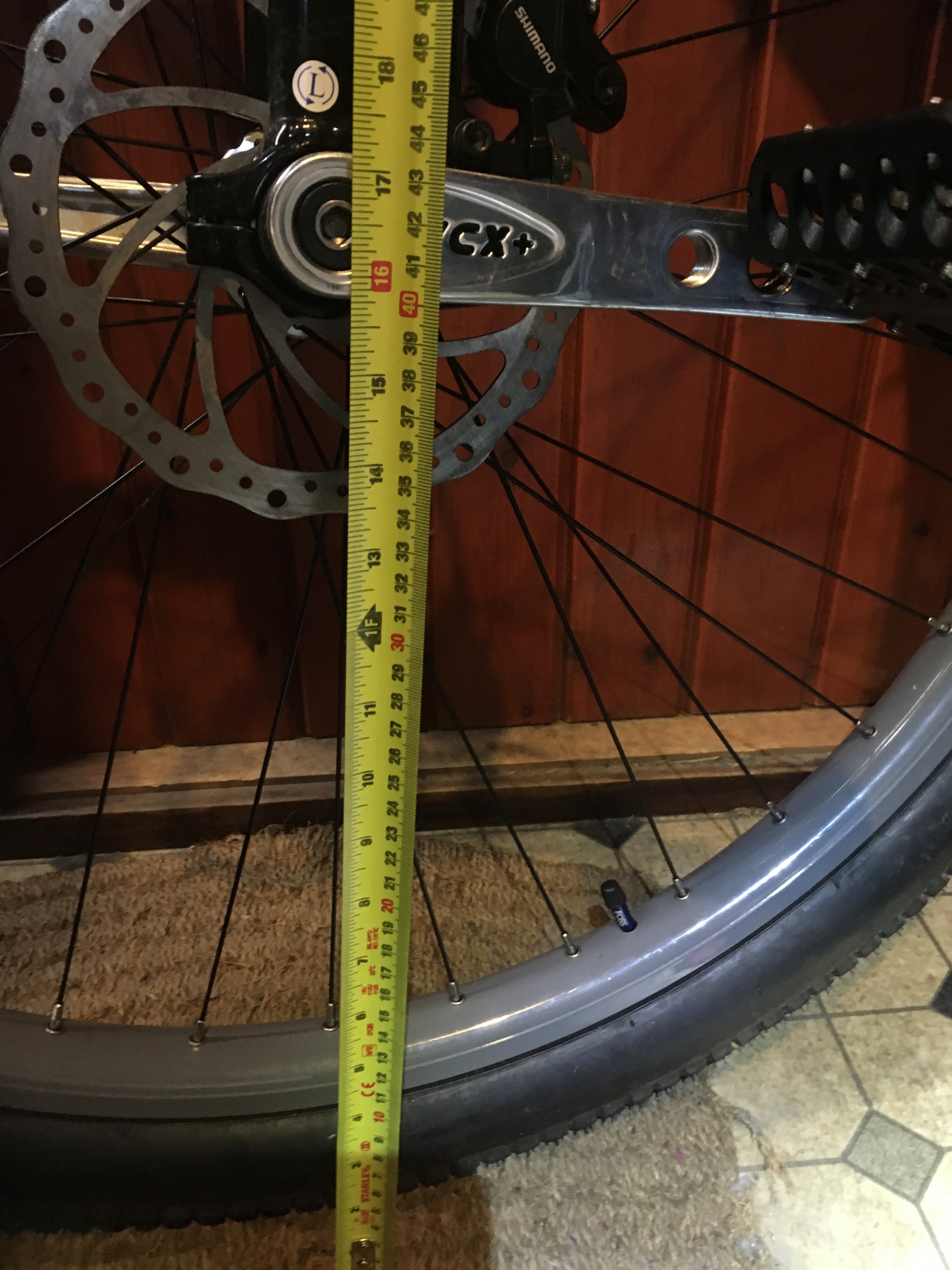

It has a radius of about 16.25 - 16.5" (the rule in the photo is at a bit of an angle). This is my 32" Oracle.

Yeah, got a measurement of my Oregon. Looks like 15.5 inches is maximum clearance. So perhaps I can go for a big 29er wheelset. Thanks!
