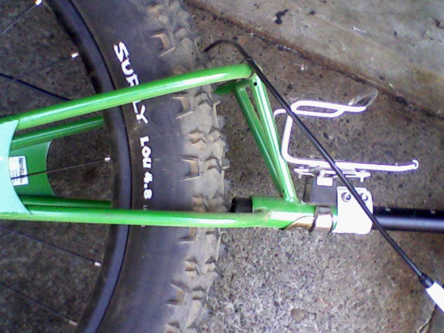

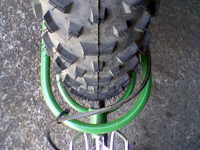

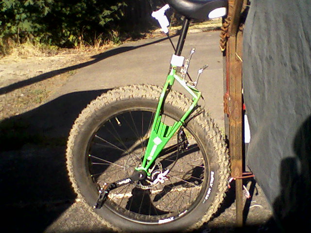

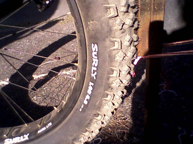

Had to try the more cush logic and put a Surly Lou 4.8 on. I will keep the Marge Lite. The tire rounds nicely. I originally was dreaming of a 100mm rim, but now think that would flatten the footprint enough to make the riding much harder for someone with my experience. The Lou is the same energy to pedal as the Nate with more “run over anything” feel. For the experienced riders this may be an odd combo or not the best use of equipment, but for me, this has opened up major trail options.
Thanks for the review! I was actually looking at this tire but I was worried with my marge lite rim it wouldn’t work.
Nice!!

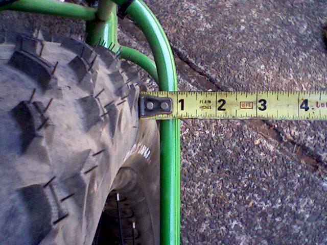

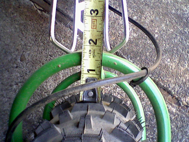

Suprisingly looks proportional to the forks for such a huge tire. Can you show pic of top and side clearance from front angle?
Plenty of clearance. Nice rounded tire. 65mm is the narrowest rim.
Sidewall has propulsion going one way and cornering going the other. I went with cornering. Nobody comment on the seat post that still needs cut.:smiley: Check out the size of those knobs. :astonished:
Not noticeable until mentioned. Shadow covered it.:smiley:
