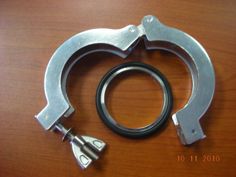

some thing like this with locking cam lever in spite of butterfly nut
