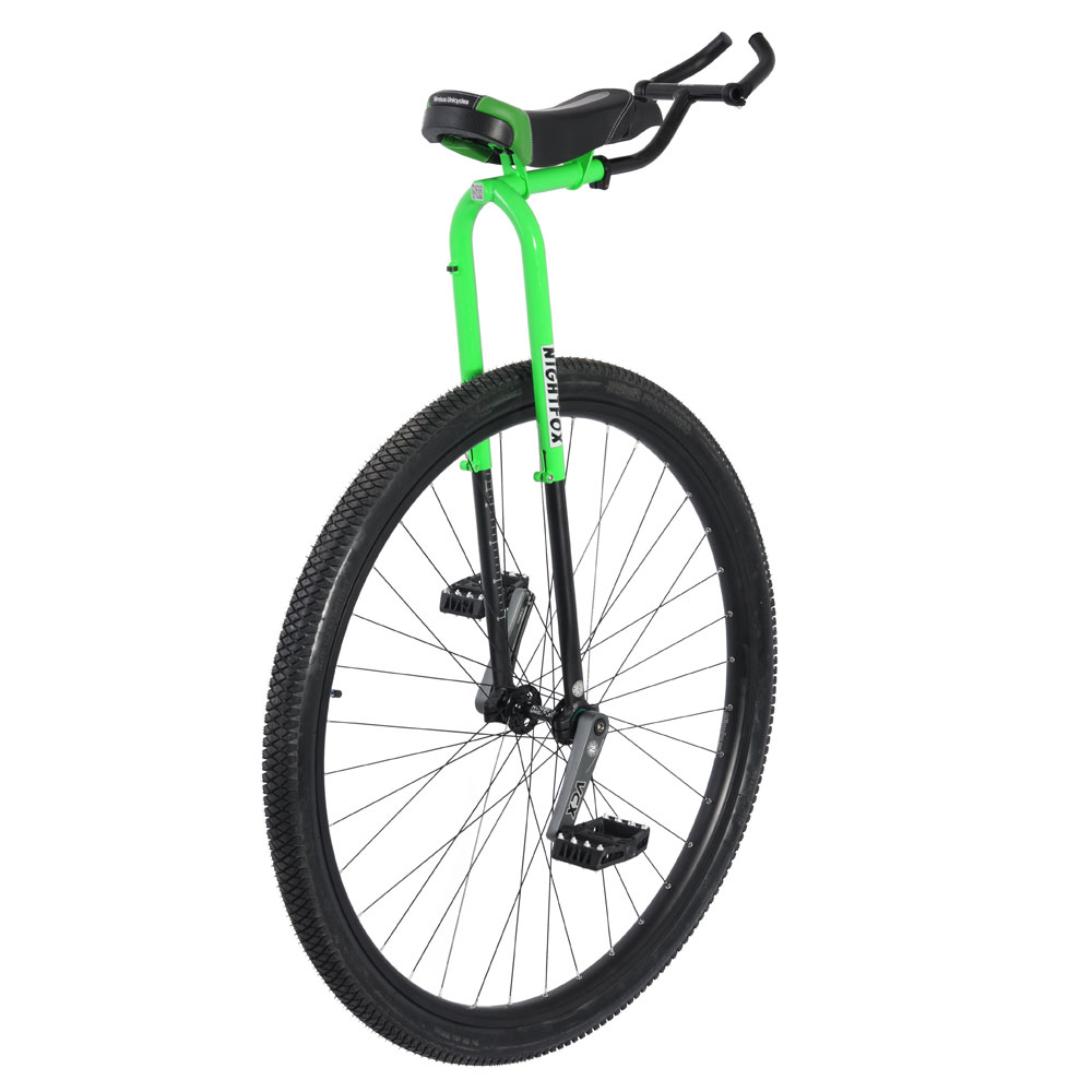

I’ve had my Nimbus Nightfox for almost a year now and love it. Lately I’ve been wanting to commute to my college which is about a 13 mile commute in one direction. My goal is to attach panniers to my unicycle to take stress off of my back but the frame of the Nightfox is very unique with the split tube frame design.
I’m working on 3d printing a Mount for a seat post pannier rack but I’m curious to see if anyone else has tried attaching panniers to a Nightfox before? I’m not convinced that my 3d printing idea will work so I’m trying to think of alternatives.

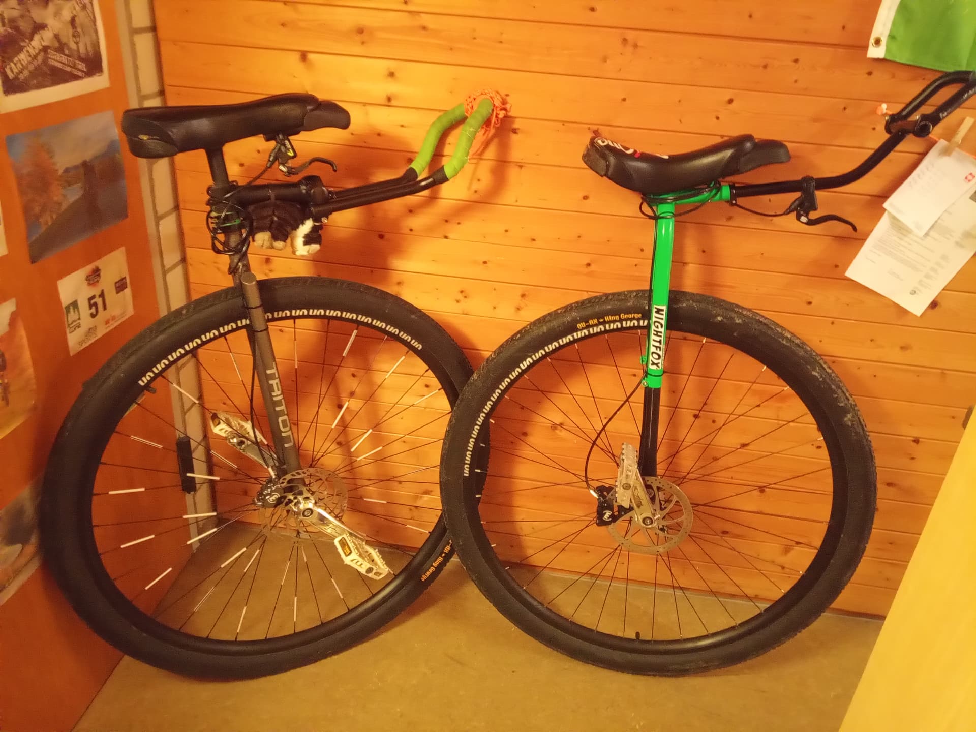

Yeah I’ve been riding without a brake. When I bought it, I wasn’t sure if I wanted a brake. But with the amount of hills around me, the brake is now a must have. I’m in the process of installing one, but only have the rotor on. I have to figure out a way to attach the brake caliper to the frame - I ordered the wrong one so I have to make an adapter to fit it. What brake kit do you have on your Nightfox?
I also use thé D Brake Adapter from Nimbus. IT works good. I Ride with thé Kris Holm Dual Spirit Cranks but you can also ,If you Had thé right Hub, you can Go for am INSIDE Brake, which isn’t so expensive for thé Ctanks. But i don’t know which Hub do you use for this.
From your photo, your frame has a disc brake tab on it so you don’t need a d’brake, just the proper size adapter for your brake – you don’t need to make anything, just get the correct adapter and bolt it on. The NightFox didn’t originally have a tab so you needed a d’brake with those (as per the photo in your original post).
You probably need an IS to Post Mount adapter depending on the brake you have and size of the disc, I can’t remember at the moment if the mount on the frame is IS-Front or IS-Rear (I think it is IS-Front but you’d need to check). If in doubt get a bike shop to sort you out, these are standard bike parts and not particularly expensive.

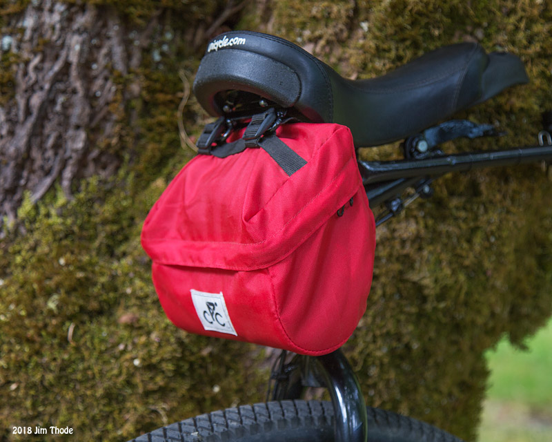

How much stuff do you need to carry? I think you could probably hang a bag (maybe look around bike frame bags for something suitable) between the seat and the tire, which would have the weight in a nice and central place too.
That wouldn’t be enough for a laptop or a full set of spare clothes, but a lunchbox, waterbottle and rainjacket could fit.
I’m a big fan of panniers on my bike, but I think on a unicycle it’s best to keep the weight as central and tightly packed as possible.
Wow that’s super helpful, I had no idea there were adapters for this. So that’s a major relief, I thought I’d have to spend a few days trying to get it to fit and measure up correctly. Thank you for sharing that! I also checked and all the sources I could find suggest it’s an IS to Post Front mount for unicycles. Found one online for around $10, should be coming this weekend

Yeah I’m thinking I’ll keep my laptop in my backpack, I’d hate for a UPD to take it out. But yes, I’m planning on carrying a lunchbox, some extra clothes, a heavy lock, maybe a small book or two but I’m trying to keep it as light as possible. I don’t want to struggle to balance my gear. I have some gnarly hills on my ride so ease over effort hopefully.
That’s a good point about the weight being central. I’ll look into a small bag, I have a small triangle shaped bag I’ve tried using but it sags too much and since I can only hang it on one side of the frame it leans in and rubs against the tire. Could probably benefit from a different shaped bag though.
