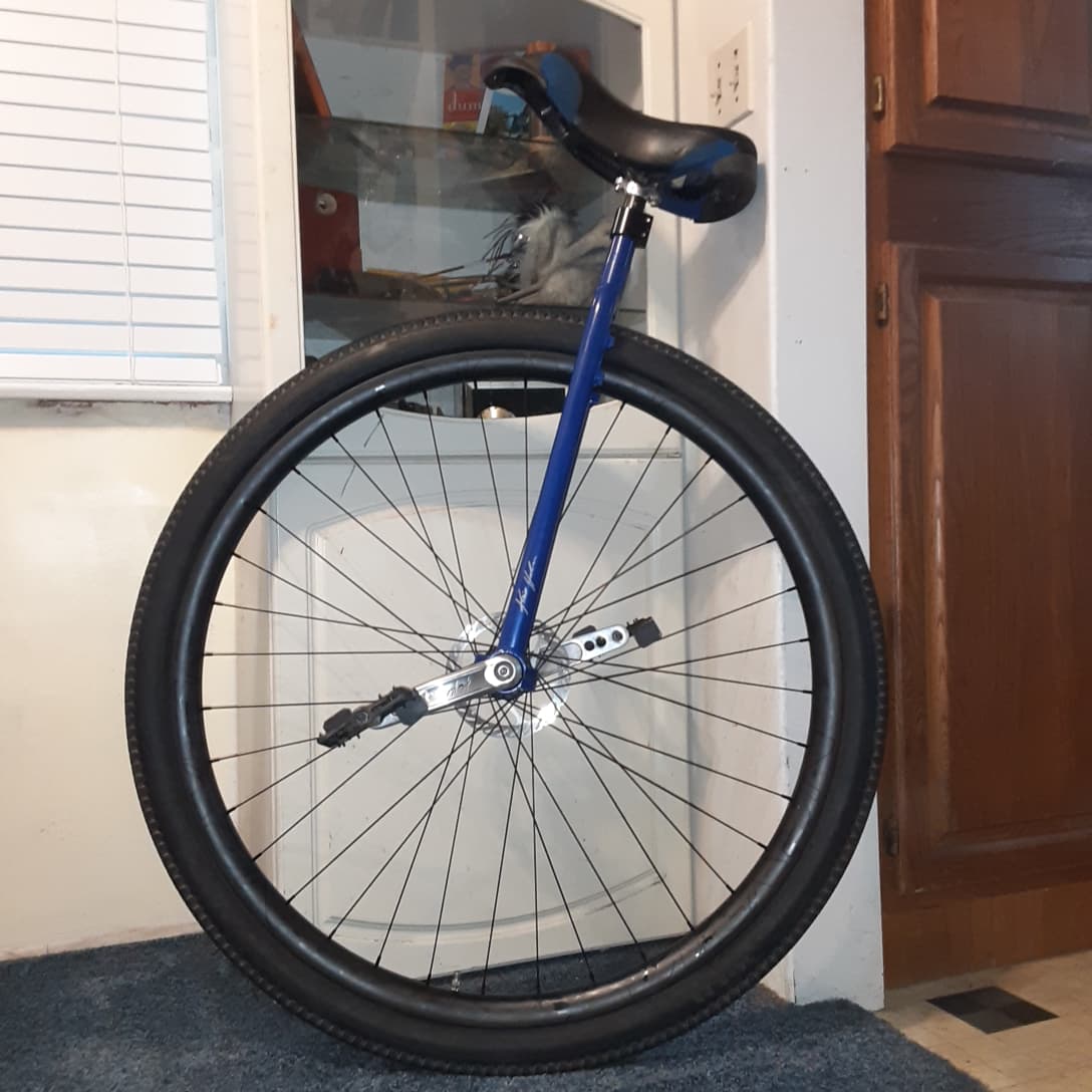

I remounted the NR with one of my last 36er tubes but this time inflated only to about 25psi, which for me is the ideal pressure for 36er MUni, and possibly even lower. I will be testing it on the trail soon and will report back with results. Hopefully we can still get some use from this rim, even if it’s only functional at low pressures.
Here’s a hop test at 18psi, which still felt firm, so I could easily lower the pressure even more without bottoming out. The main objective was to see if the bead would hold during significant compression at much lower psi, which it did. This successful test gives me hope this rim is likely suitable for 36er MUni. I tried to upload it directly but the file size limit is only 4mb, so here’s a YouTube link:

28.5 mile paved trail ride on the Nextie at 30psi today. Normal tire installation, bead seat at/before 30psi; subpar wheel build, even for me. I built up enough confidence to donut, speed, and hit some bumps. Am I ever so pleased with the whole thing? It’s more like my 29er than the KG/stealth2 I bought stock.
As a muni/low pressure rim it definitely seems like it has promise, just not at high pressures for either the hooked or hookless, at least not without the Vee tyre.
To my situation, it was a big improvement over the aluminum rim in acceleration and maneuverability. My memory won’t disagree with anyone who might will say lower pressures than 30psi go with the best pavement rides. What might likely be the condition for failure this way?
