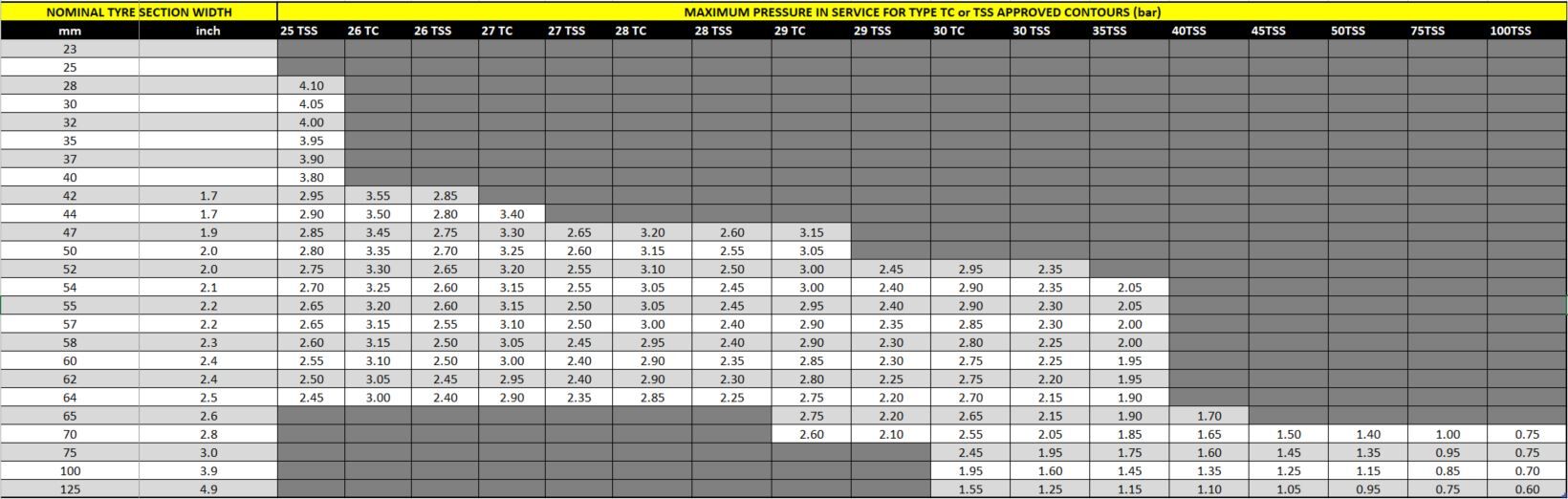

It’s not the holy bible, but I find the following table by mavic engineers to be an interesting insight into tyre and rim matching.
For my road use, I just feel that the rim width has an impact on the tyre profile. The wider the rim, the squarer the profile, the thinner the rim the rounder the profile. I have always had a preference for round profiles on the road.
I totally agree with you. I have tried to use a 2.5" Maxxis Grifter road tire on a KH Freeride rim - which is really large. That made a square tire that wasn’t able to turn sharply nor fast. I finally got back to a WTB Ranger Light 3" tire. It is way rounder and enables some sharp and fast turns.
So : use a thin rim if you like to turn. If you want to got straight and never turn, you can use a wide rim with a thin tire. :upside_down_face:
Stealth 2 36er rim and Nextie 36er rim are both 42mm wide. I have no turning issues with the Stealth.
Depends on the pressure and it seems you are riding at very very very hight pressure so this is normal you have no driveability issue
I wouldn’t say very high, for Road riding I usually run about 50 to 55 which is still 10 psi under the max. But the lower the pressure the more susceptible the tire is to camber.
Anything under about 40-45PSI would probably be considered to be unusually low with the NR Lite, whatever riding you’re doing.
The sidewalls start to get a bit too mushy for unicycling once you go below that (even as a pretty light rider myself).
The vast majority of 36" riders I know in France use pressures between 40 and 45 PSI (ok there is a bias, because I could suggest this range to them) for use on roads, towpaths, cycle routes… For my part (70+kg ~160 pounds fully equipped) on dry roads, I can go between 45 and 50 PSI, but never beyond.
And I know someone who rides mostly off-road @haut-pin, he may be able to confirm this but I think he’s more like 30 PSI.
According to my scale: 45-50 PSI is high, 50-55 PSI is very high, 55-60 PSI is very very high, and 60 PSI + is very very very high (at this pressure, I consider that the blow-out is imminent, I leave the room and put a noise-reduction helmet). :sweat_smile:
I’m more of a KG ultimate user, but I’ve also ridden a lot with the nightrider lite. I don’t think there is much difference between the two.
Hmm, max 40 PSI in the NR Lite for me (80kg). Any more and it gets unpleasantly bouncy on anything other than smooth surfaces.
I used to run the old NR at 50 PSI and didn’t notice any problems. I think the heavier sidewalls provided some damping.
definitely!
My NR Lite is at 45psi, just checked. Lower than this, I don’t like how it “folds” or “collapses” into a (sharp) turn. On the regular NR, I could go down to 3° without unpleasant reactions during turns.
I ride mainly in town with my 36", and I’m 75kg.
