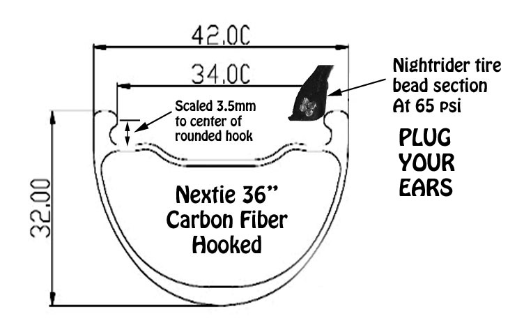

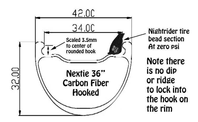

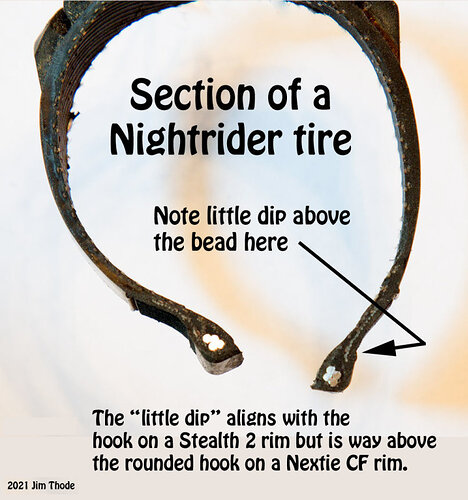

Declaimer: I am not a rim or tire designer but based on my seat of the pants calculations I believe that a 36” Nightrider tire will likely blow off a Nextie CF hooked or hookless rim when inflated to the rated pressure.
Based on the measured tire bead steel area and elasticity of steel I figure that the tire bead diameter will increase about 4mm when inflated. If that increased diameter is not uniform around the entire rim/tire I’d estimate that one part could easily push out 4mm and that would result in a tire blow off.

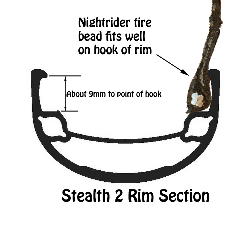

I believe that the Nextie CF rim section where the tire fits should be much deeper and have a hook similar to a Stealth 2 rim to be reliable.
What is the section of a Braus/Alchemist Carbon fiber 36" Rim? Is it deeper? Has anyone had a tire blow off of it as they have on a Nextie rim?
I would hate to see a bunch of people buy a rim that is not reliable. Is there a rim/tire designer here?

This looks like a design flaw/oversight on Nextie’s part for sure but we shall have to see what ends up happening when people start building these up.

On tyre design, my understanding of the tyre design is that the “dip or ridge” is simply due to the production of the tyre and doesn’t actually play into keeping the tyre on the rim in the way that you think. The bead itself pushes into the area below the bead hook and the bead hook will depress into the rubber above creating that dip.
I also suspect that the BSD is larger than what’s advertised (advertised for what tyres are designed to fit rather than the actual dimension), and outer diameter is larger then larger than expected from those images based on how difficult people found putting tyres on the hookless version.

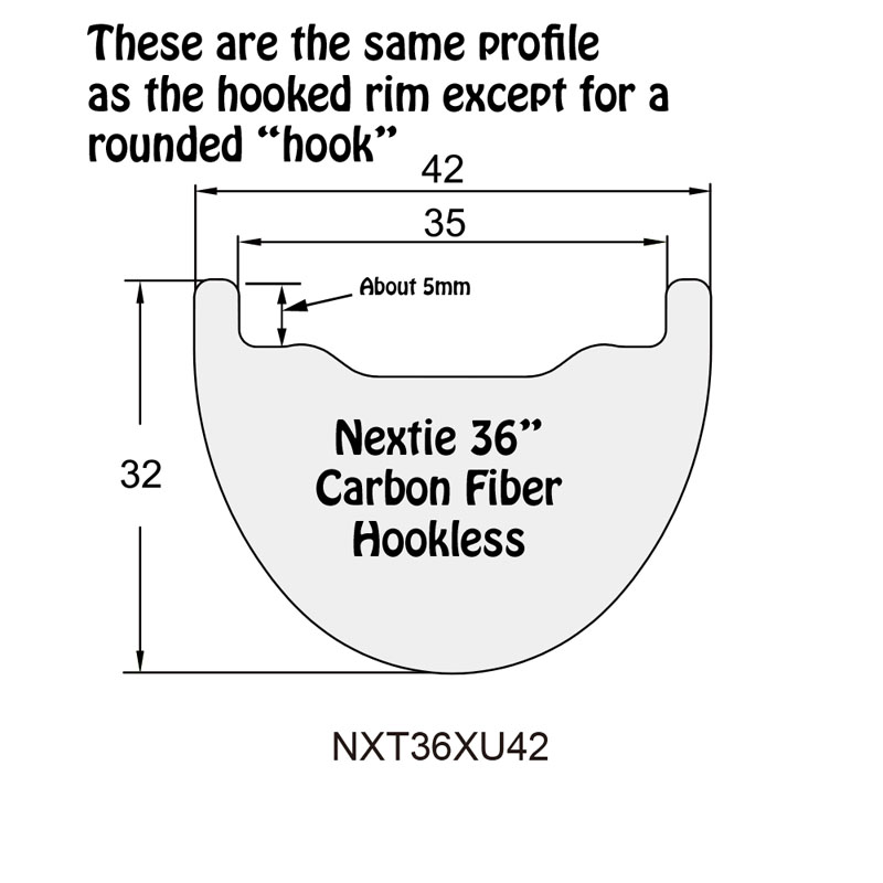

Yes, the Bead Seat Diameter (BSD) could be different then the Stealth 2 rim. However I do see that the advertised BSD of the Stealth 2 rim is listed at the same 787mm as the the CF rim. The other thing that will make a tire hard to mount is a shallower dip in the center of the rim. The CF rim has a much shallower dip in the center (compared to the height of the edges) then the Stealth 2 rim.

I have sent these pics to Alice along with our concerns about bead compatibility.
I think there is a lot of (interesting) speculation in this thread both about the hookless and the upcoming hooked version of the rim but only one actual example of a tire blowout on the hookless rim as experienced by @WeaponizedBacon with a tubeless setup.

Alice said she will show the rim comparisons to the engineers. Pretty sure that the actual steel bead is what hooks into the rim, and that the little indentation (dip) is created by pressure from the point on the hook and not built into the tire. My concern is that the walls between the hook of the nextie are only 3.5mm, but the bead height of the nightrider is well over 5mm.
I just got a rather odd and troubling email from Alice regarding the nextie rim/nightrider compatibility. She is still waiting for the engineer techs to get back to her but she added: “maybe you could find another brand of the tire to fit our Hooked 36-inch rim.”
My reply back was to say that most 36er riders, both for unis and bikes, use the nightrider tire, and I explained that all other brands, which are few, use wire beads that are pretty much the same. Bottom line is they have to make the rim to conform to the tire, not the other way around!
