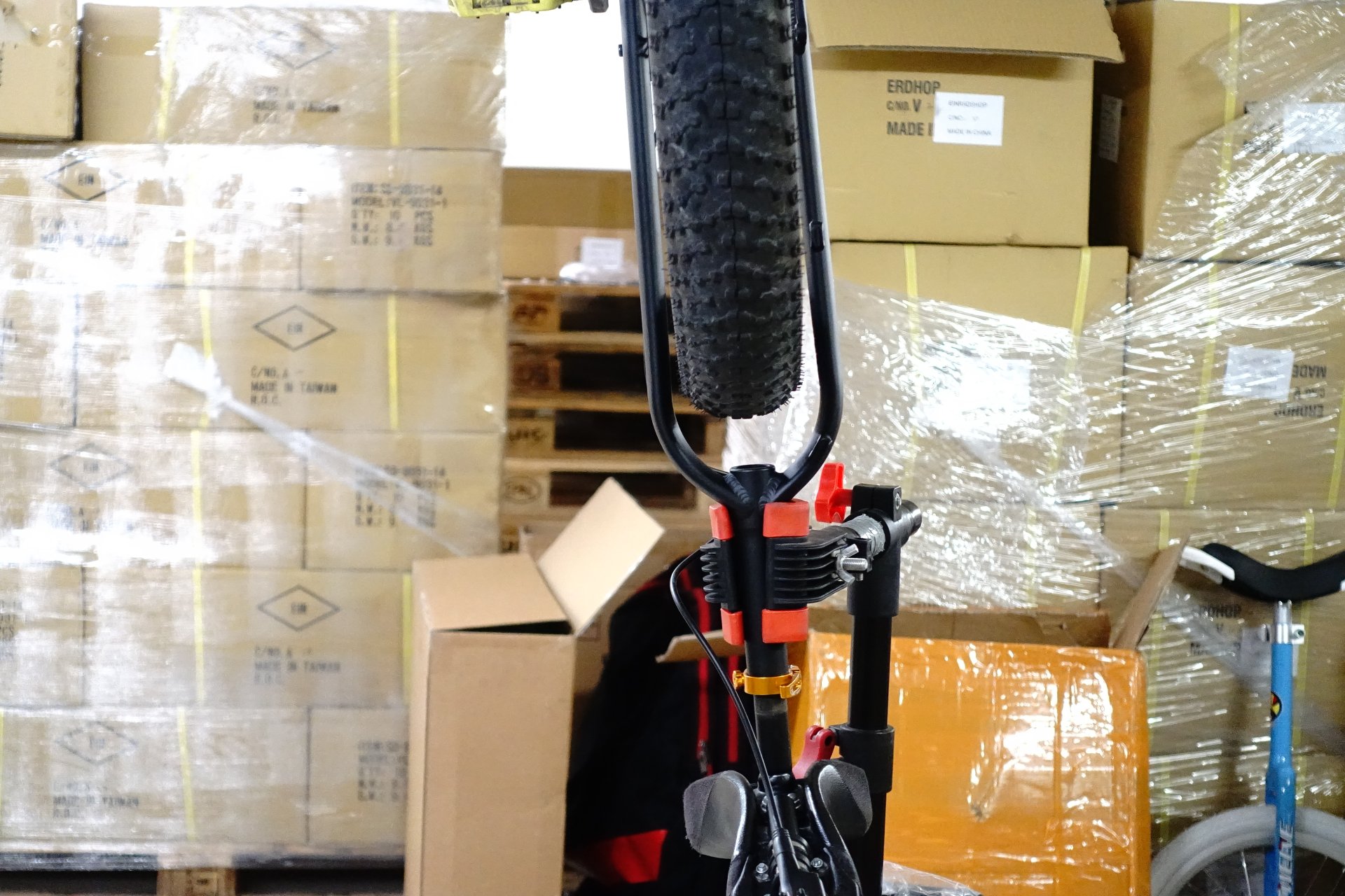

Somehow there seems to be a curse on the whole thing. It’s just unbelievable: This fork manufacturer told me that they produce for top brands that I don’t want to name here. I even sent them my two disc hubs to make sure that everything would fit with the fork samples. Unfortunately, the reality is completely different: The wheel is not centered on all 3 forks and the bearing shells at the bottom are not welded straight, in some cases you can clearly see this with the naked eye. The disc mounts also don’t seem to be welded on correctly: Unfortunately, I couldn’t test a single fork because you can’t get the brake to grind free. It’s really sickening. Above all, I wonder how a company that apparently produces good, precise forks can deliver such rubbish to me (for the 2nd time, because I had a sample fork made during the Corona period). Back to square one. There will probably be nothing with these forks in 2024. I hope my 4th attempt for aluminum forks works :frowning:

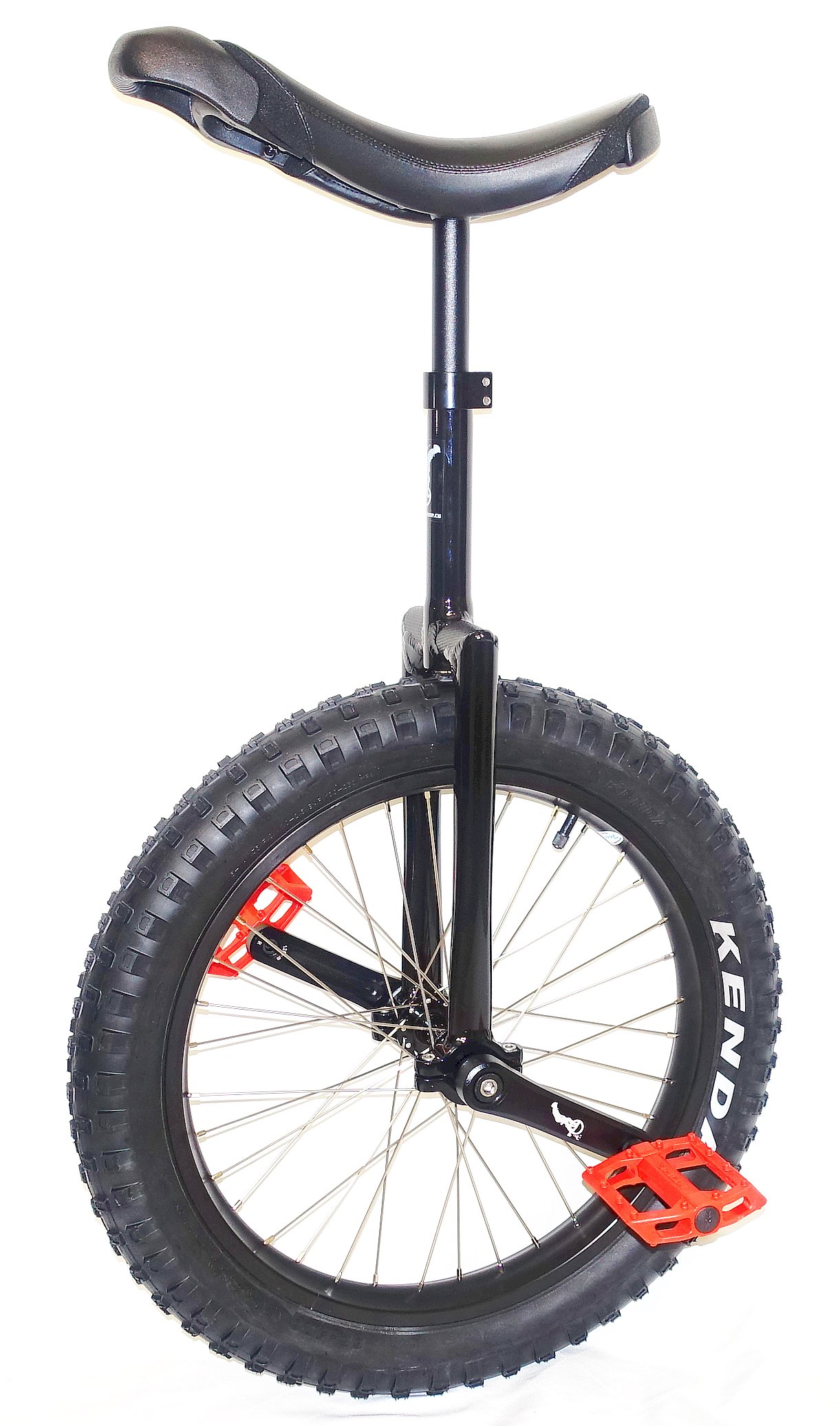

New model
heureka rot-4
hand-spoked in Switzerland.
With 20x 2.6" tires and TPU tube.
Weight: From 4.2kg
The photos always look a bit unprofessional, I know :wink: I don’t have the money and space for a professional Photo Studio.
