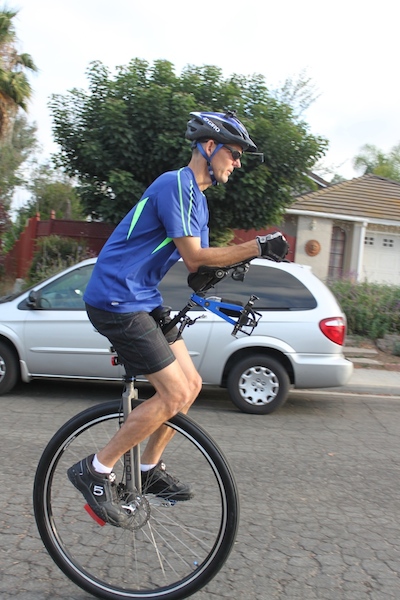

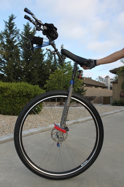

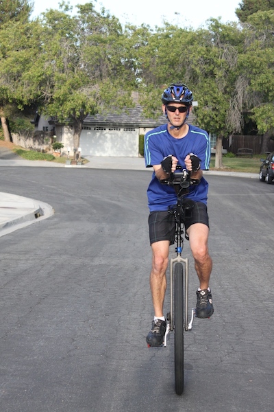

My “Zero setup” is on the 8. page in this thread.
Just checked your set up and I think your bars are too high for the Zero. I would suggest that you lower them so that they are set lower than the saddle.
Use that as a starting point and negotiate from there and experiment with the reach (T bar length) as well.
I reckon that this will make a big improvement for your comfort.

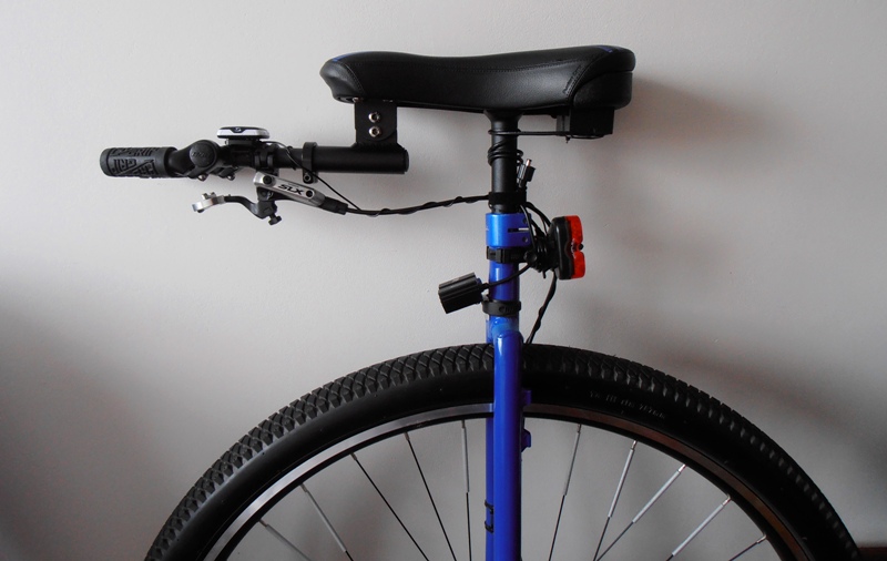

This is my new setup. I will try it tomorow. I´ll write a little review after ride. :wink:
Hello M.M. I look forward to your review. Remember to bring your Allen key so that you can make some adjustments during your trip.
