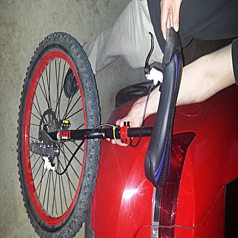

    First ride impressions
    Okay I realize my last few posts have sounded like total fanboyism. So I digress let me calm down and write a real review.
    I went on a 5 mile ride through the street with this saddle with the rear angled all the way down.
    Pros:
    1. Q-factor felt more natural
    2. Comfort of the boys, (Happy to no longer be jeopardize my future kids)
    3. Looks sleek and different
    4. Easy to install
    5. Once riding technique adjusted I found it to be very comfortable
    Cons:
    1. Seems to need bike shorts with padding at least in the beginning to get used to the firmness of the saddle.
    2. I noticed that even on a small drop I had control issues with the saddle (This may be due to the reduced size in which case a simple technique change is required)
    I will post more after first muni ride.
    Ok i tried the saddle on my 29 inch light weight muni and did a 2 hour ride.
    The control problems are almost gone.
    I think it is because speed is lower with this unicycle no need for me to stay in the saddle al the time.
    The angle of my seat is no pivotal ridge visible.
    After 1,5 hour i starting getting a sore butt still completed the ride.
    When the foam start to break in i think am going to try it again on my 36 inch.
