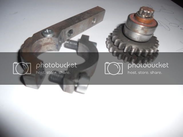

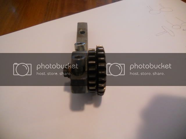

Hey Magnustudios I’m thrilled you are going to build a gear driven unicycle,I still plan to have another attempt myself when time is available.You have mentioned some of the requirements to resist the forces that will be encountered like beefy axle and mounting methods.I think my method may have worked if the jack shaft had been supported on both ends rather than a cantilever this may be done by a floating bearing plate,linking the main axle to the jack shaft axle end(inboard side) If you can make the idea work and had the choice of interchangeable gear cogs it would be very good.I’ve put a few of my old photos and vid on photobucket http://s255.photobucket.com/albums/hh155/dangerdog_photo/Failed%20geared%20uni%20project/it shows some desperate bracing of the unicycle frame to try and resist the torque forces.

John, thanks so much for those photos and the video! Very helpful. You were on my list of people to contact with questions, I might have lots more. I plan on using a cantilevered spindle for the gears as you did, but a thick one, maybe 1/2" diameter. I was thinking about the interface between pedals and cranks: it is very strong, holds up to a lot of torque, and is quite long, yet the cantilever holds up. My dream hub/frame setup would be a plate in the middle of a V-frame with multiple threaded holes for different intermediate gear sets. Change gears with just a hex key! The fact that bracing the frame as you did wasn’t enough to make it work makes me nervous. Do you know what part was bending? Now you’re thinking of supporting the jack-shaft axle at each ends: does that mean you thought it was that shaft which was bending? How did the gears go on the jack-shaft? Did the shaft rotate or was it fixed? Did you use bearings or bushings? Sorry, lots of questions!

The problem with my design was the gears want to separate under torque unlike a chain and sprocket which try to compress together.So the parallel distance between the two shafts tries to grow or tries to go out of parallel.Looking down at the two axis when applying torque one axis tries to twist forward and the other backwards,this problem I tried to overcome with the additional frame bracing which helped a lot.So with the additional frame bracing in place the focus of failure became the distance growing between the two axis.The play that caused the failure was the crank axle and bearing housing ,slight twisting in the 12mm plate between the bearing housing and the jack shaft mount,slight twisting in both the jack shaft and the jack shaft bearing holder.I would guess if my design was about twice as stiff it would have been successful.I used bearings for everything that moved and the jack shaft was 10mm dia and was welded to the gear cogs.
