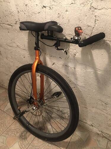

M4O Muni L frame is just fine with The Nimbus grey rim + NightRider tyre, this is my set up
Not at the moment, but I will look at this as an option
That looks pretty close near the crown - is it as much as 5mm? I’m wondering how much bigger the diameter of the Aspen would be.
Here’s a thought - have you ever (or could you sometime) measured the circumference of your wheel by rolling it along the ground (at working pressure but no need for load) and measuring the distance travelled for one revolution? Then if @mowcius would be kind enough to do the same with the Aspen tyre we would have comparable circumference measurements for the two tyres, from which we could derive the actual radius of a pumped up tyre. I can’t see that the rim choice will make much difference unless they are very different widths (and your rims are both the same anyway).
Working the other way around, the Muni L apparently has a measurement of 409mm from centre of bearing / axle to bottom of neck, so in theory (admittedly only allowing 1mm gap from top of tyre to bottom of neck) a tyre with a rolling circumference of 2 x π x 408mm = 2563.5mm would fit, just.
The M4O frame has a cap underneath the seat post tube, and you need to remove it to fit the 32” tire. It’s that close to the frame.

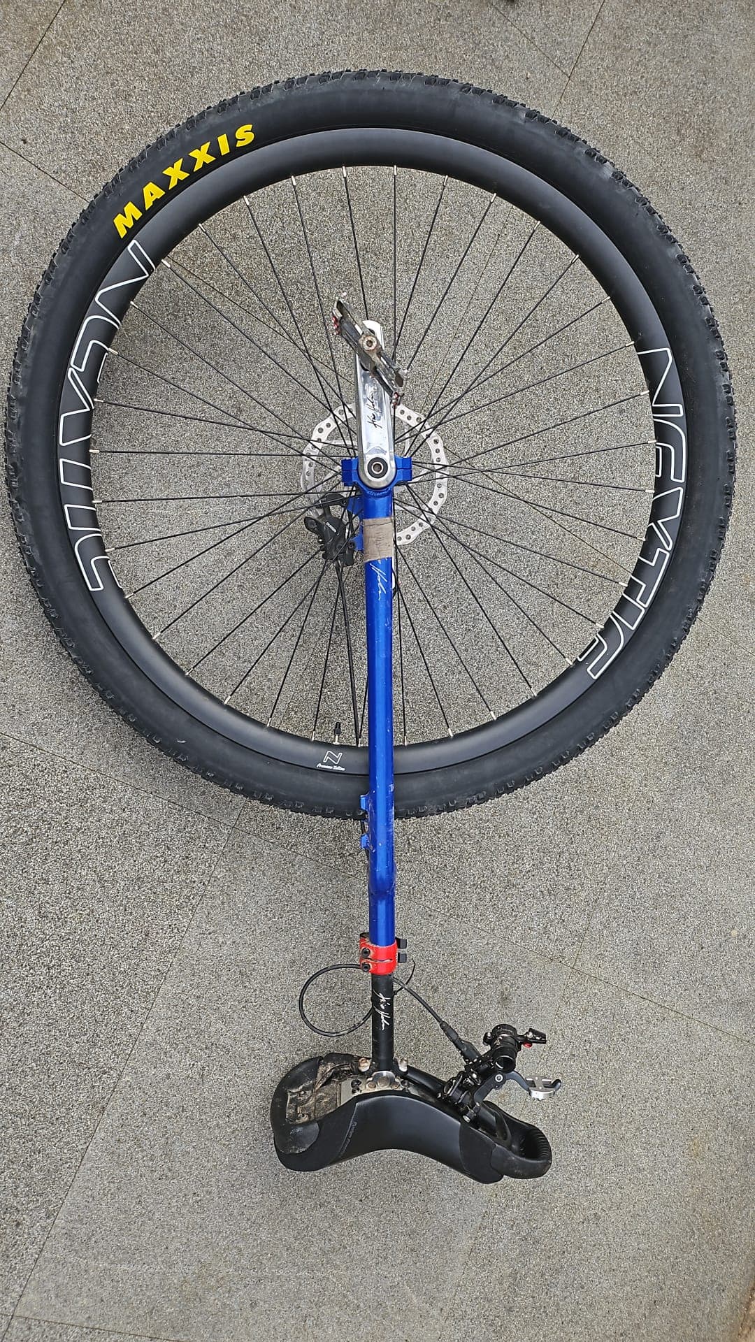

Aspen 32” on Nextie carbon rim, photo from @acl

Do you know if that’s the hookless or hooked rim?
They only make one 32” carbon rim, a hooked variant.
First impressions after about 20 miles on that Nextie rim….
  • Noticeably lighter, I mean noticeably
  • At 35psi (I had the NR at 40) it’s quite skittish and slippy on corners, but fine at 30psi
  • Camber issues that seemed to be making life progressively harder on the NR (to the point that I was mostly riding an inferior 29er instead!) are just gone, handling is generally excellent
  • Very fast rolling
  • My only worry is puncture resistance…there’s not a lot of thickness there, the NR was good at catching sharp stones between the tread before they got to the fabric, that won’t happen here
  • Just maybe (??) some issues at a particular angle of lean when the current knobbles catch? But not often enough to be sure, I may be imagining that.
I’m mostly doing light XC and it’s a massive improvement. Amazing to think the NR was a big improvement on the Kent tyre before….
