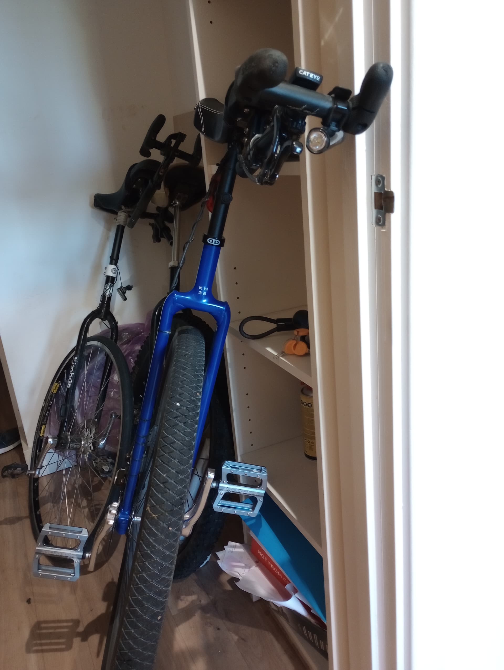

It doesn’t look all that odd

There’s nothing wrong putting a 32 in a 36 frame. It looks absolutely fine and the extra crown gap makes for a great carry handle.
