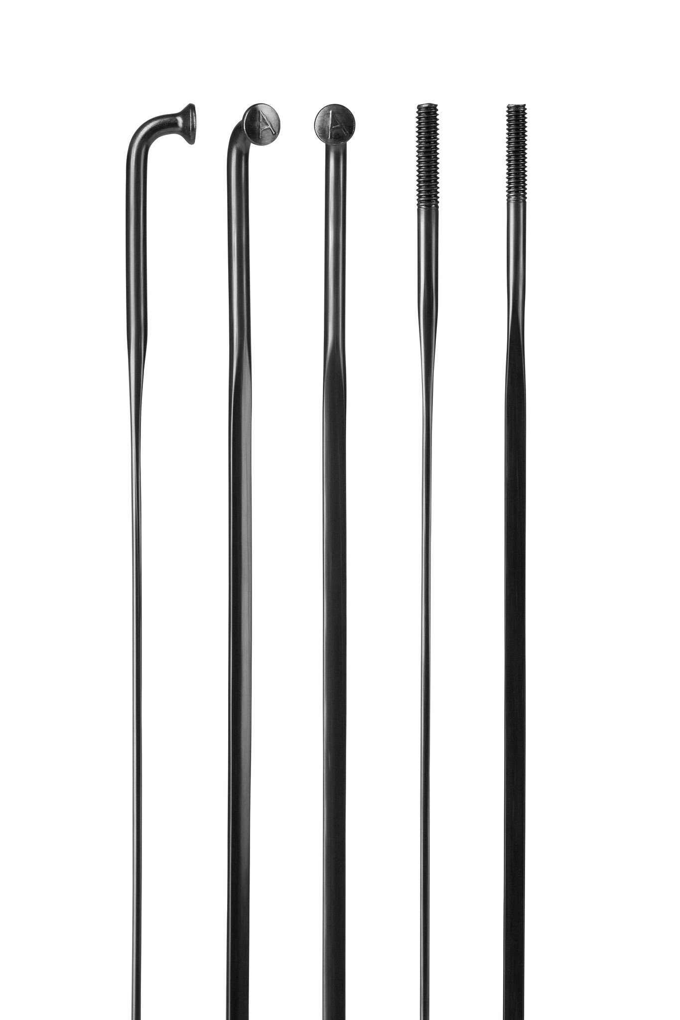

I got some email this morning about these spokes being available for 32” wheels – from my understanding it is best to use double butted spokes for carbon rims, so these should address that requirement.
Ooooh. Shame they didn’t go slightly longer so we could also install them on a 36” as well.
When I upgrade to a carbon rim on the 32” maybe I’ll pick up some of these.

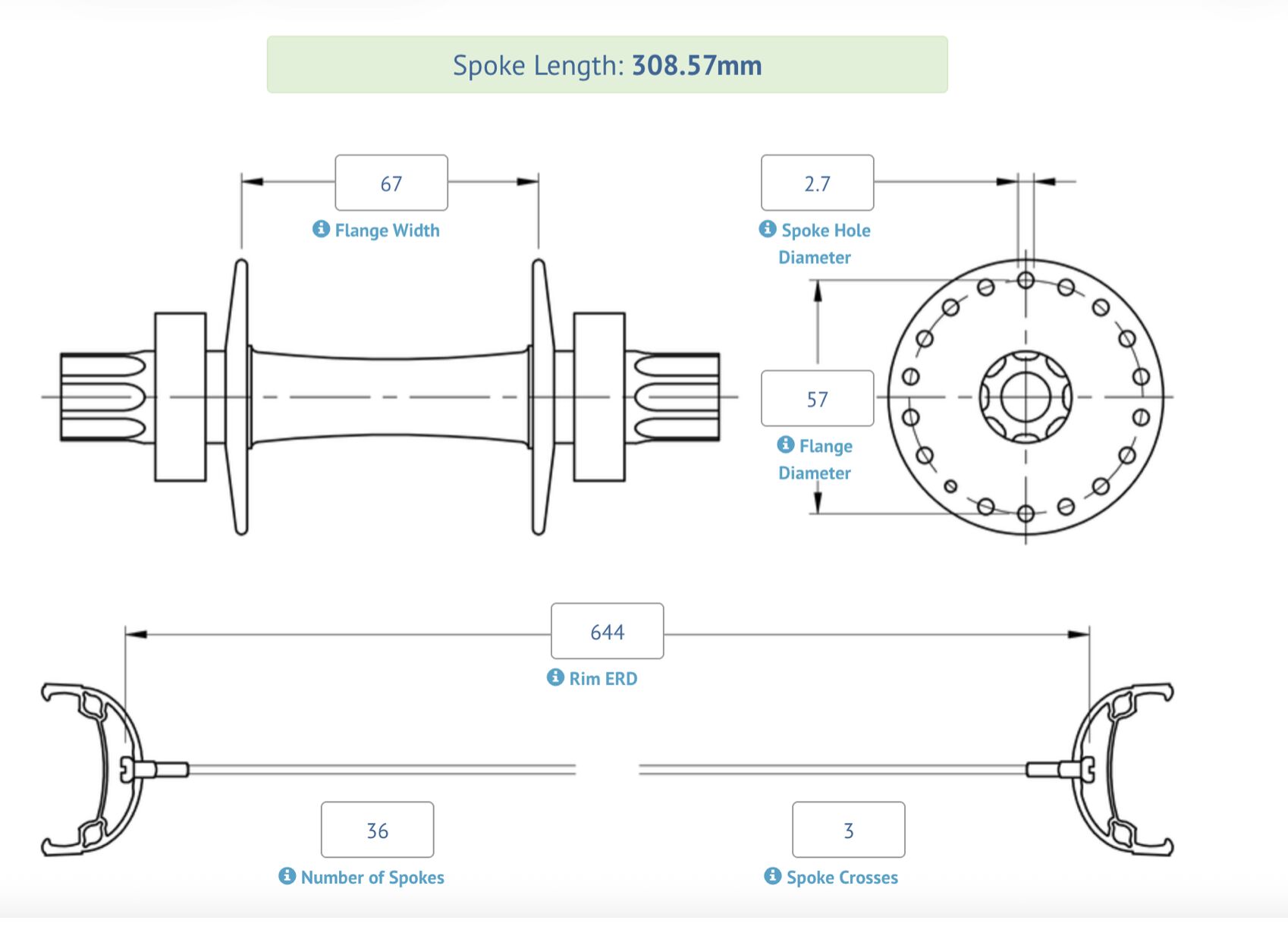

Based on my calculations unless you were running a hub motor on a bike the standard length versions would not be long enough for any hubs at 3 cross, so hopefully they’re going to ship you some blanks well in excess of what’s required.

The PSR14 is plain gauge, so not butted. They do double, triple and quadruple butted spokes though – I didn’t look at any lengths. Quadruple butted seems quite exotic.

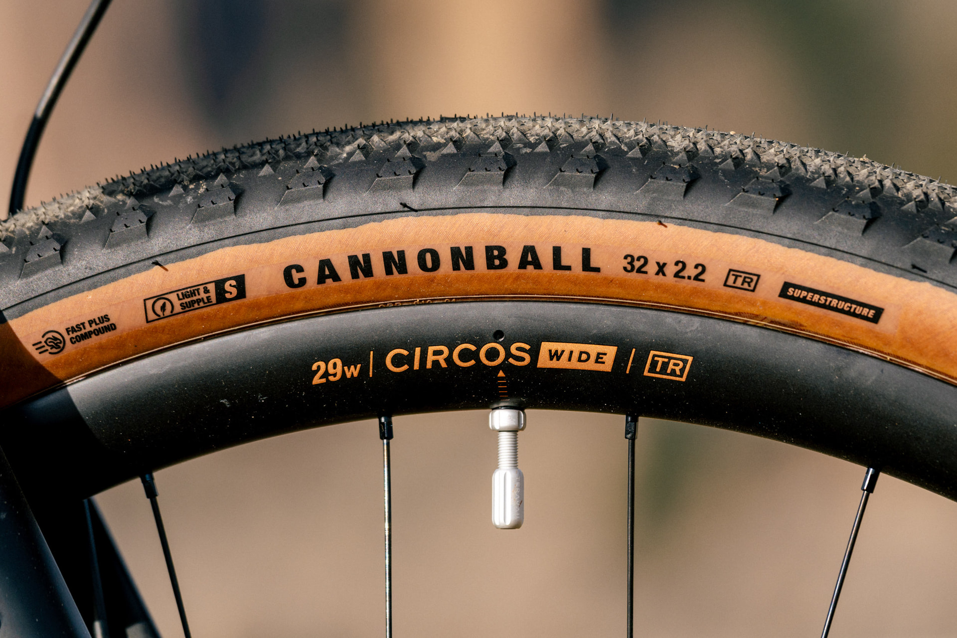

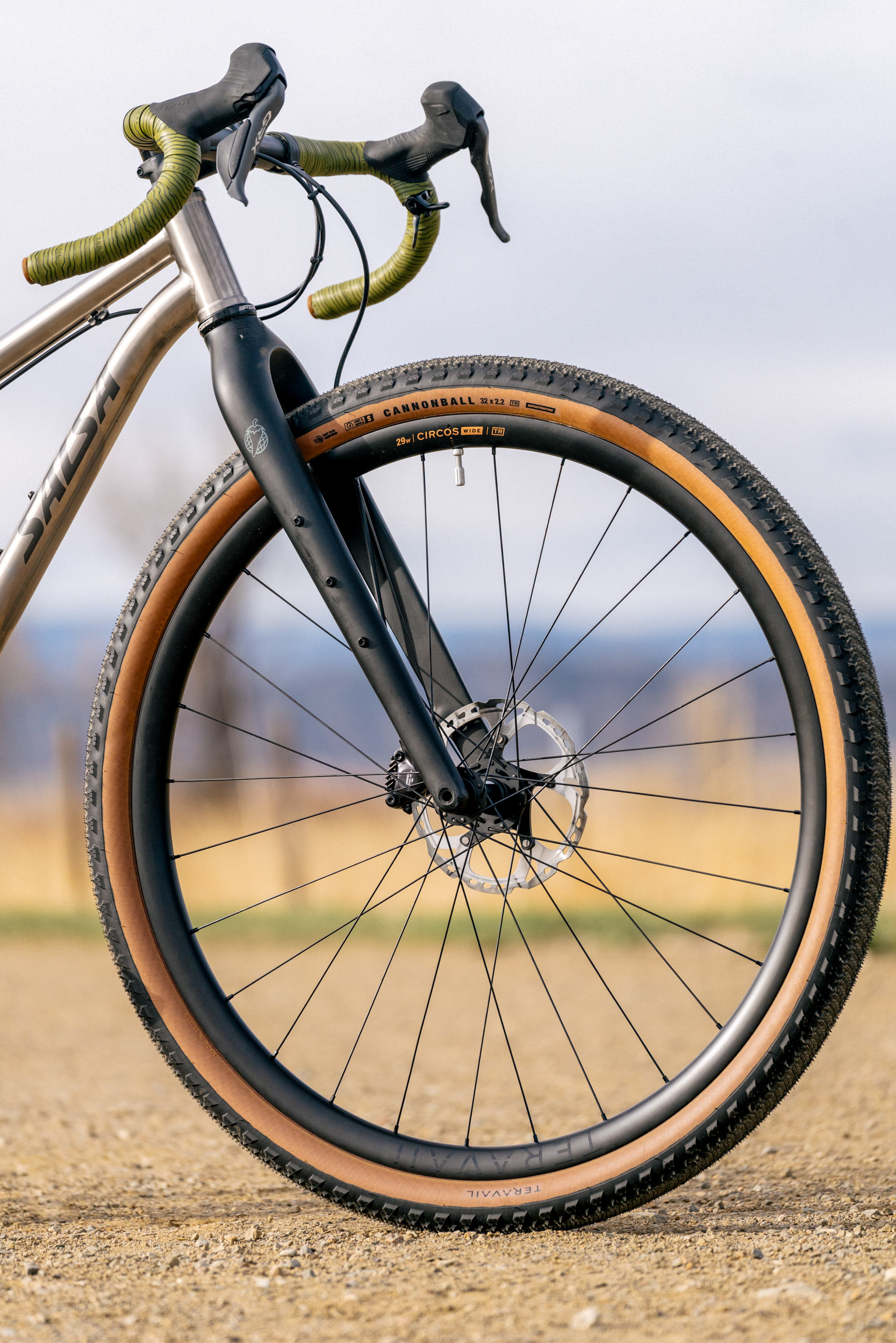

Seeing on this video:
Mention of and showing a Terevail Cannonball tyre 2.2” ![]()
Don’t think that’s been mentioned before:
Extra details are here:
This looks to be a Terevail branded rim too.

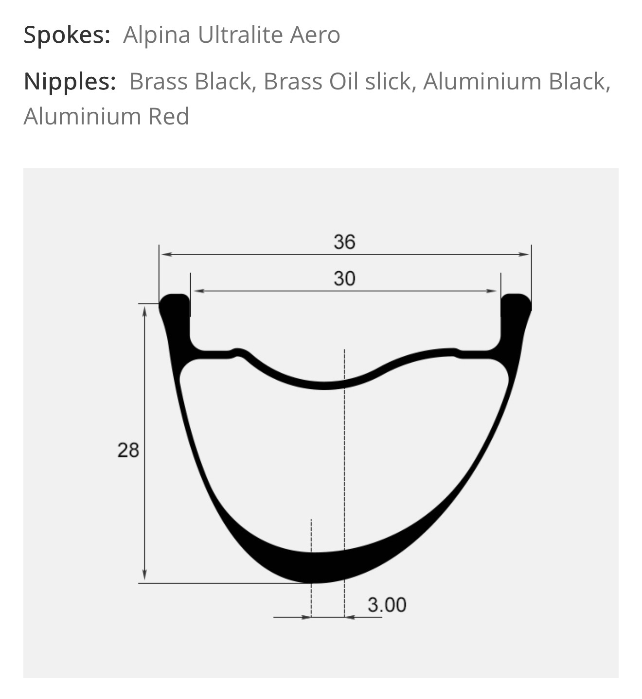

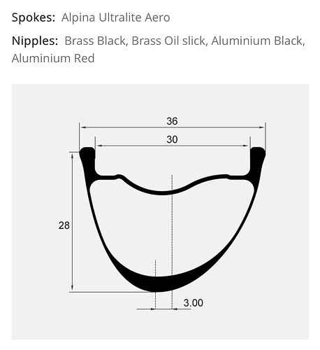

Also of note - Berd are now offering their own 32” wheels and the cross section of their rim looks somewhat akin to the LightBicycle offering -
Berd:
LB:
Similar but not the same I’d say.
