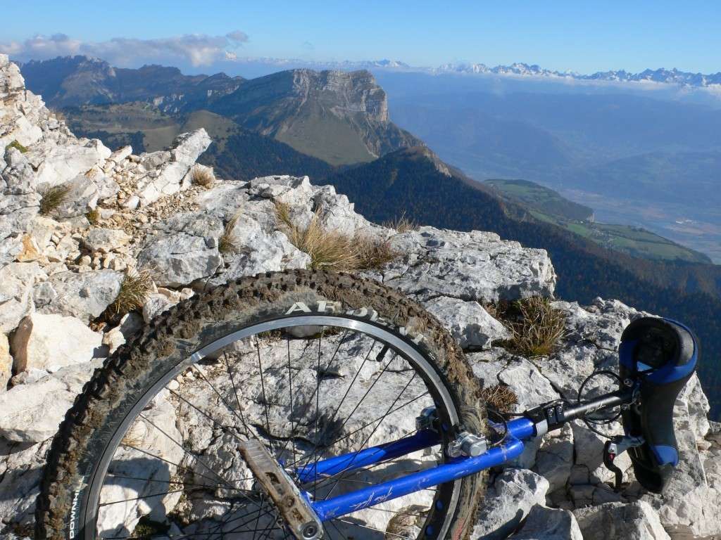

A few pics to illustrate my choice :
Nice mud!
