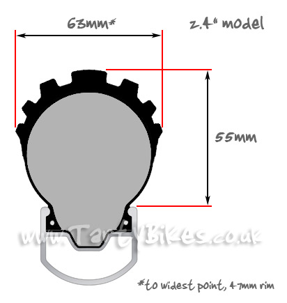

An other fantastic improvement will be to buy one Schwalbe Big Betty.
I begun muni with a lent 24" duro what make me choose to purchase a 26" with an other tire" !
Big Betty is far lighter, roll better, clean mud faster, better on wet rocks… I use one in 24" and one in 26" !
Marked 2.4" in spite of marked 3" for the duro but look at the real
measurements :
source tartybikes
