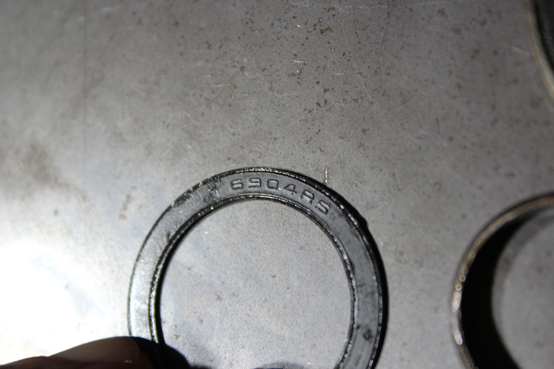

Found someone that was able to pull apart the hub for me and he’s found that left inner bearing is sized 22 x 37 x 9mm (ID, OD, width. However he has mentioned some problems with the right inner bearing too.
“The outer bearing on the right side is also failed - the inner race has split in 2. The rubber seals are still intact, and they bear the part number 6904-RS, that references to a 20x37x9mm bearing. This won’t fit as the shaft it runs on is 22mm diameter. I wonder if Florian had these bearing specially modified. The big outer bearing on this side feels pretty rough too.”

You can sometimes find modified bearings like this if you search “6904-22 2RS” (or any other combination of the designation of the standard bearing with the modified dimension).
Not sure how much use a German seller is for you, but a bearing specialist near you may have those, as it’s seems a few bike manufacturers also use that size.

Ended up ordering the following from from a local supplier
2x Bearing MR 22379 ABEC 3 22x37x9
2x Bearing 6808-2RS Single Row Metric
I have since retrieved my guni and it’s functional. Took it for a test ride this morning and changed gears up/down and seemed to handle ok. It does feel different to before I guess it’s because it has 4 new bearings. Will have a couple more rides this week to see how I go but I’m confident that’s it’s fixed.
