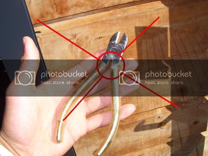

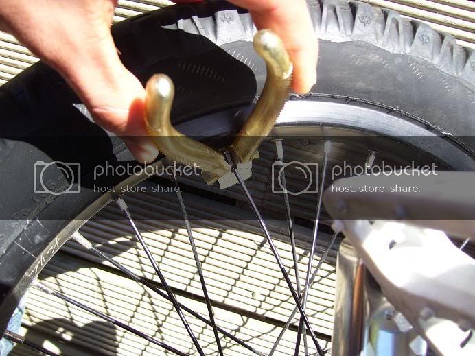

First off, you dont need a spoke key or the pain of taking your uni apart then using a screw driver. IF!!! you have one of these…
Hopefully you have a tool like that, I don’t know about everyone else but I’ve got them all over the place.
