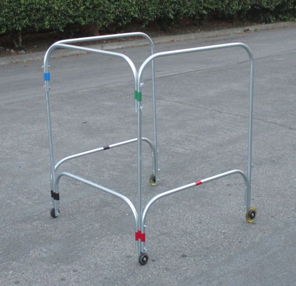

I finished my trainer just now. Now to start working on riding backwards…
#SPORK I LOVE your trainer! Looks really light and I like the wing-nut fasteners.
For me, I really like having the wheels caster - you can quickly center yourself in the rig right - to - left to regain balance and turning pivoting is easier when you can pivot the whole rig with you in the center.
Nice job!
Thanks Siameez. I debated whether castering wheels would be better or worse. For some reason I thought it would be better to have them not caster. The unit is light enough to pick up and reposition easily, but with your experience maybe I’ll go ahead and change mine to caster.
I’ve used the rolling trainer now for the past couple of days. I think it’s really helpful for learning to ride backwards and idle (we’ll see). But I think you were right about castoring wheels. I don’t think the non-castoring wheels are holding me back, but I can see where castoring wheels would be better.

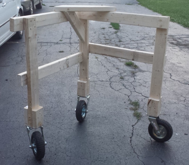

My latest iteration… This one is lighter and more nimble… I think I’d like to put smaller wheels as these 8" wheels have too large a swivel radius and smaller wheels would swivel in a shorter distance…

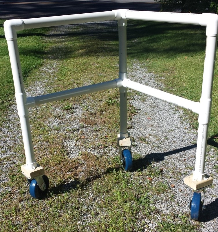

Version 3
New Casters. Hard rubber wheels. Much better swivel bearings, shorter swivel radius. Works great! More responsive than the wooden-framed soft rubber-wheeled versions.
PVC fittings ordered from Home Depot.
Caster Wheels: Harbor Freight
