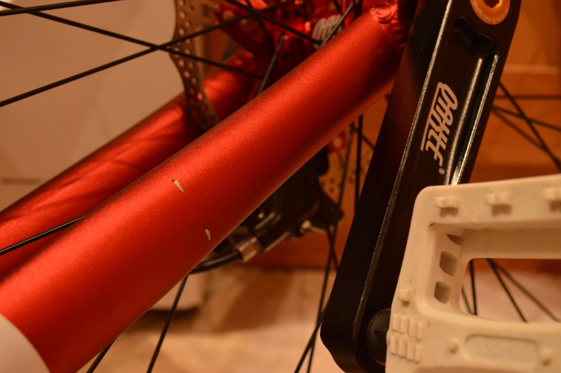

  • Secondly the zero Q cranks and the space in between them and the frame is pretty small. Now I understand that their goal here was to have a super narrow setup, but having ~4mm between the frame and cranks (145s - on a related note UDC, your page for the 27.5 says 137s on the spec and 145s in the description - I was rather expecting 137s!) seemed a bit small. This issue then revealed its ugly head on my second ride out with the dog where I fell off the thing (still training the dog - he went for a sprint) and apparently put enough force on something for the frame and crank to smash into one another.
    Getting home I presumed that I had done something wrong with the setup, but I couldn’t find anything. The bearing holders were tight (if anything erring on too tight), and the cranks were tight onto the splines, bottoming out on the spacers with the caps properly locked in as they’re meant to be. I’m doubtful this is user error but I’m open to the possibility if anyone has any ideas, especially as this is my first Q-Axle unicycle.
    I also a bit over 60kg so if I’ve somehow managed to do this while having a UPD onto my feet on a flat grass field then it doesn’t seem impossible for others to have this issue.

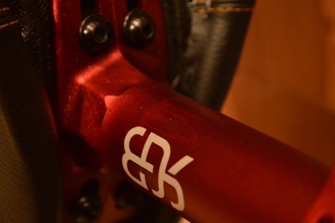

    -The anodising on the seat post is weirdly uneven. It’s all been blasted in some manner for the matte finish, but there are streaky lines near the top that again I just didn’t expect. If it was a discolouration in a paint finish, it probably wouldn’t/shouldn’t have passed QC.

A picture of the crank-frame collision aftermath:
and the seat post anodising weirdness (it’s like this all of the way around):

I suspect in this case I may just have been unbelievably unlucky when I had my UPD as the marks on the frame suggest that the crank was also perfectly inline with the frame leg.

So on the frame-crank collision I’m still having a hard time believing it myself!
Putting it on the floor and applying a moderate amount of pressure, it’s definitely not out of the question that it could happen during a fall (flex wise), but just the fact that the stars seemingly all aligned is hopefully the worst luck I’ll have this year.
With 137s it would be even more unlikely as the frame obviously flexes out more as you go up it.
The spacers are definitely there and correct (I believe they only supply one length - they’re stock as Qu-Ax supplies).

The crank-frame issue I think I can only put down to bad luck. The zero-q side of things definitely has its advantages, and without widening the whole stance (or having more than one model of frame), it was always going to be close here in order to support the width of tyre that you can get in an RGB.

Insane the crank touched the frame. Is the frame that flexible?
I’ve been pondering getting a 27.5 RGB for a while but that puts me off.
I definitely wouldn’t call it flexible, but there is some flex like all frames. Most unicycles however don’t have the end of the crank within a distance of a few mm of the frame.
It also does seem like I’m the first person to do such a thing…
