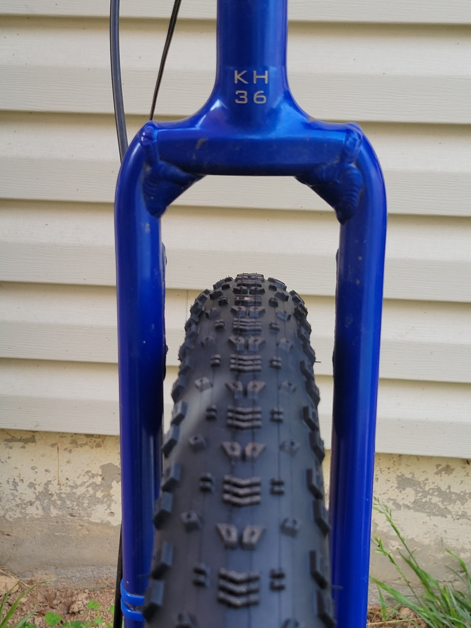

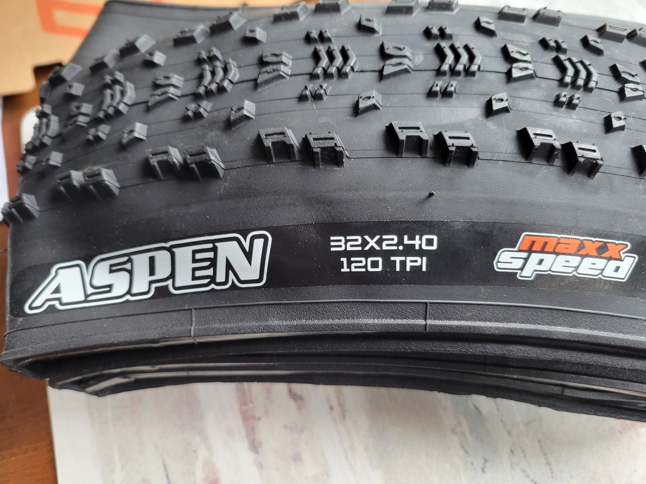

Enter 2026 and the 32" Maxxis Aspen - an early entry in the high quality Kevlar bead tubeless ready 32" tire market. So I decided to build a 32" wheel and use it in my KH36 frame, swapping between the two wheel sizes. I bought the tire first: 2.4 MaxxSpeed, EXO. It weighs 847 grams. Now I need a rim. Because this is going in a 2017 KH 36 frame with Spirit outboard disc cranks, I wanted a symmetrical rim and out of the ones available in late May 2026 the only offering was the BTLOS so that’s what I got, Extralight and hooked version.

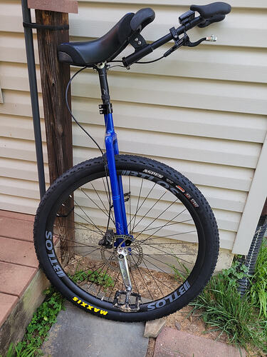

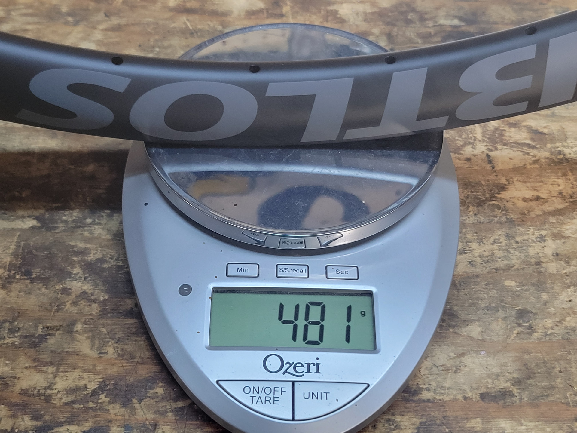

After the rim arrived I weighed it at 481 grams. I had the spokes from the Nextie 36" build cut to proper length for the BTLOS. I laced it 3-cross with trailing spokes (from a pedaling perspective) elbows in (heads out) for a more direct line to the nipples. I used VeloFuze brass washers between the spoke head and flange. I ordered a Tubolito 32" TPU tube but it wouldn’t arrive for a couple weeks so I used a stretched 29" butyl tube in the mean time.
First impressions: wow! this wheel is really light. Two things are noticeable: little to no “flywheel effect” but it is very easy to accelerate/decelerate - think half-revs going up a steep hill. Second ride was 7.4 miles on familiar muni trail that I ride the 36er on. I was able to clear many more sections on the 32 than on the 36 which I guess is expected. It is very easy to maneuver around/over obstacles. Plenty of frame clearance with that tire/rim combo in the KH 36" frame.

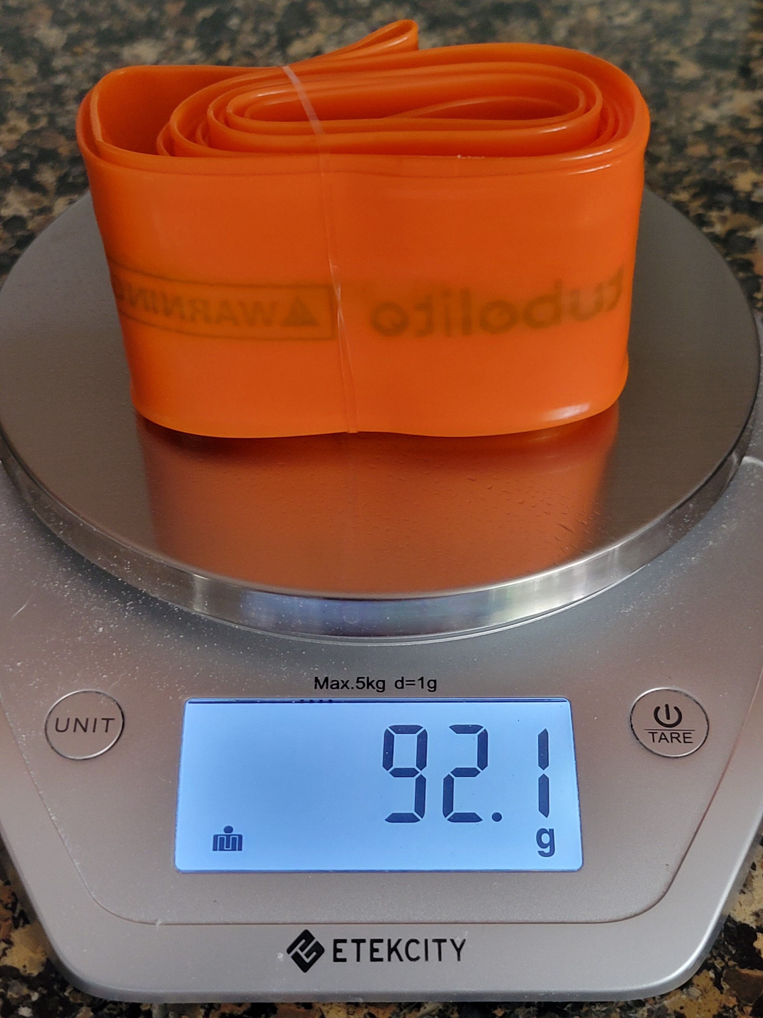

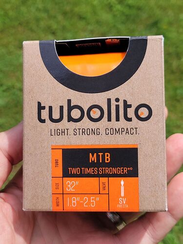

Mr. Tubolito arrived earlier than expected :slightly_smiling_face:
It’s a svelte 92.1 grams. I had no issues inflating it to round, about 2-3psi, but first making sure the valve stem was pointing inward. I left the Maxxis Aspen outside in 85F temp so it was flexible and supple thereby making it easier to mount. I inflated it with a floor pump rather slowly as I’ve heard that’s preferred for a TPU tube’s first inflation. Got it up to 25psi where it will remain until my next muni which should be in a couple days.
Tubolito’s website does not make it obvious they offer a 32" TPU tube. You have to click on MTB → Tubo MTB → then select size 32.

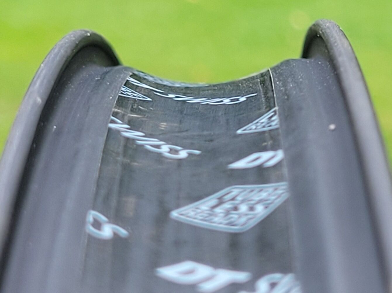

Oh, and I realized I didn’t post a pic of the profile of the hooked rim so here it is:
