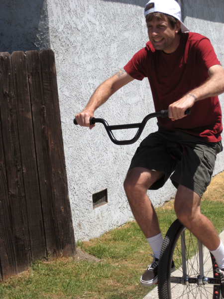

  1. Has anyone tried a wider BMXish style bar? Pics?
  2. Any thoughts on the benefits / disadvantages?
I feel the wider position would be awesome to torque up a hill for example, standing and pulling up on the opposite bar, like a BMX bike.

Most who use handlebars are either road riders or XCers. The bar is mostly used transfering weight off the seat.
There is little need for lateral leverage and if you have a large bar you are more likely to get tangled w/ it in a UPD.
There are a couple of people who have use a moderately sized bar for Muni that I can think of off the top of my head (corbin & turtle).

The wide bars may help power regardless of your technique. However, I have skinny handlebars on my uni to rest, or shift weight, or mount stuff. Most importantly, the bar must pass through my legs if I were to come off the front. I think a wide bar will trip you up on a UPD, by snagging one or both legs by the ankle and catapult you straight into the ground. I wouldn’t want wide bars for MUni or Flatland because of the need to bail. I blame handlebars for not always landing on my feet in a mountain bike crash.

http://host.madison.com/image_6db60f8e-0620-11df-be3f-001cc4c03286.html
Thats an interesting set of bars, but if you get a real supprise UPD as happens sometimes and get your legs trapped under the bars your going to end up with missing skin or worse: :astonished: You are creating the same danger that existed with the penny farthing :thinking:
