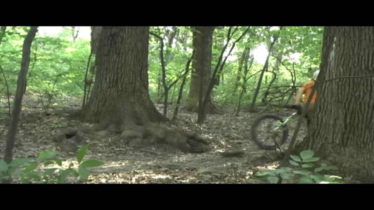

hey guys, i got a new camcorder and I made my first muni movie,

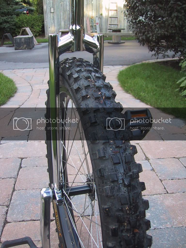

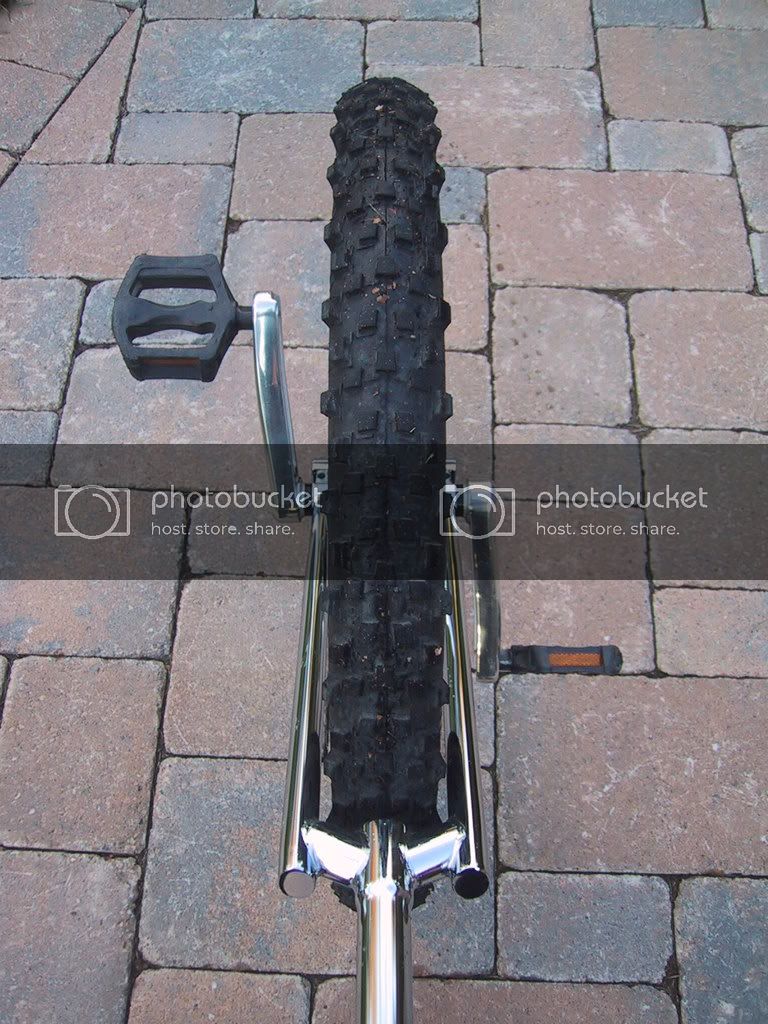

I have a question:
On my Muni, I have a Duro Wildlife Leopard 3" Tire, on it, but…It doesn’t seem like 3", my Maxxis CC, Try-All, and Luna seem like the same width. I’m not sure why. Could someone take a rear view photo of their 24" Muni tire ? Not that this is an issue, but I always expected a Muni tire to seem just extra wide.
Thanks !
-Isaac
Duro
The Duro is 3" wide. It is an optical illusion becuause the 19" tires are so much smaller it looks as if they are wider.
Unicorn
Tyre sizes vary a lot even within a stated tyre size and what is written on the tyre’s sidewall has to be taken with a grain of salt. Gazzaloddi 24x3" tyres are definitely wider than Duro 24x3" tyres. The width of your rim also affects how wide a tyre actually is. The wider the rim the wider the tyre will spread. Taken to the extreme a Large Marge rim will make a Duro 24x3" much wider than on a KH rim for example.
Okay, thanks.
Here are some pics of my Duro 3" in the Nimbus ll frame.
But thanks alot guys, it was helpful to know.
-Isaac
Also on many tires the width marked on the side is optimistic. The Gaz is the only “3 inch” tire that really gets close to that number.

I thought it played very well to a non-uni audience, though only the first 10 minutes loaded for me. Except for your problem with encoding/interlacing, which left everyone all jaggy.
