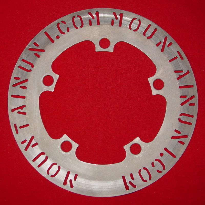

What would you think of having the braking track vented something like this
Then have your name laser etched on the wider part near the connection to the crank.
Personally i prefer the look of the triple row of holes.

We are currently exploring aesthetics for marketing
