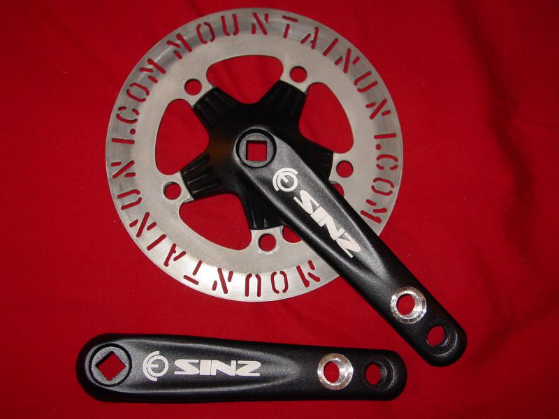

this is what they look like from the machinist, from the manufacturer, the holes would be powder coated too. I just wonder if we should sell all the sizes of Sinz, or all dual hole, and if all dual holes we offer just be 150/125.
with the disk…
Pretty work.
It’s great to see your innovation getting ready to make it to the market. You all did a great job, with excellent attention to detail. I really like the way your company name is cut into the rotor as well. Excellent work!
Thanks for the compliment
Thanks Rhino, glad you like them. Like KB1JKI says, A bolt on Mount is in the works, for all applications. We believe this is an innovation that all 26-29-36 wheels will benefit from. And we think the dual hole is the ideal compliment for a disc brake, since stopping power is lost and speeds potentially increased with the shorter insert.
Send me a PM, I can tell you more about this pair’s soon to be destination. :slight_smile:
These are too cool! I like to see designs that make use of what’s there, ie, chain ring mounts for bicycles for a disc brake. Fewer new parts I think is a win all around.
I’m probably not the person to ask advice from, but since you put it out there, here are my thoughts on crank lengths. I would not buy the dual-holed 125/150s. I’d buy the 115s and wish I had 110s. And then since I had a brake I’d probably be brave enough to put my own holes in somewhere around 90mm. I ride (rode, hopefully will ride again) a 36 with 110s brake-less at the moment. On the other hand, if you had some 100/115mm cranks you could count on at least one sale.
I’m not a huge fan of branded gear. More personal preference than anything, and I’m sure many feel the opposite way, but being forced to advertise someone’s brand in order to use (after paying for) their equipment makes me stop and really re-assess the gear’s worth. I’d jump at a non-branded rotor with less hesitation.
what message would you like to convey?
…What, are you going to offer custom etching?
If you’re being serious, I’d prefer a simple non-branded rotor, just some holes, something like what is on almost every bicycle disc brake I see.
If you’re snapping back at what was an (apparently either failed or unwanted) attempt to give some feedback and express my thoughts as a very likely customer, well, I’m sorry.
Either way, I understand that there’s a lot more to this from your perspective. Branding gear must be something most brands do for a reason. Realistically, I will probably buy your brake, branded or not. I would just like it better without your website url on it. I represent only myself in this sentiment.
I doubt the custom thing would be affordable, but we could feature other brands branding if they commissioned it. Most brands brand their product, and since we can’t use stickers that you can peel away, then we vent our rotors with our brand. Branding works to sell more stuff, because the success of a brand is knowing what to expect and living up to it. We may also brand lifestyle themes into the rotor, not custom… and suggestions are what forums are about. Gassing may not even be an issue for these brake rotors at unicycle speeds so we may not even have to cut holes in the rotors… but it looks the part and we have only just begun considering options for the etching. Sure I care what you think, but never enough to get snappy though. Opinions help. Thanx for yours.
