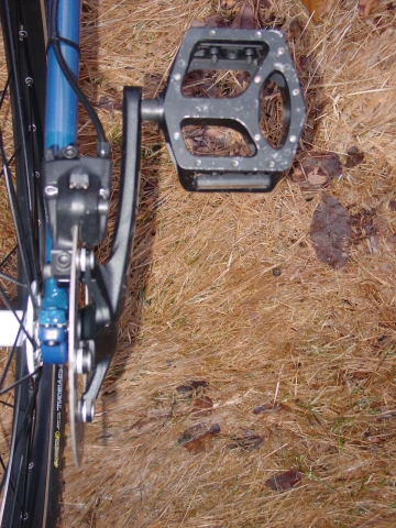

when we modified a cheap crank for the prototype and bolted on a 160mm 6 bolt rotor, the bolts were 1mm away from the bearing holders -too close. when we decided to use 104mm bcd cranks with 160mm rotors, the bcd was too close. we’re using 180mm rotor, and may also make a 203… but this is a drag brake. this rotor should work with all calipers, as it did with shimano. we need the feedback before we build every option. These are the most common usable standards out there. I’m glad you like the idea.

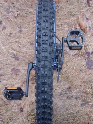

The disk is an inch closer to the leg because it’s outside the frame, but it’s unlikely to touch the leg while riding. if you rest your leg against it in an other circumstance, after taking it to sunday river… well the risk is your own. how many people have hurt themselves on a chainring while riding their bicycles? you should be fine… but that’s the feedback we’re after. the last discussion of brakes on a crank was the prototype for this.
We haven’t thought our way around the lack of a crank stop spacer, just spacers between the mount and caliper as the square taper wears, remove spacers… There is no extra metal to disperse heat on the disk, but the crank seems like a great heat sink. as far as Q, it’s the same as a chainring on a bicycle, conventional. Am… the seat and pedal seem to keep the disk away from the ground on crashes, however rocks could reach up and smack the disk, what can be bent can be unbent -kinda. I haven’t had to hammer it flat yet, or even bend it yet.

We’ll submit one for review! the cranks go on evenly, the part that holds the disk on is slightly outboard of the frame, yet still inboard of the person. hydraulic rim brakes are not light, if any weight penalty for a disk is a trade off for consistency if the rim isn’t perfectly true, the rim surface is beat, if the wheel is covered in whatever… smooth, predictable, reliable.

as far as the problem you guys are suggesting, look at your frames. the majority of all nicks and dings on mine are about 8" up from the axle… and the ones that are closer are very small and because i did something completely out of the ordinary. the pedal and crank are like a big guard for the majority of the disc, but i wouldn’t suggest crank grabs on that side.

Q is minimal, and the offset is also minimal since they’re bmx cranks.

I would imagine the disk getting damaged sooner or later in MUni crashes and needing to be replaced ($/hassle), and of more concern is not ankle rubbing during riding, but any part of your body coming into contact with the edge of the disc during crashes. I’ve experienced this myself with test bits and pieces - even safely rounded narrow plates etc turn can into knives during upd’s, slicing skin open. Not a fan of the outboard disc mounting, though there’s not a lot of choice probably atm.

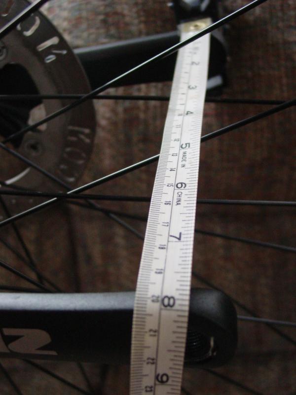

On a bicycle the q-factor is the distance between the pedals (or better the outside of the cranks at the pedal thread) parallel to the centerline. On unicycles the q-factor is the outward bend of the cranks. Right?
Can you please measure the distance between the pedals. It seams to be wider than other cranks.
Q should always be the distance between the pedals, but as the length of the axle is pretty constant on unicycles the main thing affecting the Q is the shape of the cranks. So people tend to refer to straight cranks as “having no Q factor” and offset cranks as “having more Q factor”, which is not really correct terminology, but people know what it means.
The bottom bracket axle on a bike is usually quite a bit narrower than a unicycle axle, and bike cranks have to angle outwards to clear the chain stays of the frame. So using bike cranks on a unicycle will result in a wider stance (higher Q) than the same cranks on a bike. Unicycle cranks tend to be straighter on average than bike ones for this reason.
Rob
Q
looks like 20.4cm how does that compare?
