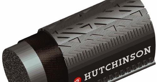

I should have asked about airless options, not solid rubber. Sorry bout that. I most likely made everyone think I had heavy in my mind. I was thinking of an internal lightweight foam, sort of solid, but light.

Sort of solid, but heavy. Way heavier than a traditional air filled tyre. Not only that, but poor rolling and poor shock absorption - because with an airless tyre like that only the material at the bottom of the wheel contributes to the suspension, whilst with an air filled tyre all of the air contributes. Foam cored solid bike tyres have been around since forever and they’ve never taken off because they’ve always been pretty rubbish. TBH there’s even less benefit to them now than there’s ever been, given advances in tubeless tyres which reduces the amount of punctures you get - I’ve been running tubeless tyres on my mountain bike for 15 years and in that time only had a couple of punctures where I needed to stop and remove the tyre (lots of punctures which the sealant stopped, probably lots I never even knew about). Though I’m still just running tubes on the unis as I don’t seem to get punctures on those (if I did I’d go tubeless).

I have a closed-cell foam tire. Correction; it’s an inner tube replacement, meant to be put inside a 20", BMX-sized tire. I think the major selling point was no flats. Of course it weighs quite a bit more than an inner tube plus some compressed air. I bought it because I was thinking of making a half-wheeled unicycle. It would be perfect for that. IUF founder Jack Halpern used to have a 1.5-wheel stack uni, with the half wheel on top. It was very interesting to ride, and quite a novelty! He brought it to the USA National Meet in 1982 and I was able to ride it, having learned to ride a ā€œnormalā€ 2-wheeler earlier that year.

Sheldon Brown: ā€œAirless tires have been obsolete for over a century, but crackpot ā€˜inventors’ keep trying to bring them back. They are heavy, slow, and give a harsh ride. They are also likely to cause wheel damage due to their poor cushioning ability. A pneumatic tire uses all of the air in the whole tube as a shock absorber, while foam-type ā€˜airless’ tires/tubes only use the air in the immediate area of impact. . . My advice is to avoid this long-obsolete system.ā€ Brown wrote that at least fifteen years ago, but I am certain it is no less true today.
