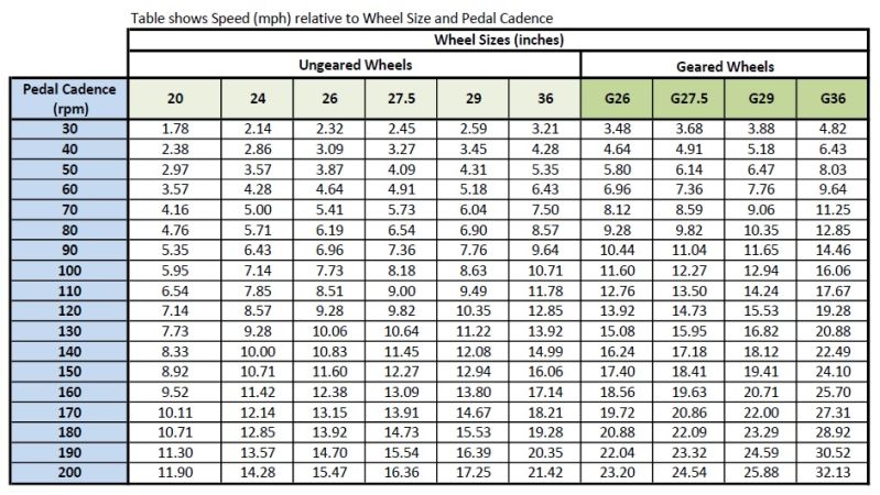

Sweet! Thanks Juggleaddict, that makes a lot of sense. And, being that I’m a huge nerd and proud of it, I couldn’t help myself from making a chart showing expected velocity based on wheel diameter and pedaling cadence. Feel free to check my math, I’m more of an arm waver than a details guy.
Based on the chart in my previous post, I can average about 70rpm over an entire ride, and my top speed of about 8 mph means that my maximum cadence is somewhere between 110 and 120.

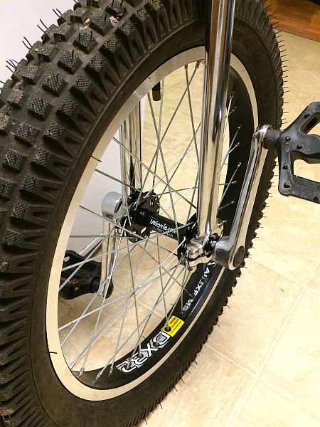

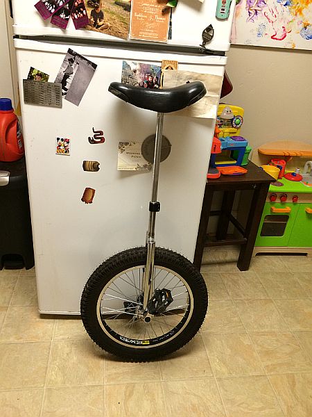

I recently purchased a no-name unicycle for sale locally. It had a bent hub, but the price was right and the rest of the parts were in great shape. I ended up completely disassembling the wheel and then rebuilding it around the basic UDC CroMo hub. It’s not quite a bulletproof trials uni, but it’ll be perfect for playing out front and focusing on some skills.
Here she is:
And here’s a close up of my new wheel:

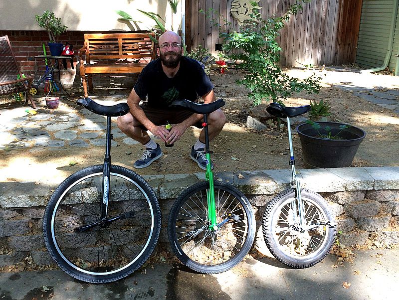

Here’s the family photo. Awwww… I just love sibling photos. These both have fairly distinct roles, so I don’t expect there to be much in the way of jealous rivalry.
Some impressions now that I’ve ridden the thing:
First off, I think a 20” unicycle set for a 6’2” guy looks kinda silly; I’ll probably end up lowering the seat a bit from what I have here, but I have to cut a couple more inches off the seatpost. Second off, the seat is significantly less than what I call “comfortable”, so I’ll probably be replacing that soon as well.
I was able to freemount and ride right away, but wow does it feel different from my 24”! I feel much closer to the ground, and the wheel feels like it’s not even there when I’m turning and maneuvering. The cranks are 5”, which is the same as what I have on my Club, but I find it’s easier to pedal at higher cadence with the smaller wheel, and this is great because lately I have been trying to increase and smooth out my cadence. Maybe it has to do the overall speed being a bit slower for a given cadence? I’m very curious to see if the faster cadence can translate back to my larger wheel.
Building the wheel was fun. This was my first wheel build, and it took me a few tries to get it laced up correctly, but once I got the pattern sorted out everything went smoothly. I didn’t hear any pops or pings during my first ride, and everything has stayed straight and true so far.
Yay! That is awesome! I have a feeling your family is going to continue to grow :slight_smile: I’ve been practicing on my 20" here and there. It feels so different. The guy who sold it to me was quite tall, so I was surprised to find that I feel very comfortable on it. I have a feeling the saddles are supposed to be a bit lower. But, that makes my knees crazy, so for now, I’m leaving mine as is. Good for you for your first wheel build. Have fun!
So, you haven’t removed any length from the seat-post? You said you’ve practiced idling, but can you ride forward with the seat at its current height? If so, your seat height might be okay.
My own seat-height ended up being way higher than I initially thought was possible. A few weeks ago, I experimented with lowering the seat a bit on my mUni, and I hated it. So, in my experience, once I got used to a higher seat, I didn’t like going back. My technique changed, however, to accommodate the increased seat height. My hips flex more at the bottom of each pedal stroke, and it feels more like I’m reaching for the pedals at the 6 and 12 o’clock positions. The position of my feet on the pedals has shifted more toward the toes (which has helped a lot with control). I use plastic pedals on my 20" which are pretty easy to adjust the foot on.
