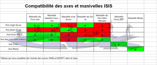

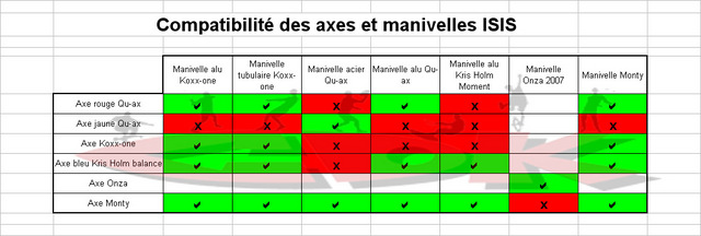

Maybe my brain’s slowing down as I get older (:p), but I can’t seem to make sense of all the threads about ISIS compatibilities and incompatibilities. (See attached images, from here…if you’re French.) Some cranks work on all hubs, while others only work on certain hubs, and some setups are masquerading as ISIS but completely incompatible. I heard that some have changed since the initial flurry of testing, too. It’s just too much for me to sort through. So, instead, a simplified question:
Given a KH Moment hub, what 170mm and/or 175mm cranks will fit? Bicycle cranks inclusive. (and have you tried them yourself?)
That chart doesn’t show. It lists KH Moment cranks, & KH Balance hubs.
The KH website shows Moment crank & hubs, but not Balance, so I’m not
sure what that means. Anyway those KH hubs were compatible with all
ISIS cranks in the chart except Qu-ax, and were the most compatible of
the hubs in the chart.

According to the table on unicycle.co.uk, the KH, Qu-AX and Onza hubs are ISIS, so you can swap round the cranks between them, the koxx hubs & cranks aren’t really ISIS, so you can’t use them with any others.

yep. theoretically any ISIS crank will work on any ISIS hub. not always the case but close. in fact the KH/koxx incompatibility is the only one i know of with ISIS stuff. everything else i’ve ever heard of works together. that’s the point of standards.
yer basically, everyone got it right except koxx
Koxx should just stop calling their crankset “ISIS”. Doing so is a violation of the ISIS-license.
I really don’t understand why at least the shops stop calling them ISIS? They cause confusion with that and knowingly do false advertising. Next time I sell a car I will advertise it as a “Porsche (note that this is not actually a Porsche, its a Renault, but I just call it this way cause it looks better)”.
I think they should call it the “specialkoxxcrankstandardthatisincompatiblewitheverythingcausekoxxistoostupidtobuildaproperisiscrankset” .
