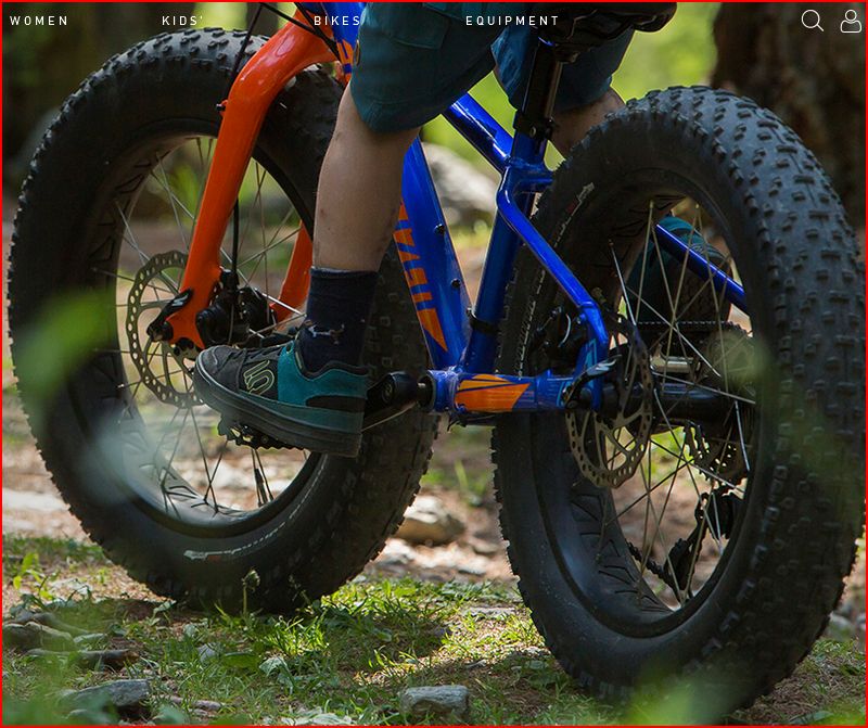

The tire was made for the kids Fatboy 20, which appears to be a high-spec miniature fatbike. The tire is available for $40 USD

My daughter rides the Fatboy 20 pictured above so if you need any measurements, please let me know.

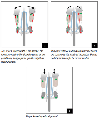

Here is a good image from issi pedals that shows why pretty well:
Looks like this is the same as the club(UK) version.
Oh, that is good to know. I somehow missed that they used 100mm too.
