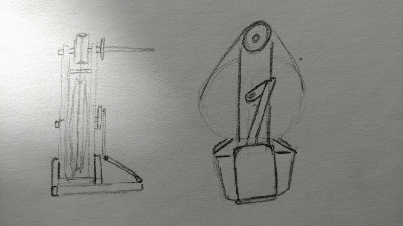

I’m certainly interested in seeing what you have done. My first thoughts were to make an open spindle wheel with the spindle above the wheel, and a single treadle in front.
Something like this drawing if you can understand it:
Historically, spindle wheels have tended not to have treadles. I don’t know how much you know about spinning, so excuse me if I am telling you stuff you already know, but the other mechanically inclined readers of the thread will probably be interested. There is a good reason for this - a spindle spinner, like a unicyclist, needs to be able to slow down, stop and temporarily reverse direction frequently while spinning. You spin a length of yarn as long as you can reach back, then you reverse the spin to unwind the bit at the tip of the spindle, then you forward it to wind the spun yarn onto the ‘cop’ or ball of yarn forming at the back of the spindle. A treadle makes that much harder than simply turning the wheel by hand. Treadles come into their own once you put a flyer on the wheel - a flyer being a brilliant mechanism that automatically winds on the yarn as it is spun. So spinning becomes a continuous, fast, regular process, and speeding up the wheel and freeing the hand by adding a treadle makes perfect sense. It is possible to learn to use a treadled spindle wheel - Rachel Brown’s Río Grande wheel being the best known example - but it isn’t easy.

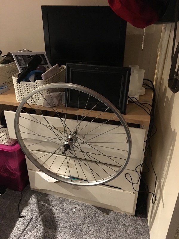

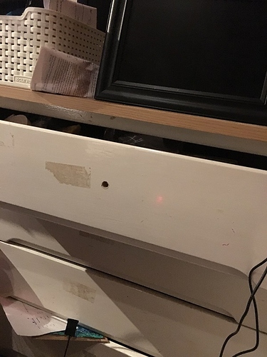

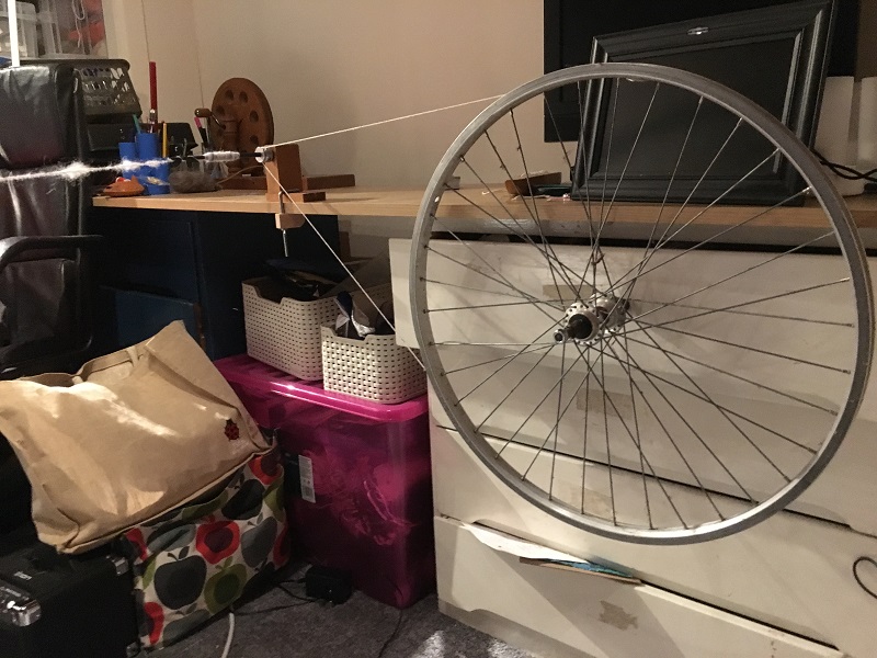

I’ve set my wheel up again for the first time in some years, so that I can video it in use. It used a spindle assembly from a small Charkha style wheel which I already owned. I used an old bike front wheel and was inspired by Faroese wheel which were built directly into the wall of the house and mounted it on an existing chest of drawers by the simple method of drilling a hole in the drawer front for the axle and attaching it with the existing nut. The tension adjustment is simply by sliding the clamp for the spindle assembly along the desk. I am very bad at fiddling with photos etc on this forum so it might take me a while to get them to work!
If I was starting with unicycle parts, I think I would get a large base plank and take the seat off the seat post. Then screw the seat post down to the base plank. Then mount the frame and wheel upside down (without tyre) onto the upside down seat post. I would put a smooth peg on the near side pedal crank and use that as a crank handle. Then I would mount the spindle assembly on another seatpost and frame further along the baseboard, preferably with some slide mechanism to adjust tension.
Here are the stills of the equipment.
Video of it in action.

Thanks for the video, I’ve never seen that style of spinning wheel before, and was having trouble visualizing how it would work in jtrops’s sketch.
