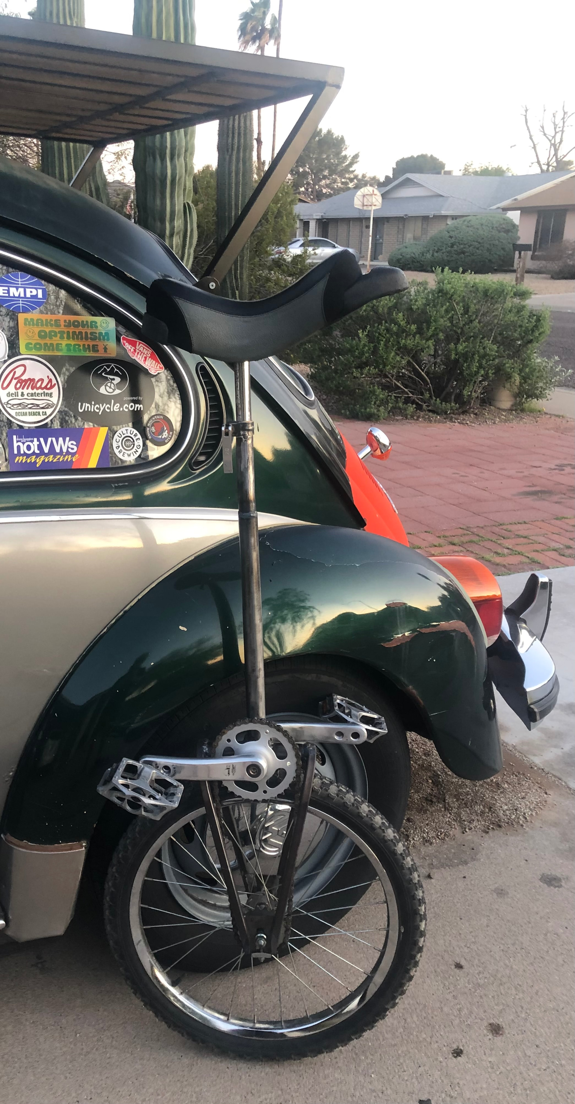

Penguins are fun. I built this one two years ago from scrap metal as an experiment. Shortest possible 20er giraffe unless I were to start cutting into the bb shell. In that picture it’s geared 32:20 making it into a 32er ratio wise. I later built a wheel for it with a 6 bolt 16tooth cog which makes it ride like a 40”. It has a chainring or cog eccentricity that makes it rather unpleasant to ride with the constant fluctuations in backlash. For that reason it sits in my closet until I feel like messing with it again. I have a couple clips of me riding it when it was 32:20 and a couple clips of some cal poly unicycle club members riding it as 32:16 although I’d have to figure out how to get them formatted in a way that the forum will allow me to upload.

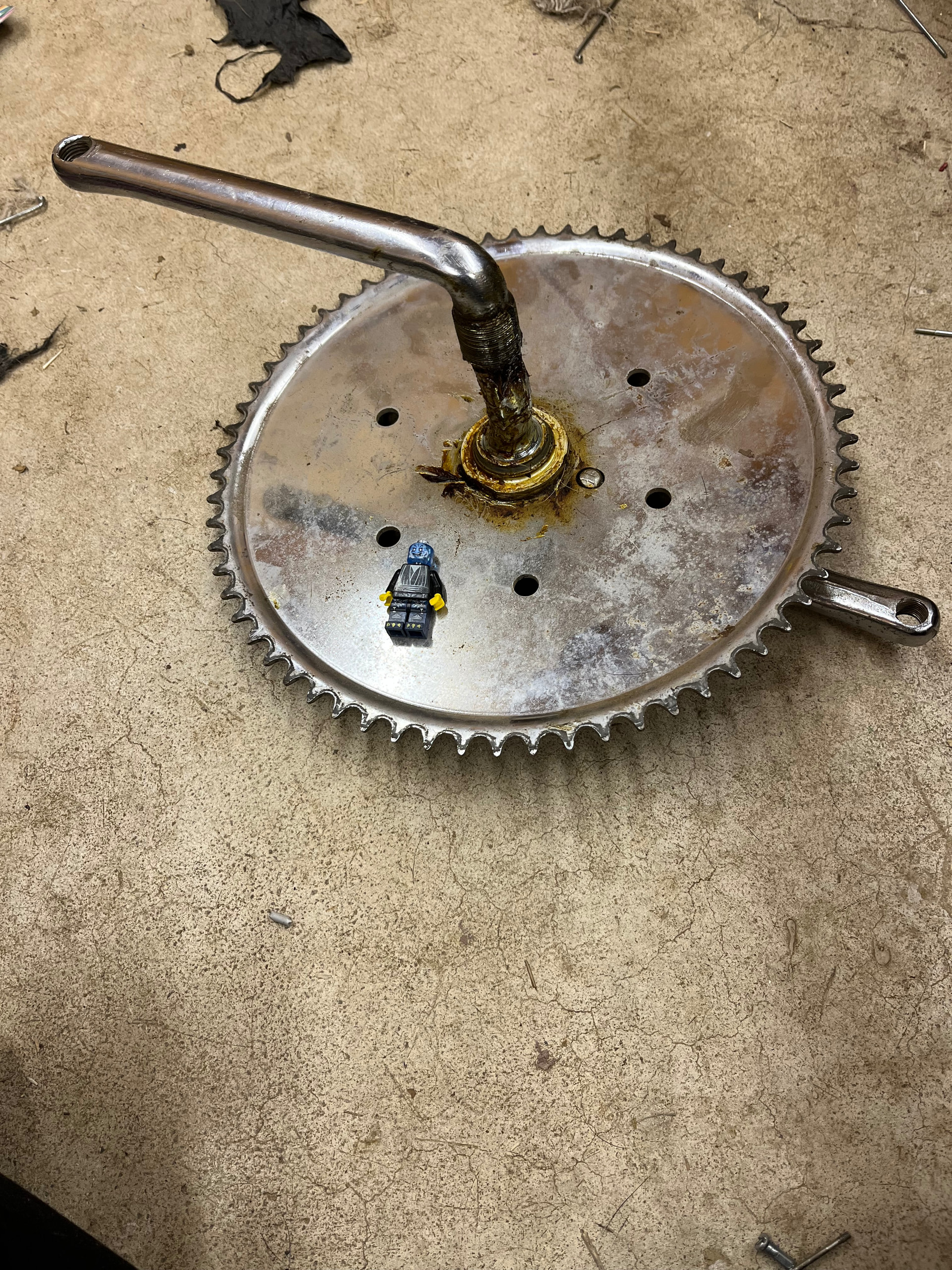

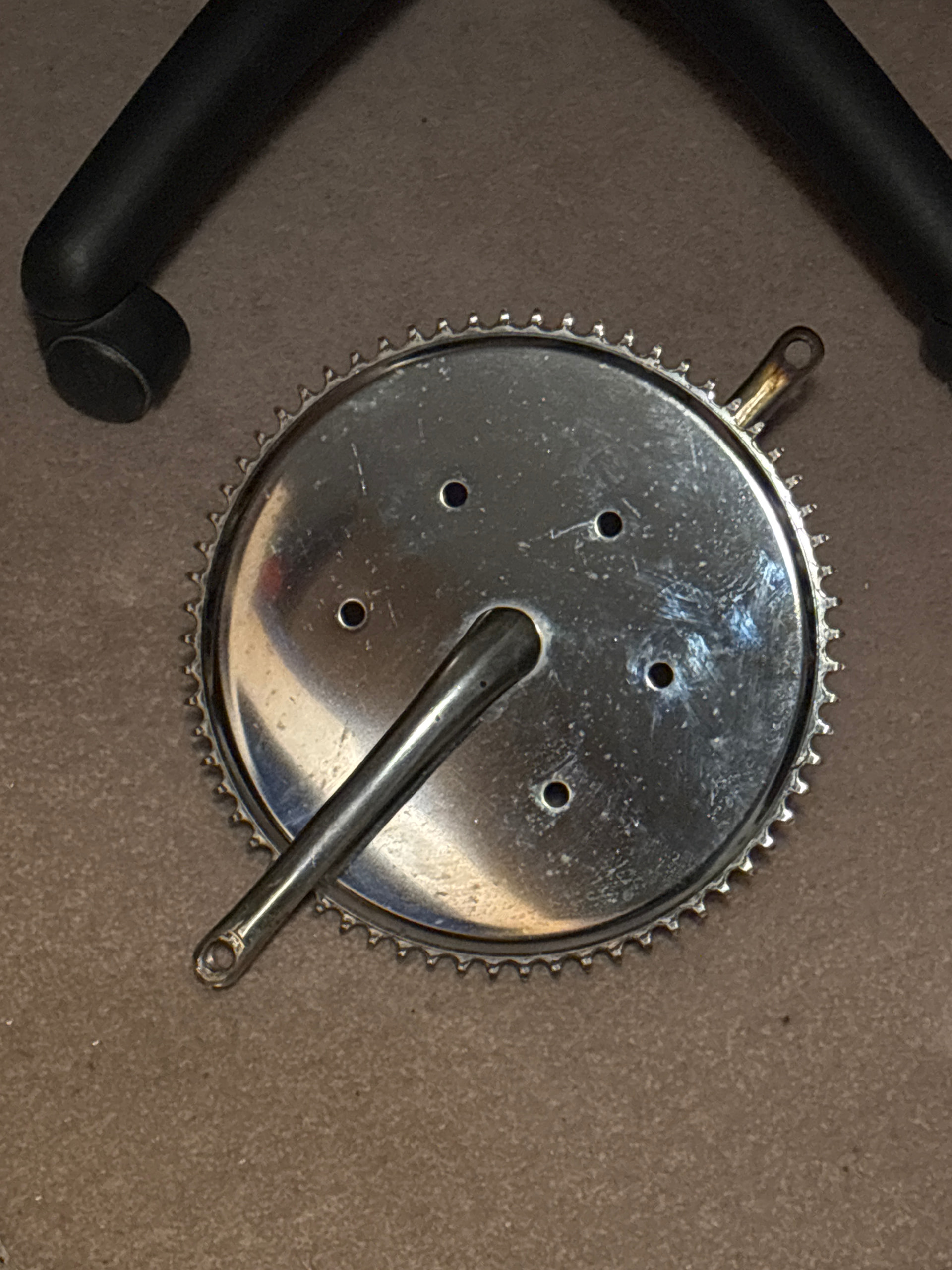

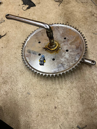

I want to make my own 12” penguin with this bad boy
I love these big chrome dinner plates. I’m not sure if I’ll do a 12” giraffe or a small tall b*ke. An 11” 65t chainring would look funny with a 12” wheel in either case.
They’re about the same size and I want to pair it with a 15tooth cog to gear it up to a 52”

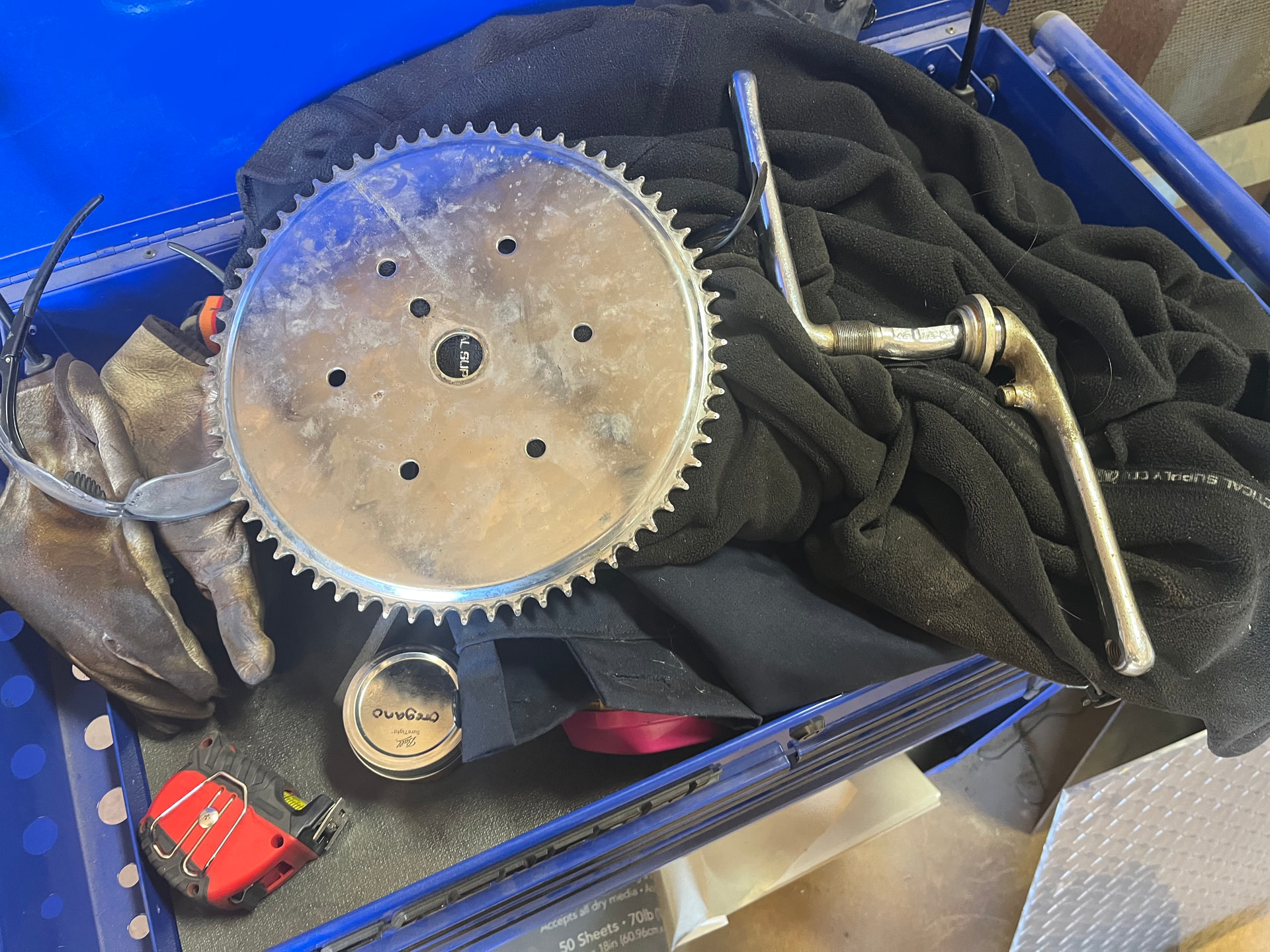

Took a lot of work to do it but I got the chainring off of the cranks
