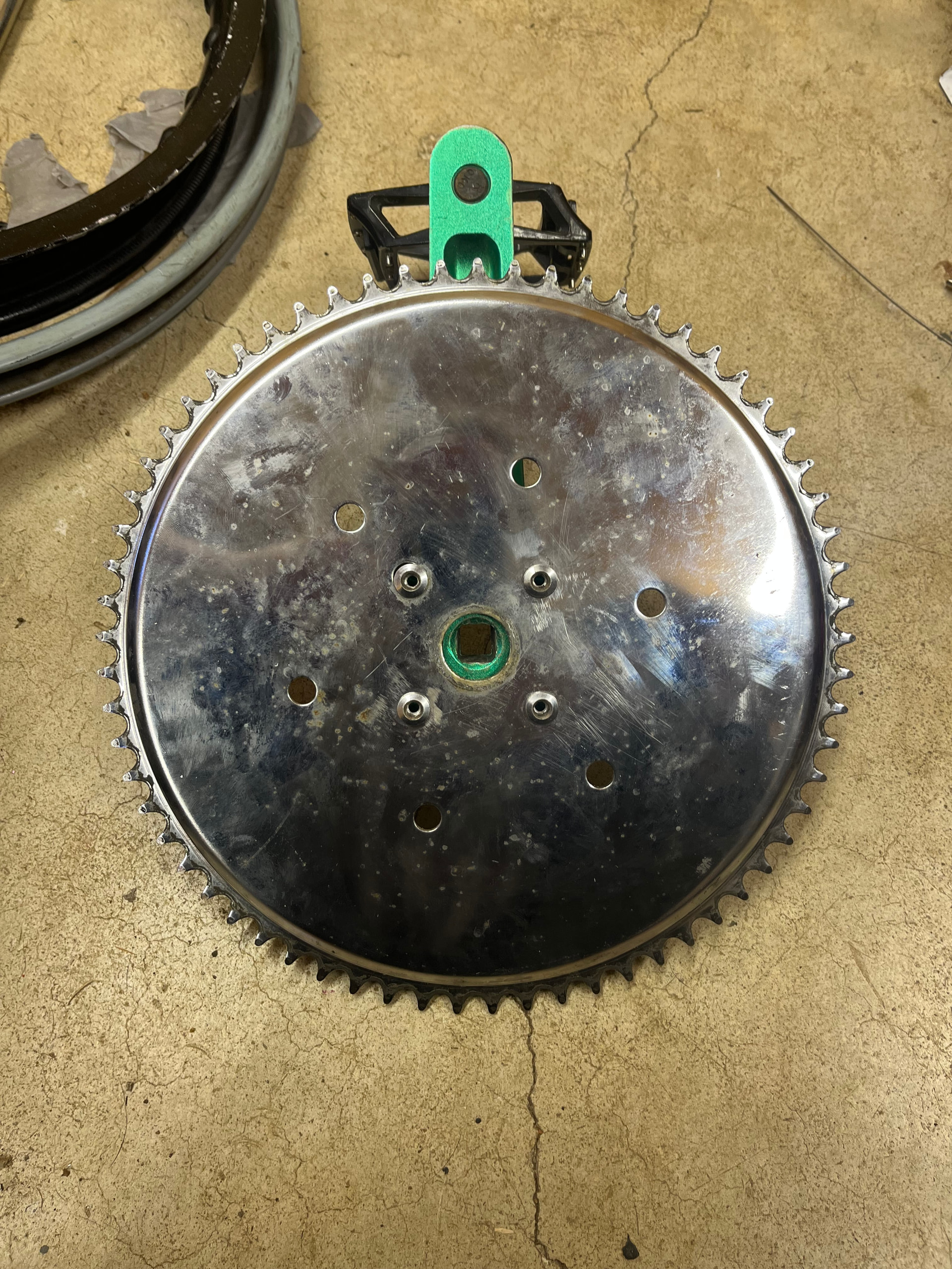

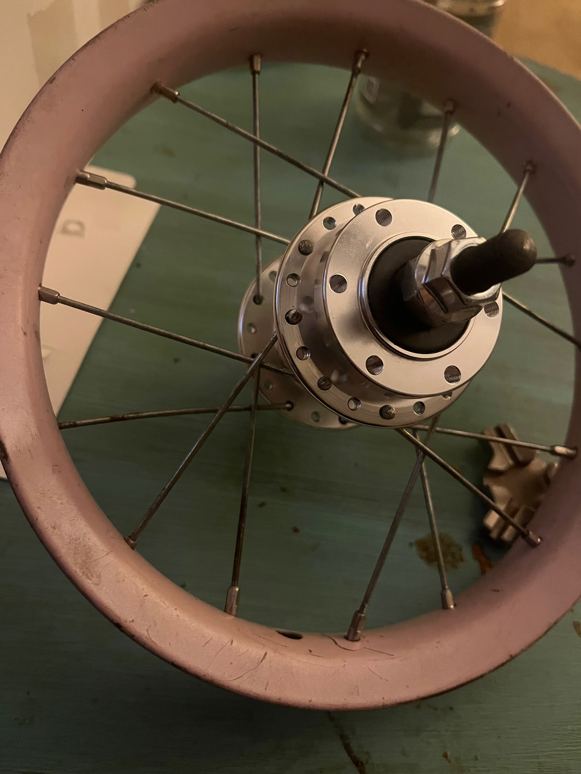

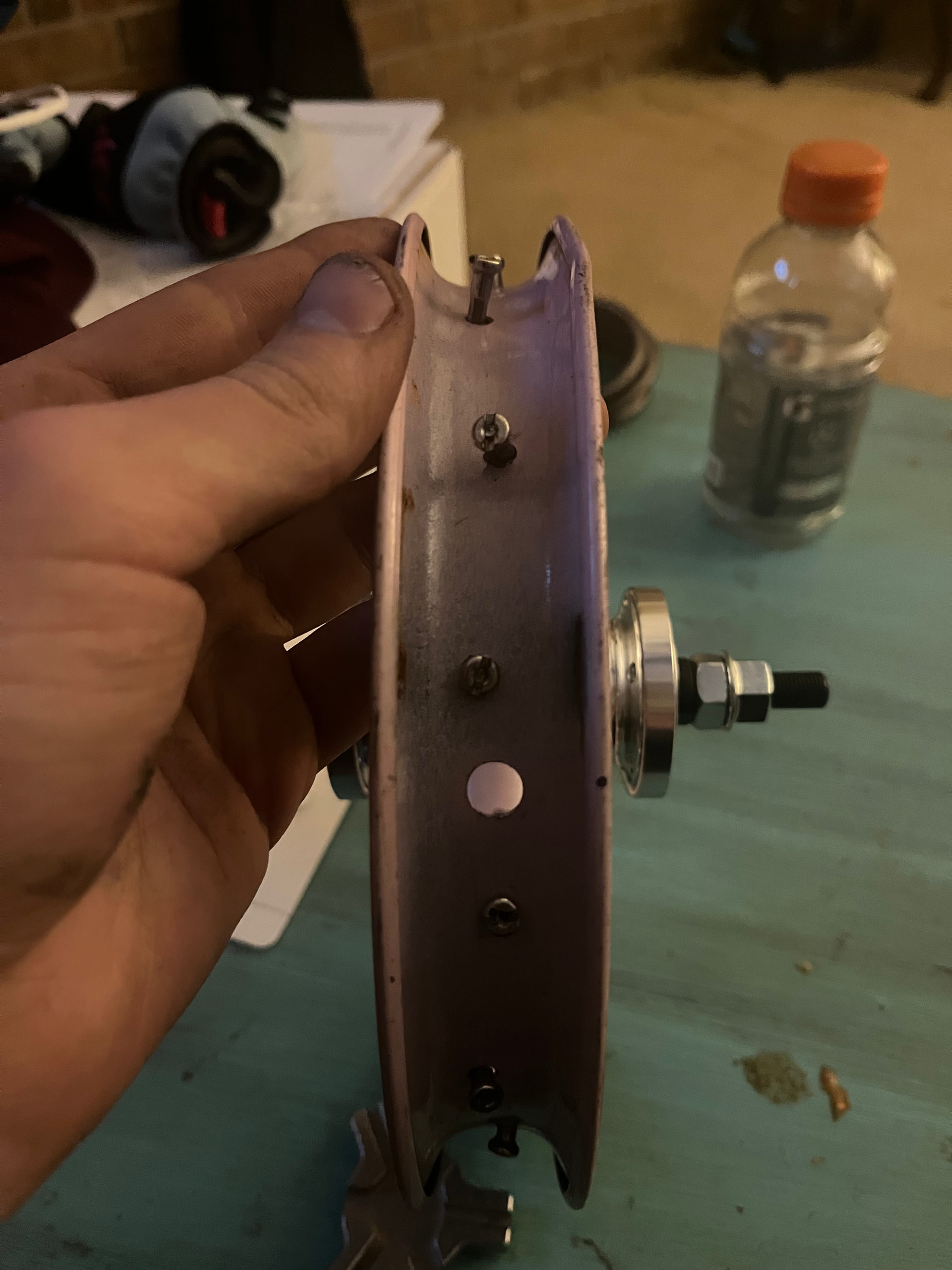

My 15 tooth cog arrived today, I’m going to drill out holes for a 6bolt brake and I laced up my 12” wheel to my new giraffe hub but some of the spokes are long and due to a 16 hole rim and 36 hole hub I had to make a weird pattern so I don’t know how to measure the length
Are you actually planning on having different sized sprockets on both side of the hub or a brake rotor on one? If not you could get a 32h disc brake bike hub and have an even lacing pattern. Or you could probably get a disc brake scooter wheel in that size although you’d have to check how the width compares for chain line.
I’m interested to see how this goes as I’ve toyed with the idea of a 12” giraffe before. I’d definitely like to see how you’ll go about modifying that 15t cog to fit and how close the chain clears the hub. I have a clown bike with a 16t 6 bolt cog and I wouldn’t mind a little more speed from it
This thing is going to be 52 gear inches so yes I had planned on a brake on the other side. I might just suck it up and buy a spoke threader
Oh duh. I thought about how high that ratio was and then forgot when I asked you if we’re putting a brake on it.
You seem like someone who would benefit from owning such a tool. I’ve been meaning to buy one myself for some time now.
I know right? They’re so expensive but I guess you could definitely make your moneys worth from it

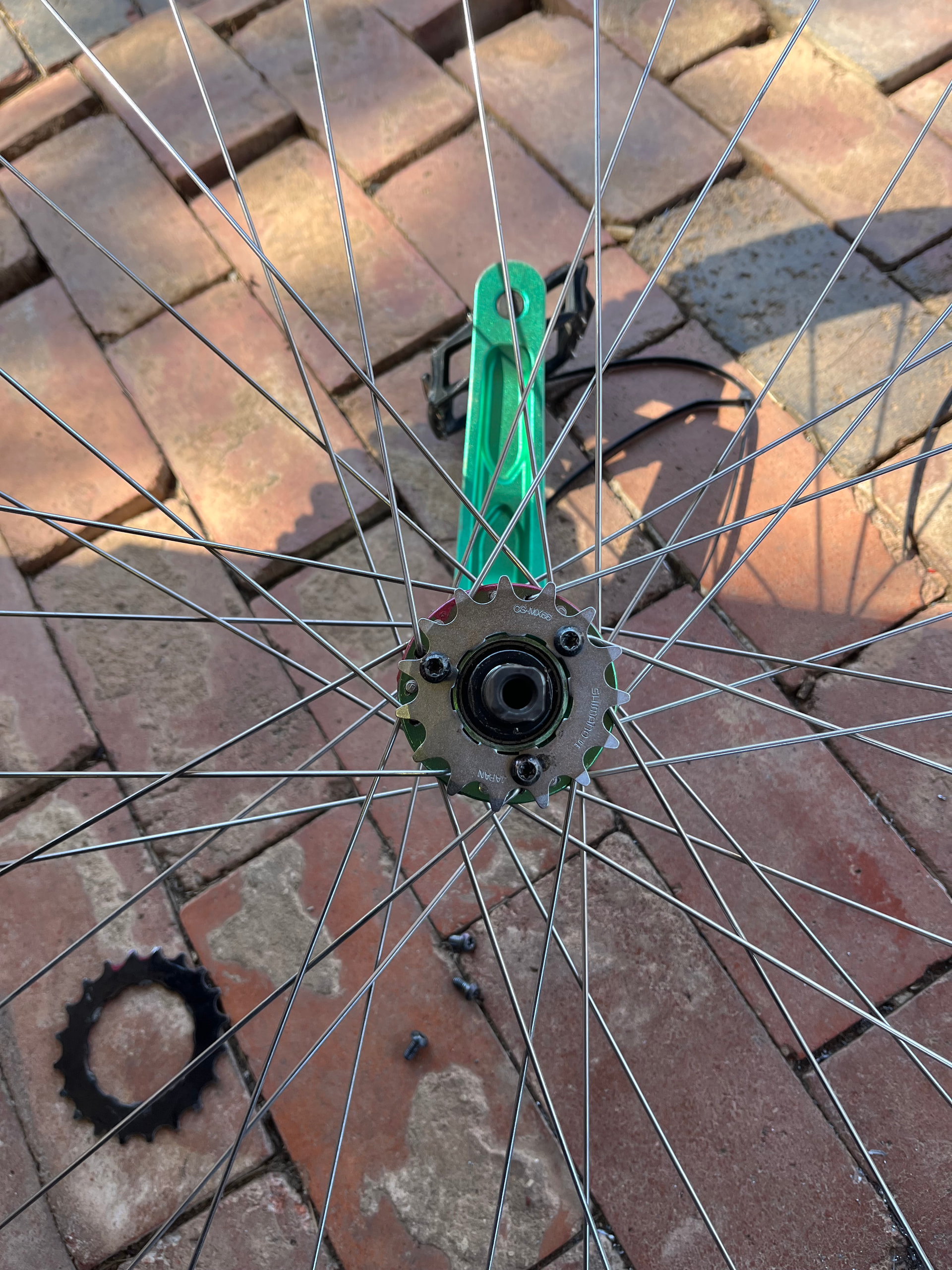

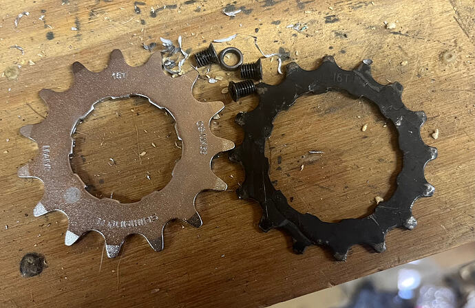

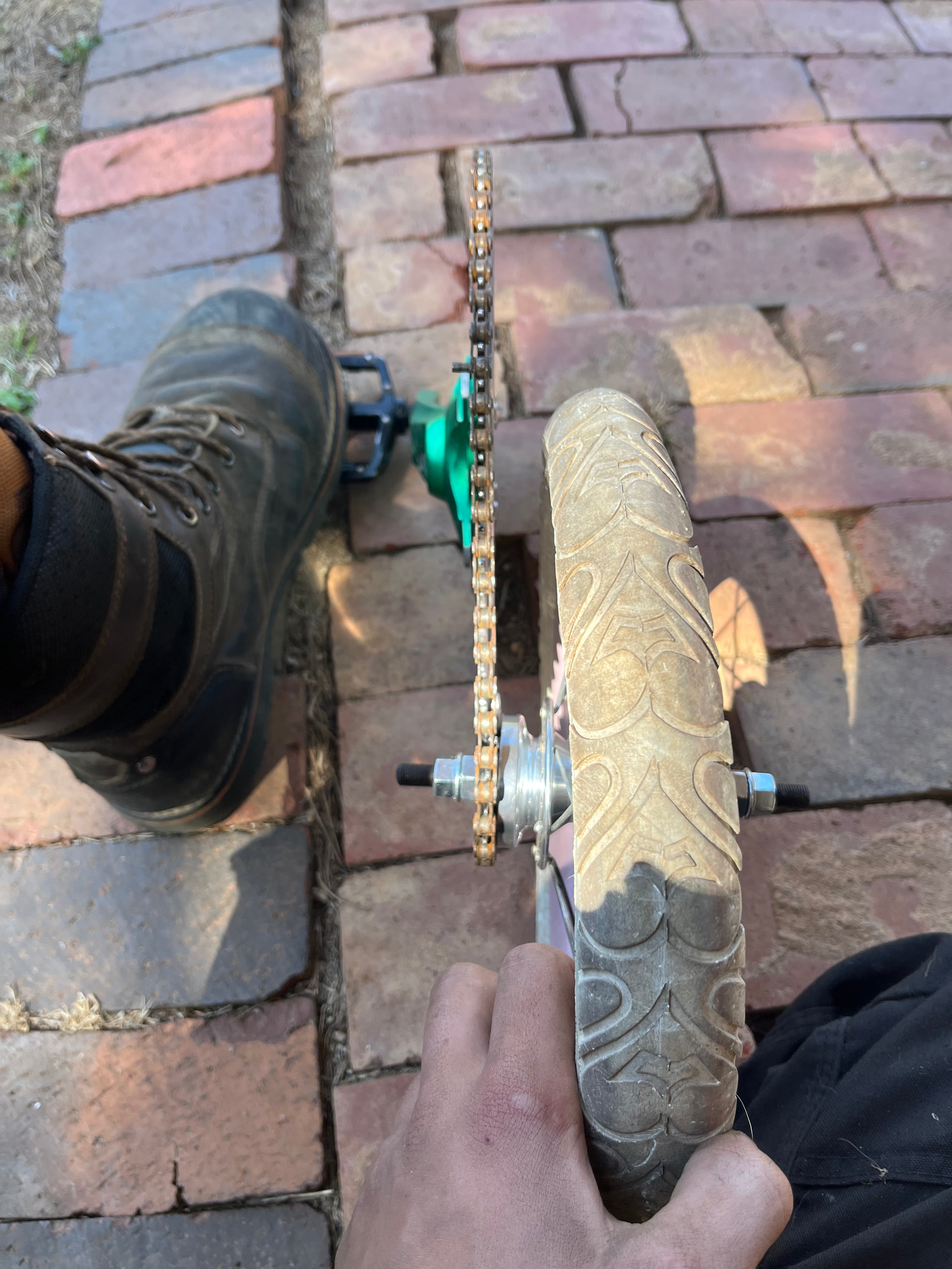

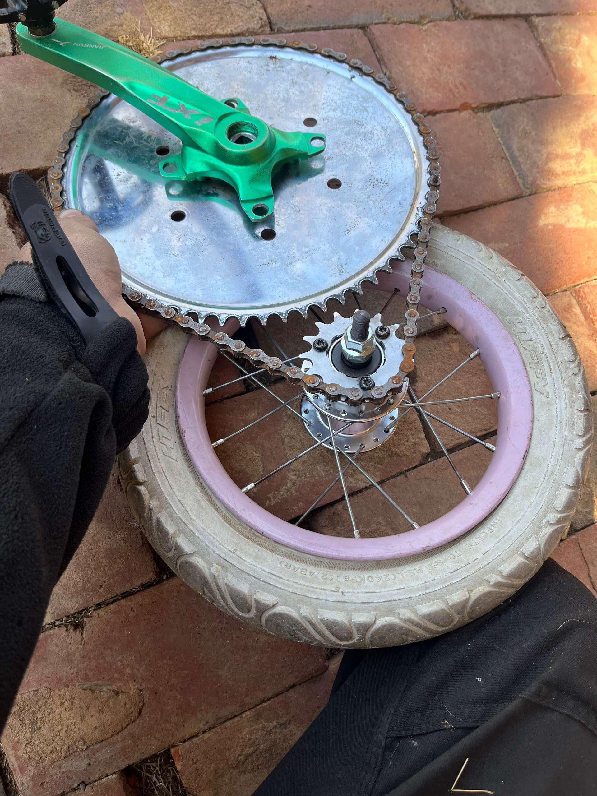

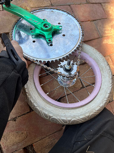

Finished drilling the 15 tooth cog, the frame on this is going to be so weird
How does it all fit together. Do those splines clear the shoulder of the hub? Any issues with the chain hitting the hub or the bolts?
A 15 tooth cog is just slightly larger than a brake flange but a 14 is too small (I think) otherwise no issues with Chan collisions. As for the splines no they don’t clear the weird raised spot. Whether I grind down the hub or the splines is up for debate, I’d love to remove the splines but the temper on the cog makes it a nightmare to remove any material unless you change it by force
Perhaps a lathe, if you have one available, or know someone with one? Hardened steel can probably be cut down with carbide tools? If you have coolant spray, you can keep the temperature from getting too hot.

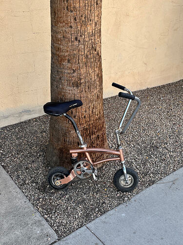

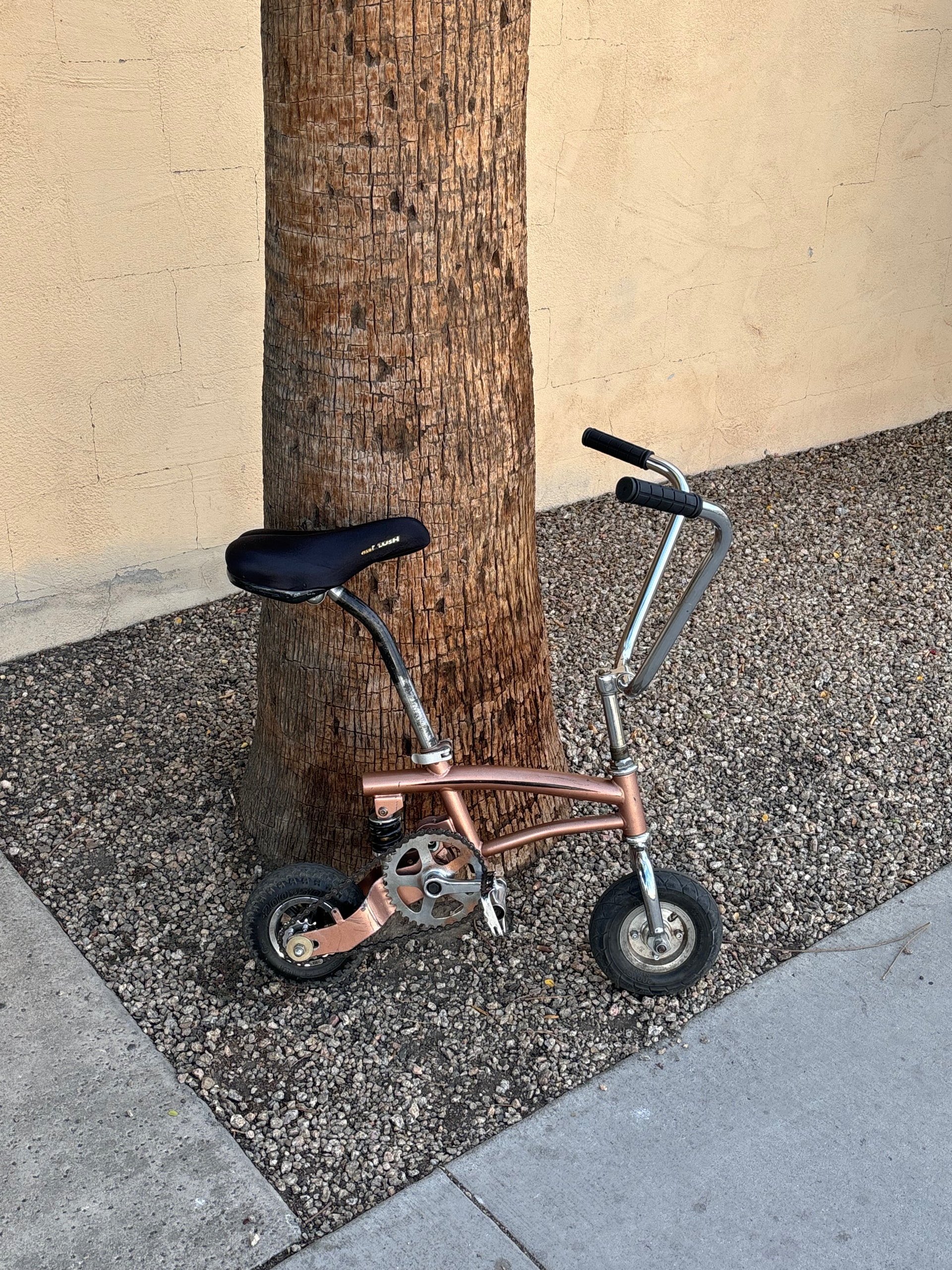

Have you thought of making it something like a 6" wheel? It would be the only way to make one
If a 6” pneumatic wheel exists I have another idea I might use it on, but for now a 12” giraffe is as small as I’m willing get
6” pneumatic scooter wheels do exist although I’m not sure you could find anything with means to bolt a sprocket on without modifying it. 8” pneumatic wheels can be had with a 6 bolt pattern on them. 8” is what’s on my clown bike pictured in a previous reply
