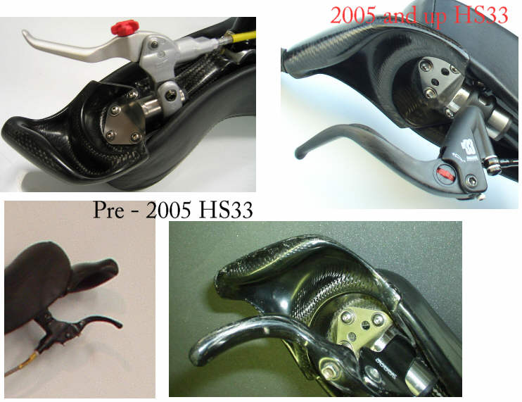

I make curved carbon fiber/Kevlar levers for Magura HS33 brakes. They come in RH and LH curves, and both the pre ’05 and the new versions. The attached photos of the older style curved lever aren’t very clear but that is all I could find at the moment. The red TPA knob is missing in the photos. I sell the levers for $30 each. I also have new stock Magura aluminum 2005 style levers that I swapped out, and I will sell those for $14 each.
As Dan said, the new style HS33s have the pinch bolt in an awkward location for unicycle use, but you can rotate the lever assembly to the side to access the bolt, then tighten it but not so tight that you can’t rotate the lever assembly. Then just move it into position. This is the amount of tightness you should use anyway because it will prevent most lever and actuator breakages. The lever will be able to rotate on impact and absorb some of the force against the lever. The type of mount you have will have an effect on how well this works. If it is painted steel, or bare aluminum, you may have trouble with it grabbing the paint or galling the aluminum. Sanding the inner surface of the clamp and removing sharp edges may help, and even some lubrication may be a good idea. If you remove all of the paint from a steel mount tube it should work perfectly as long as you keep it from rusting somehow. I make my brake mounts from stainless steel in large part because of the ability to smoothly rotate the lever assembly on it.
The new style actuators are more vulnerable because they hang down farther, and they have a weaker mount as Dan said. That makes it even more important for the lever to be able to rotate on the mount tube when hit.
