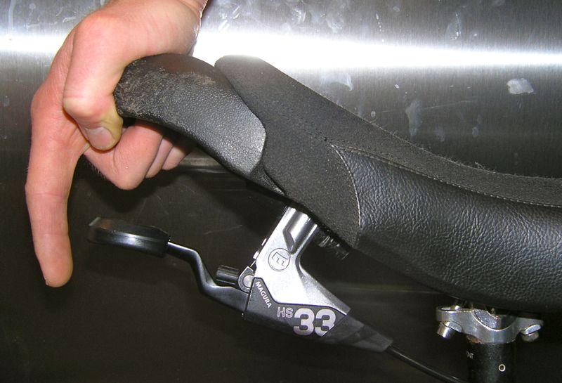

Ride test and more photos

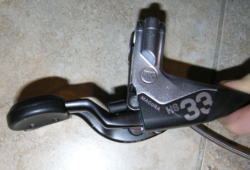

I tried it out on a short ride and was frustrated by the reach that the lever blade required. Even with the lever blade adjustment allen key turned all the way out, it was still a stretch for me to reach the lever blade tip with size XL hands with the lever mounted on a KH rail adaptor. I know that the 2 finger blade will bring the lever a little closer, but theres this bit:
Without your fingers on the blade the lever flops around up and down against its too tiny preload spring" more than I’d like when you go over bumps and drops, you can hear and feel it “clapping around” down there. I’ll post some video here soon that shows this. The TPA adjuster on both of the 2011 brakes I got would only turn a couple of turns in each direction before it binds up under all my finger strength. Also the TPA twist lever is really small and can’t really be accessed while riding like the 2004 TPA could be.
I guess I could live with the ineffective TPA, but that lame spring loaded lever blade positioner really bugs me. . . . . I might change my mind later, but this lever was not designed with unicycles in mind and since I like to ride with the lever blade closer to the saddle, I guess this is a miss for me and likely other riders with small hands. I haven’t given up yet . . .I’m gonna get a couple of the shorter 2-finger lever blades and see how they feel before I give up on this.

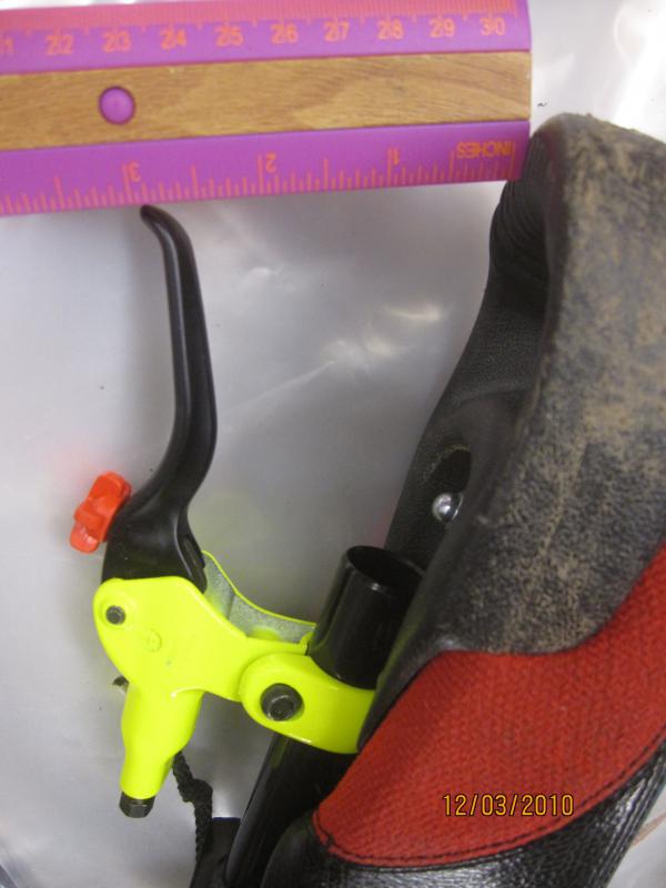

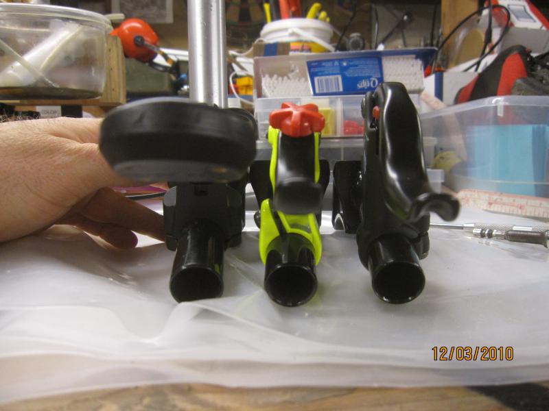

I got back home and took the saddle off to do some comparisons to the older HS33 levers with the lever blade position allen keys adjusted to place the lever close to the saddle. This is what I found when I measured the reach to the lever:

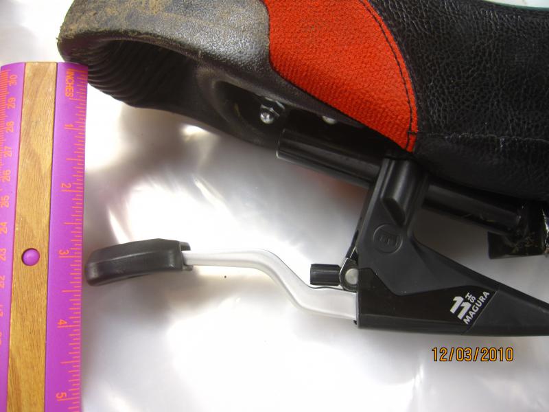

The reach to the lever, in the position I personally like, does not feel different in my opinion than the 2010 if the 2011 lever is adjusted to the closest position. Attached is a photo of the brake installed, and in comparison to the 2010 HS33. That said, it’s true that the 2010 lever adjuster has greater adjustment closer to the handle, compared to the 2011.
The 2011 brake lever is actually closer to the handle than the earliest Magura HS33 lever (early 2000’s) (the one with the red knob and solid forged brake lever).
Definitely I’d go for the shorter lever version on the HS33.
Sometime in future I’ll probably change the angle on the brake lever bracket so it moves the lever closer to the handle (e.g. so the lever position adjuster is more in the middle of it’s range). That won’t happen for a while though.
So in sum, IMO the 2011 version are still very nice brakes. So too are the 2010, and earlier versions as well - they are all good and no huge reason to prefer one over the other for use on a uni.
